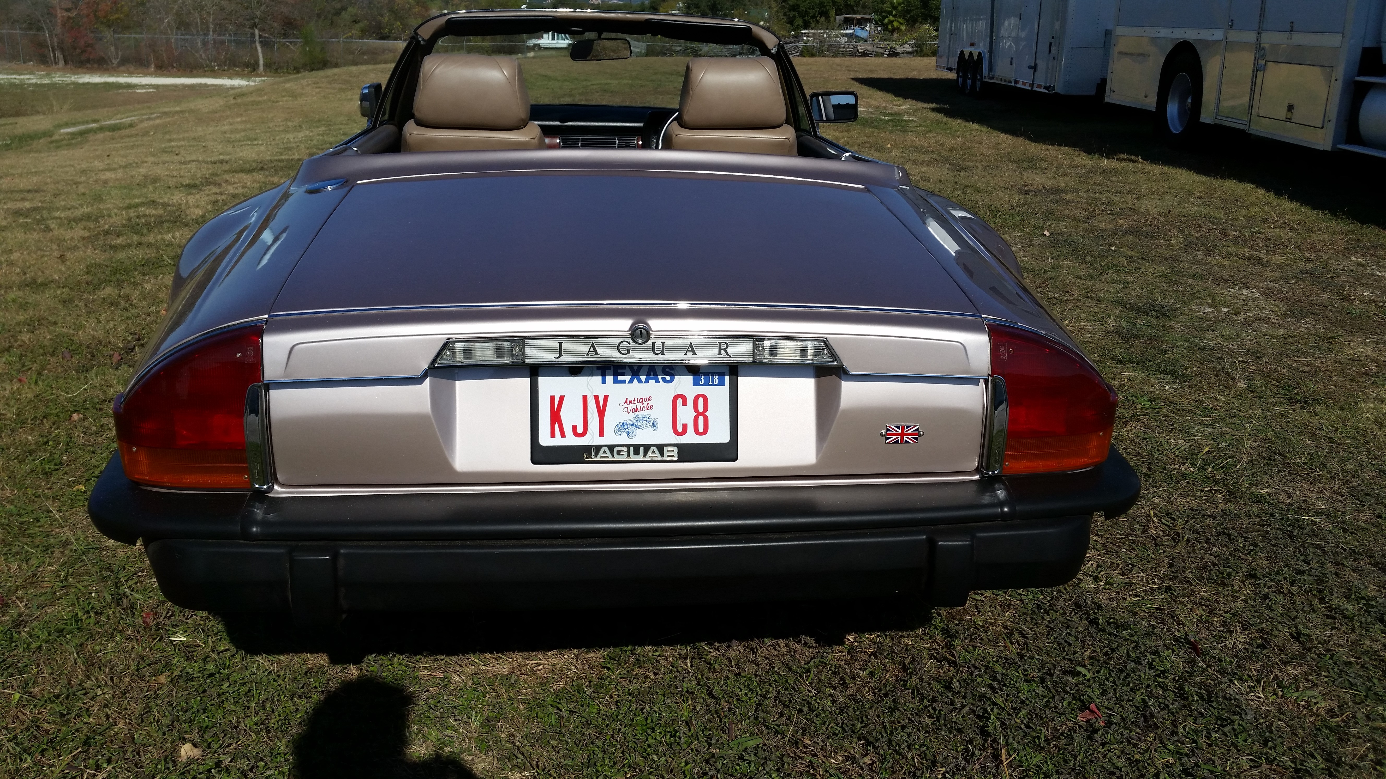

what Vehicle and year is that

pic 1978 Jaguar XJS coupe converted to roadster by Aston Martin coach works , around 1980/81 ish.
