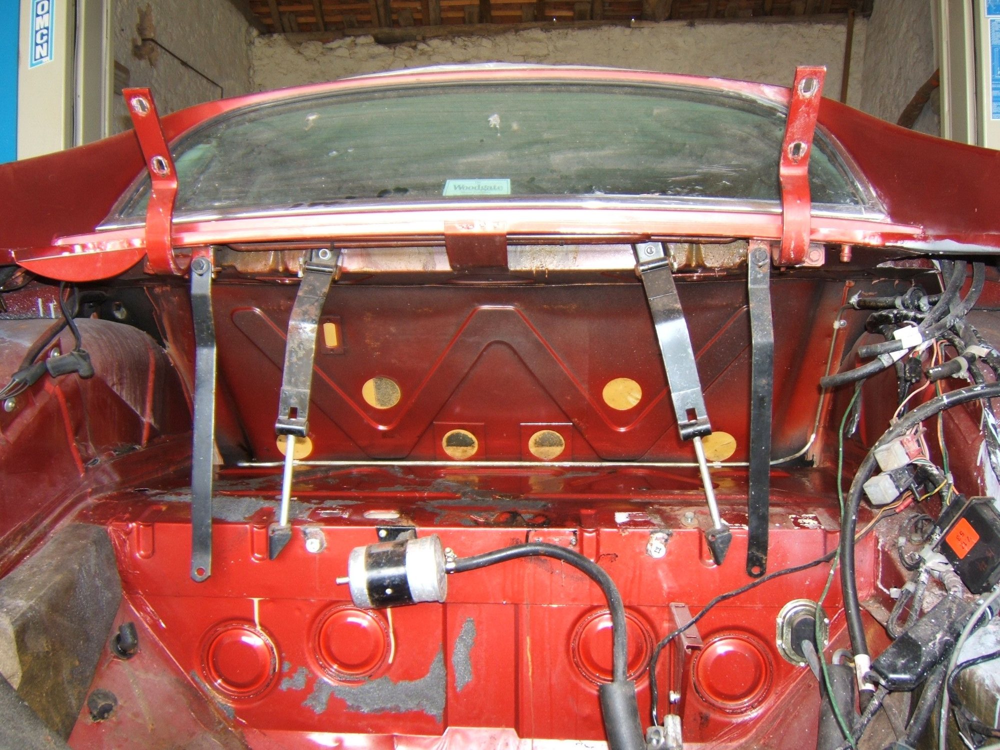

The fuel tank air breathing line goes from the top RHS of the tank, on UK models via vapour cannister and a two way Rochester valve, through a very thin steel pipe along the back bottom of the tank and out in front of the LSH rear wheel where (on your model) it joins a pipe to the vapour charcoal thingy at the front.
The thin pipe along the back of the tank gets blocked, and if your model has a Rochester valve, that stops working too. If the front stuff is Ok, or at least the line from the tank is disconnected at the front, I would test the metal pipe by disconnecting the pipe where the join is in front of the rear wheel, and investigating what is there at the top RHS of the tank.
This is a pic of the pipe in question along the back bottom of the tank shelf:
You can see it rising up on the RHS to the flexible pipe from the tank and the Rochester valve.
