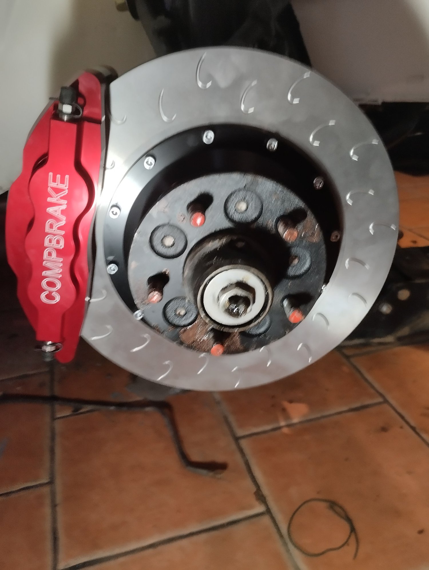

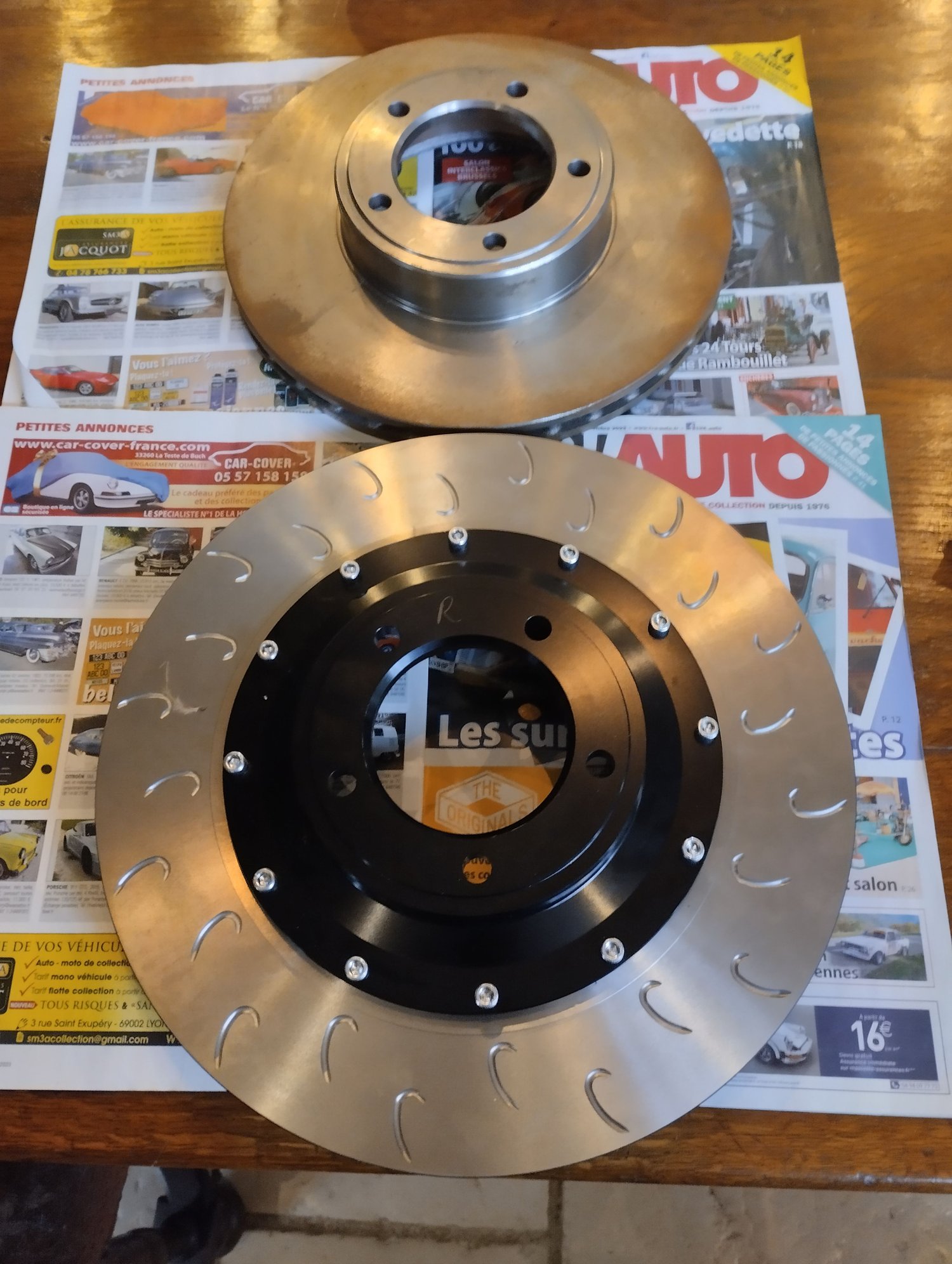

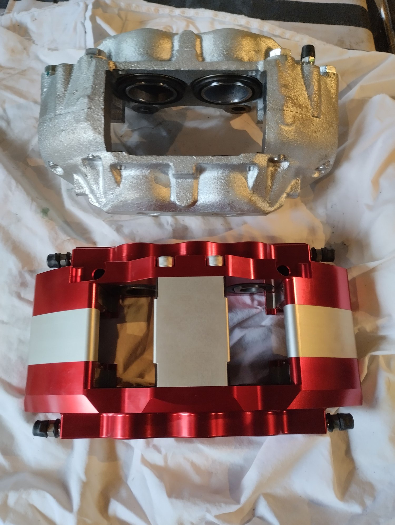

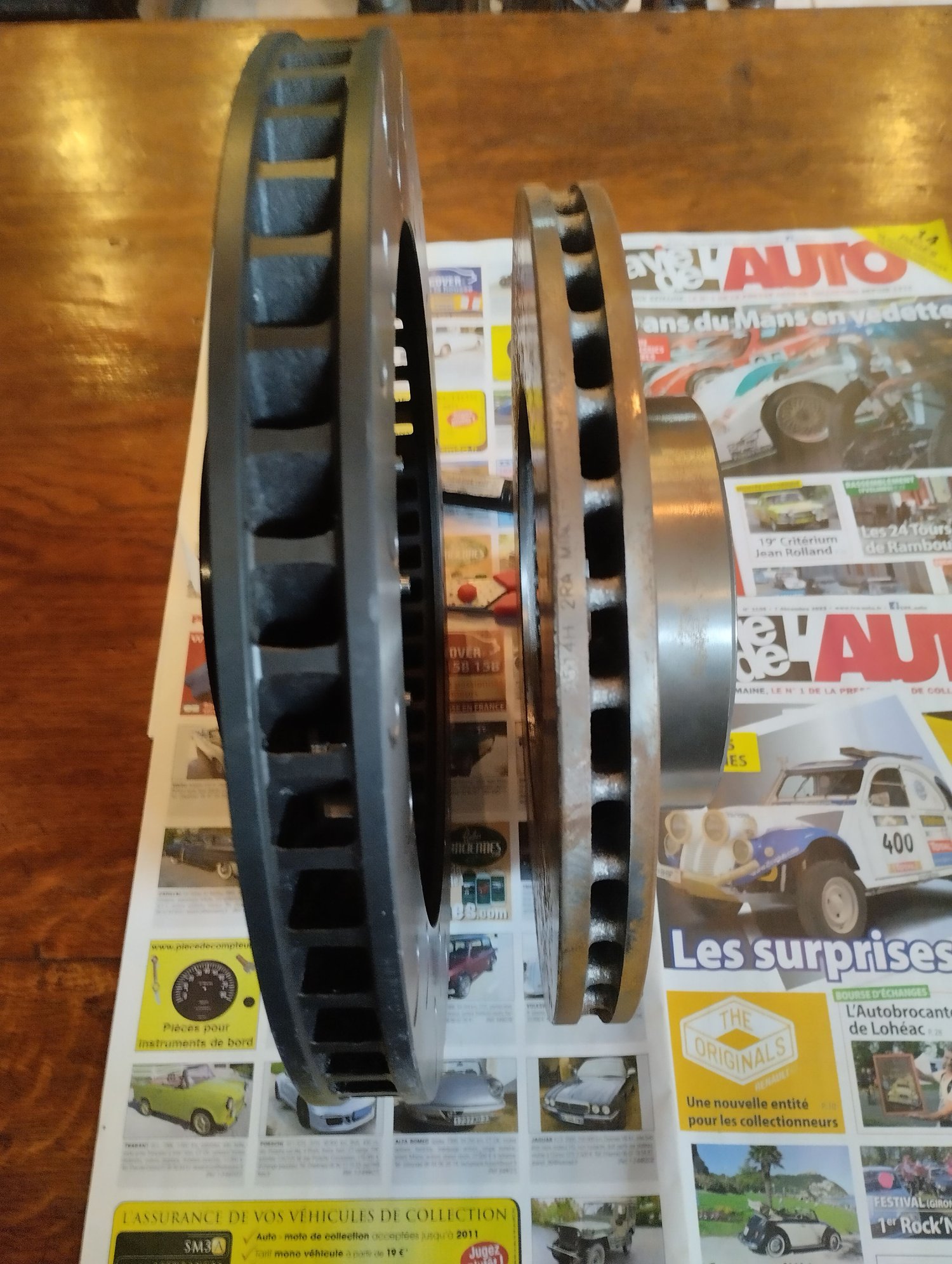

Old Feb 11, 2024 | 04:45 AM
Scd's Avatar
Scd
Joined: Apr 2022
Posts: 70
Likes: 84
From: Pays de la Loire, France
Just starting to fit the Compbrake Kit, have to say very impressed with the quality and engineering, the separate mounting bracket for the calipers makes shimming the steering control arm a piece of cake! On my bathroom scales looks like an overall reduction of 5 kgs per side and 16 inch TWR wheels fit no problem, will try a later style xjs 5 spoke 16 inch and report back.
