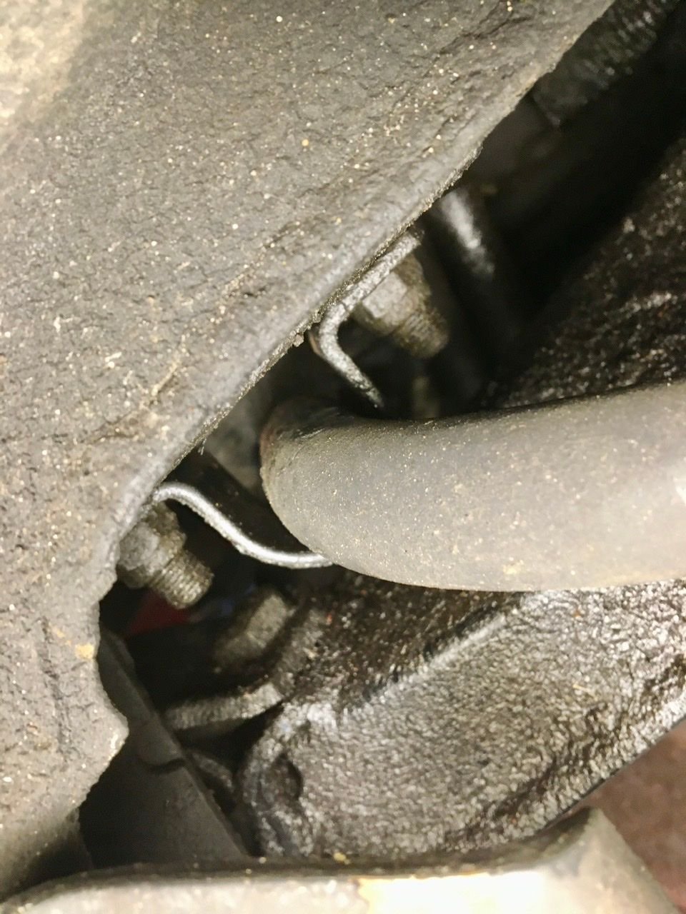

Well an update for anyone with clunking and rattling in the front... make sure you have a damn bushing where it’s supposed to be!
front left sway bar bushing completely gone

Originally Posted by Brg XJS
Please report back after you replace. I hope that stops the sound.
Yep, it’s the issue... I had an old bushing from my bmw that was too small to fit on the jags bar... I cut it up and shoved it in there. I knew it would fall out but wanted to test the sound. It made it like 5 miles(not bad)... silent!
