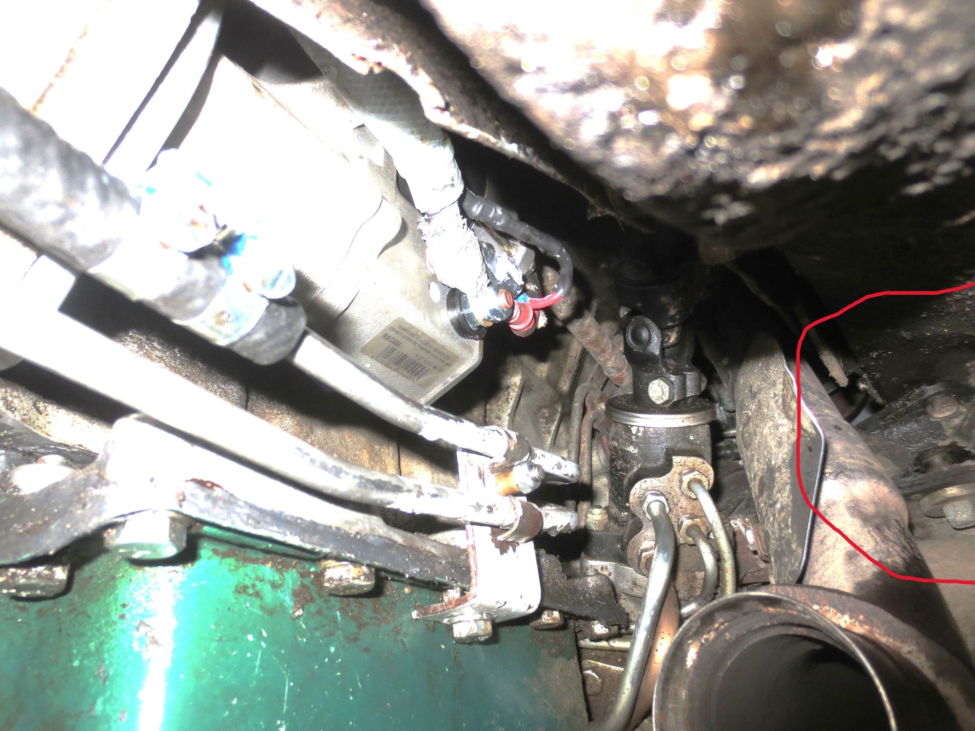

Apologies to Doug, but i do not think exhaust wrap is advisable. Apparently, somehow, it ruins even stainless pipes rather quickly. OK for race cars, but not for everyday ones.
Attached a photo of the RHS downpipe with the V mount in the background. They are miles apart on my car, I think your aftermarket pipes are wrong, Ben. Why not get someone to cut and shut them, using your old ones as a template?
See ringed in red.
See ringed in red.

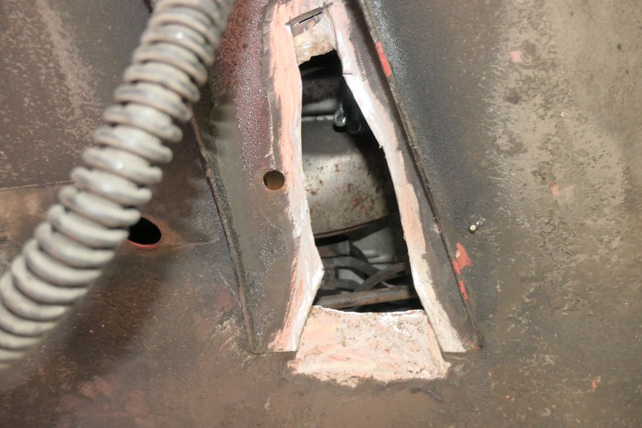

Right now the old girl is hors de combat as i am struggling to weld up the LHS front jacking point. I'll look though the achive to see if there is a suitable photo, if not allow a couple of weeks before i can get her on the lift.
Further to the above, I have dug up this pic, and it shows how much I can remember! The downpipe looks quite close to the inside rear corner of the V mount. I will have a look at the car tomorrow and report back.

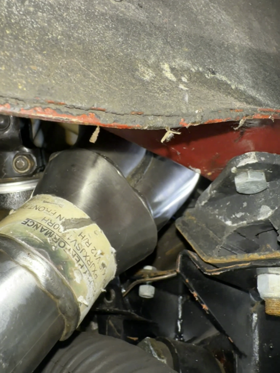

And that is precisely my reason for starting this thread, so I guess the next question would be what did you use as an alternate because they're in no danger of touching the body at all and if I heatshield the mounts I think I'll run with them - treat them as if they were cats - which perhaps they were modelled off.
I will take some pics today and send to Ben to see what he thinks but to be honest I am more likely to just roll with them.
So looking at Gregs pic and one I just took shows a similar scenario, and Gregs isn't the same downpipe, perhaps I didn't notice this when tearing down, either way it is staying. And yes I know I messed up my paint - the RH downpipe is an absolute pig to get in without dropping the steering rack. I also know the heat shield isn't installed on the left but thats because I am replacing the engine grounds - not happy with the originals - too stiff and too close to power steering hoses so I will relocate them - stuff ordered but not yet here.
