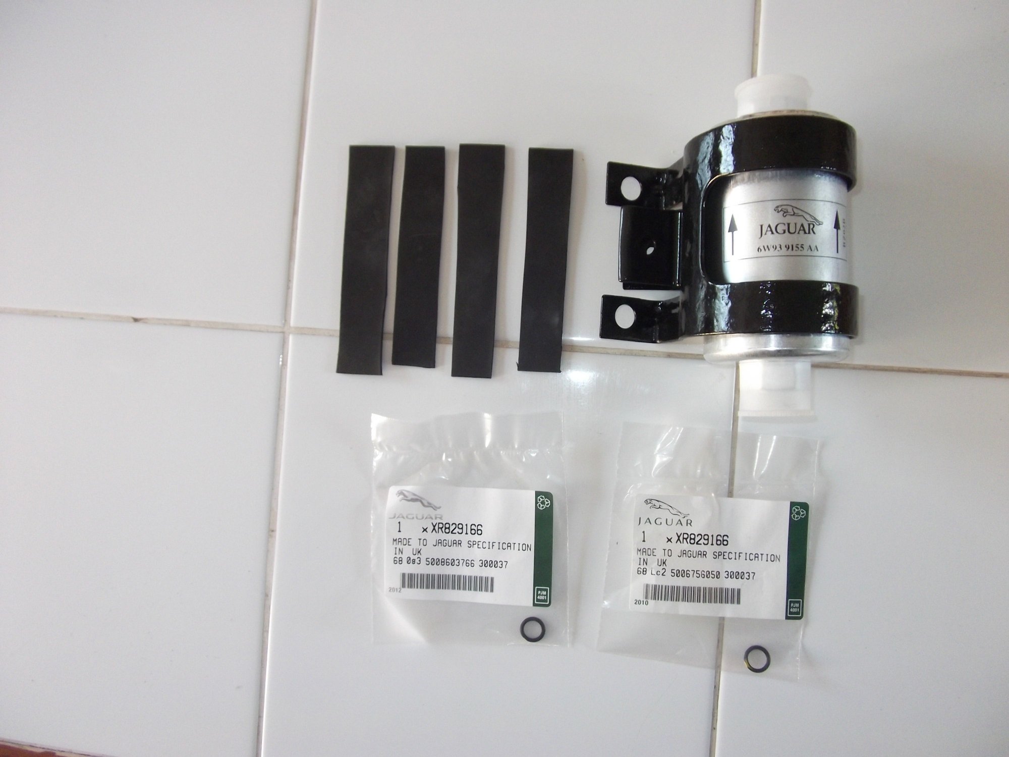

Anyway, you will need the 2 O-rings for the top and bottom of the filter union. If you look at the Jaguar parts website, they are not shown. See here:
https://parts.jaguarlandroverclassic.../brand/jaguar/

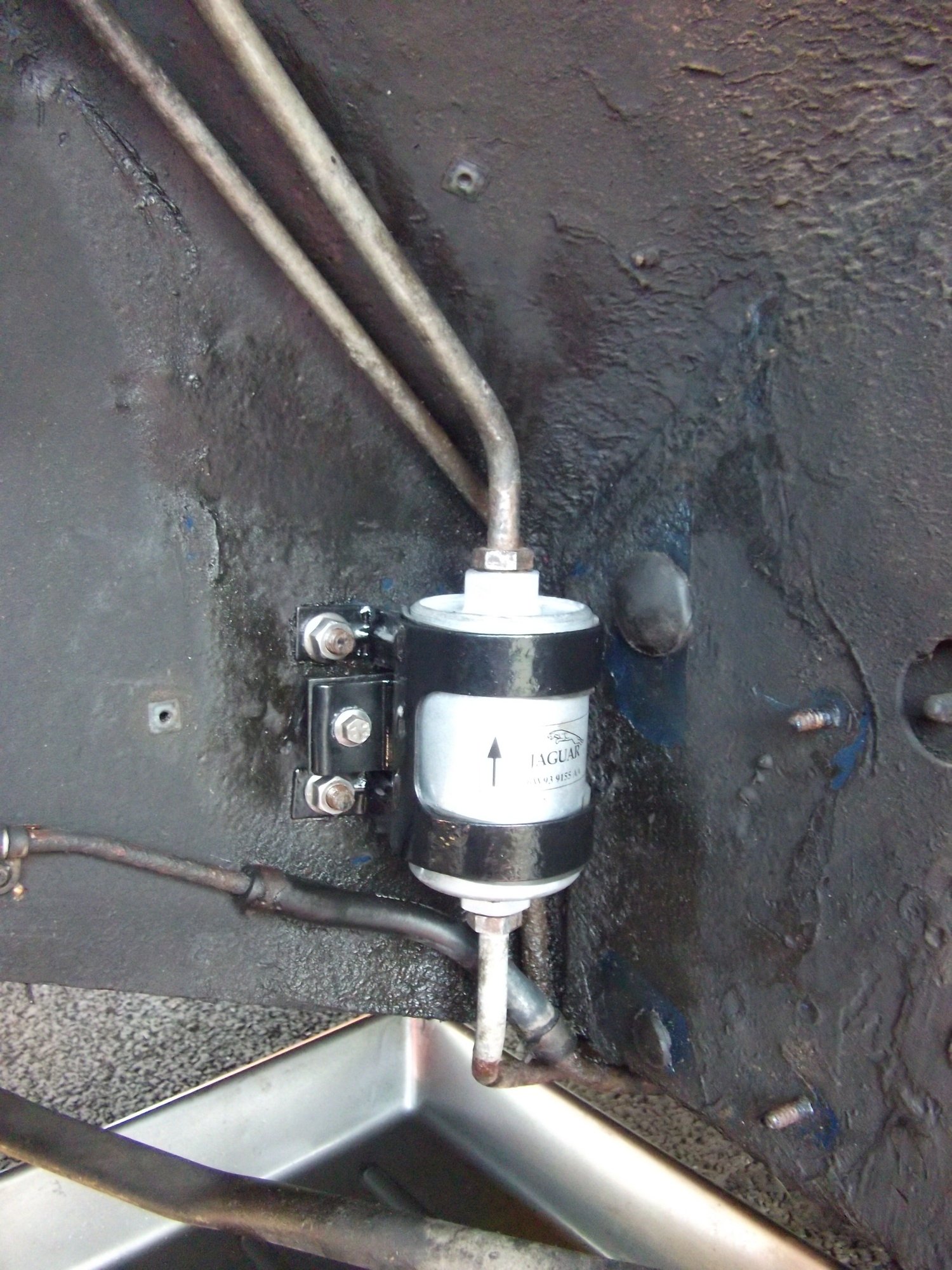

But my dealer told me they would be on the pipe joins and I needed 2 of the part number XR829166 which is an O-ring fitted to areas of other newer Jaguar models. Sure enough, there were O-rings fitted.
See the photos below of the last time I changed mine and you can see the position of the O-rings on the pipe ends.
Also the pipes will probably be very tight! So, after you've depressurised the system, initially loosen the pipe attachments whilst the filter clamp is still fitted or else you'll distort the pipes.
