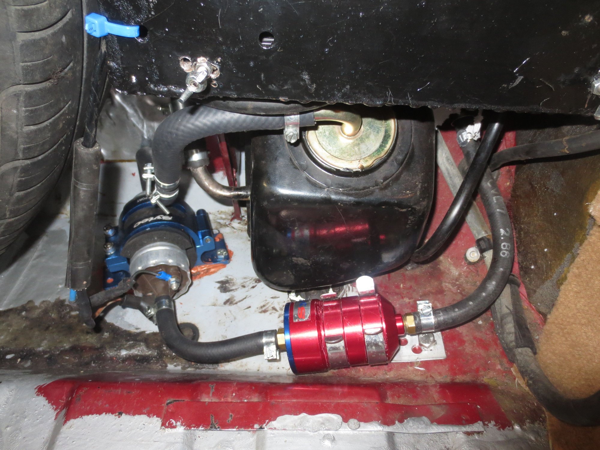

You are welcome, Brinny. I have also improved my layout in the boot, by installing the pump as in the photos, and inserting my smaller Sytec filter as shown. I have removed about 4 feet of fuel pipe from the boot by so doing, and my boot is 100% smell free.
The pump inlet is at the back of the boot, I used the USA piece to fit it, cut into two pieces, with a straight joiner to connect them, to give me the exact shape needed.

Perfect! Just bought this. I love the setup with the sump, filter, and pump. Don't know how ya got it like this just yit,,, but I'm on my way... Your straight connect,,, is it brass, pvc, steel, what? And, barbed, flared? Tell me sumpthin 😊
1/2 inch O/D brass barbed straight connector.
