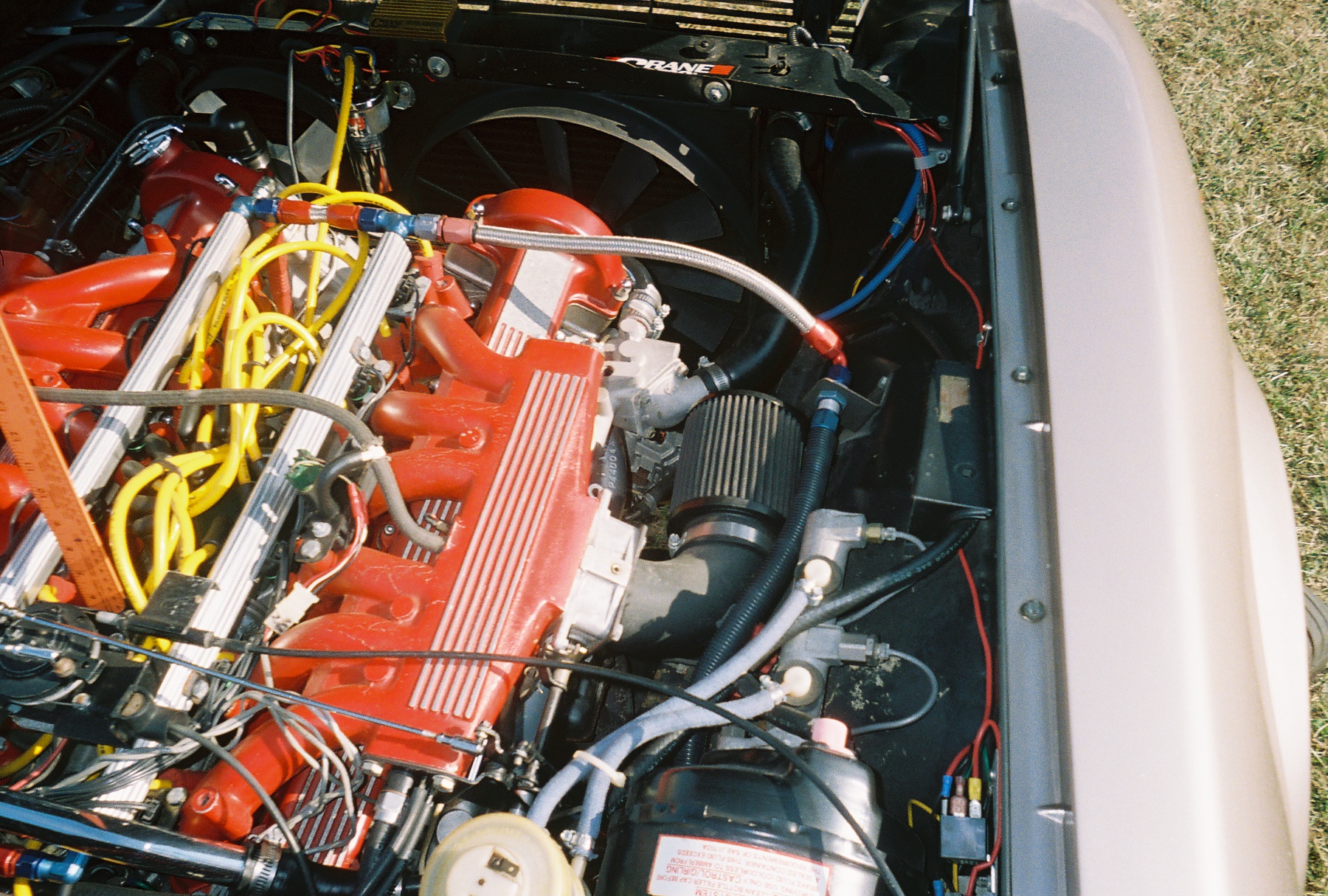

had to replace complet fuel system, tank in plastic(NASCAR cell) all lines & fittings, stainless steel pump and filter, fuel rails and injectors.
not cheap but never a problem in 20yrs
Attached Thumbnails Fuel and surge tank-trunk-xjs-fuel-system-union-jack-001.jpg   Fuel and surge tank-r1-07368-007a.jpg

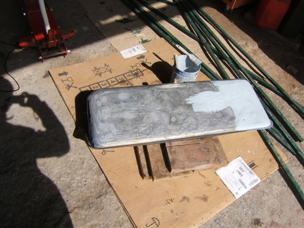

I am with SS on not lining the tank.like he said, it is nearly impossible to get it properly prepared. What i did was get the radiator guy to coat the bottom outside of the tank with radiator solder. Fantastic durable repair. Pic shows while painting over the solder:

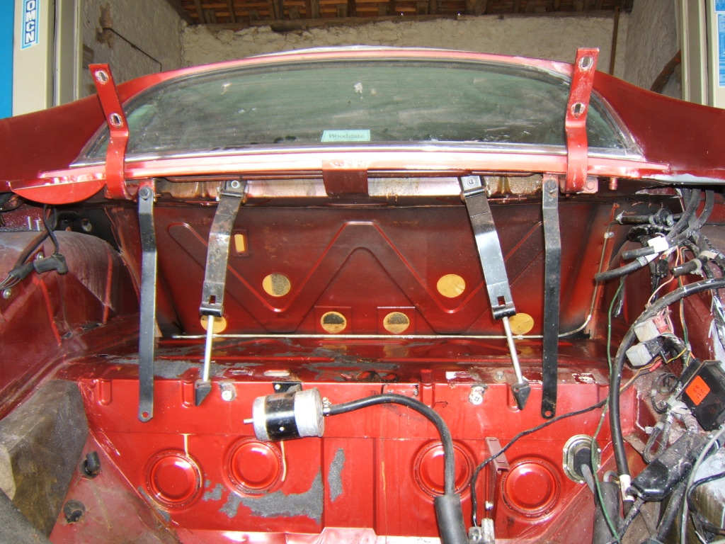

  • Ensure the vapour recovery system hidden in the top RHS flying buttress is working properly. there is a VERY thin pipe that goes to the carbon cannister in the front LHS wheel arch. This can get blocked and pinched etc etc. On UK spec cars it just opens out to the air in front of the LHS rear wheel arch, but on USA spec (I think) it is connected from here to the charcoal cannister. There are one way valves and all sorts at the cannister, and these need to be working OK. This pic shows the pipe along the back of the tank space:Name:  DSCF4393_zps6644e8c1.jpg
