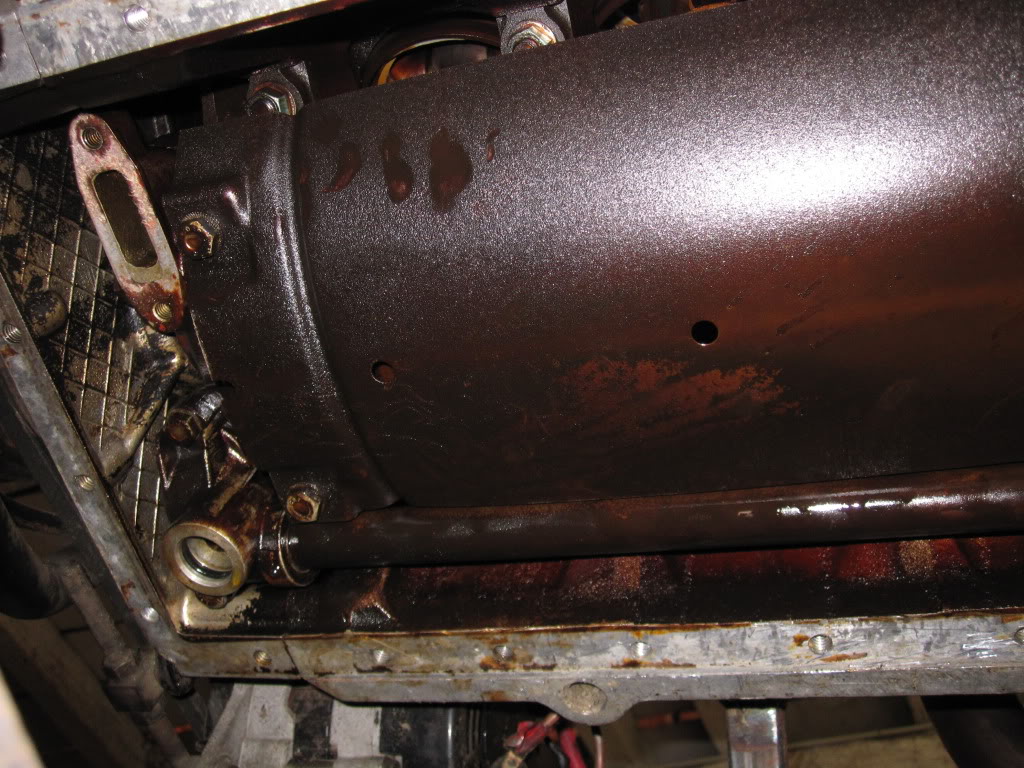

For those interested, the conversion is not that hard to do. You need the full flow filter head and the steel pipes that come out of it to the cooler from a later car, but after that it is doable at home. The two systems work as follows
SS, The bypass system was on all XJSs up to about 1987 or 8. It only sends oil to the cooler that is released by the oil pressure relief valve. This is set at something like 75 psi, so it seems oil will not go to the cooler on a bypass system if your dashboard gauge is reading under this. Next time I do a blast along the motorway (sadly not until the spring) I shall feel the cooler and see if it is hot or not. If not then no oil is being cooled and all my oil cooler is doing is blocking air to the rad!
The bypass oil filter looks like this:
AS you can see there is only one large pipe coming out of it and running forward to the oil cooler. Above this pipe is the exit for tiny the "question mark" pipe that goes to the sump. The fitting on the head that this tiny pipe comes out of is the pressure relief valve. Below it, as you can see, is the casting from which the oil cooler pipe comes out. Oil only goes into this casting when the oil pressure relief valve is open, so only goes to the cooler when it is open. The return from the cooler on the bypass system does NOT go back to the filter head.
On the full flow system, there are TWO large pipes that are joined to the filter head and it is differently configured inside. On this system all the oil goes to the cooler in one pipe and back to the filter head in the other. The engine itself is the same in this area, but NOT the same in one other place.
This other place is here at the front of the engine on the RHS:
This is the casting that the return line from the oil cooler in the bypass system is attached to. It leads the oil back from the cooler straight into the oil pump directly above. In the bypass system the oil pump has TWO inlets to it. ONE from the cooler and one (the main supply) from the sump pickup. THis is what the oil pump inlet looks like inside on the bypass system:
The round inlet is from the casting, the pipe going along to the inlet at 90° to it is from the sump oil pickup.
The conversion to full flow (DIY mode) is as follows:
  • Change the oil filter head to a full flow one. get the solid pipes that go with it.
  • Connect the oil cooler to these pipes
  • Unbolt the old bypass system return casting from the sandwich plate. Inside it there is a tube that fits into the actual round hole in the pump. carefully pull it out past the O ring and then block the tube with something that WILL NOT COME OUT.
  • refit the blocked off tube and the casting, or blank off the sandwich plate with a flat plate, but make sure it supports the blanked off tube inside..
You now have a full flow system ready to go.
