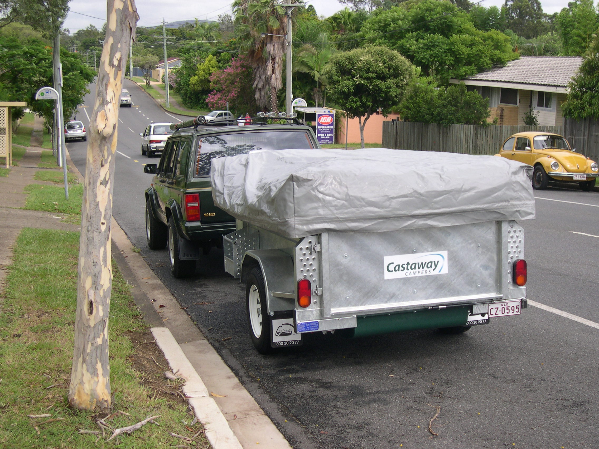

I had my camper trailer tail gate hot dipped and it hasn't closed flush since.(it never looked as good as the rest of the trailer from new so I had some panel work done and re-dipped it.) It is a lot more sturdy than the IRS cradle I had on my garage floor 3 weeks ago. If you lie the IRS with the front or back flat on the ground you can distort it by simple push on the opposite side.
I would go with paint or powder coating if it were mine,it was a job and a half getting evreything back in without it being distorted.
