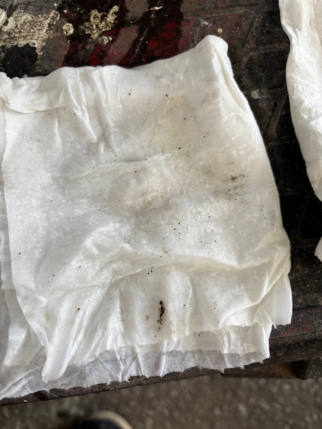

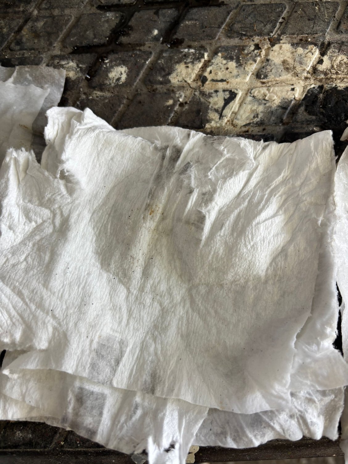

Thought I’d follow up with some pics of what came out of my main fuel line after flushing. This is what came after a 10 micron fuel filter and then a 100* micron filter at the engine.
* yes, you read that right, for some reason I thought I’d installed a 10 micron at the engine but somehow missed the rating at the time. Oops. But technically the trunk mounted filter should’ve gotten everything and maybe it did. But here’s what was in the main line after flushing back to front and then front to back. Pics are in order of flush.

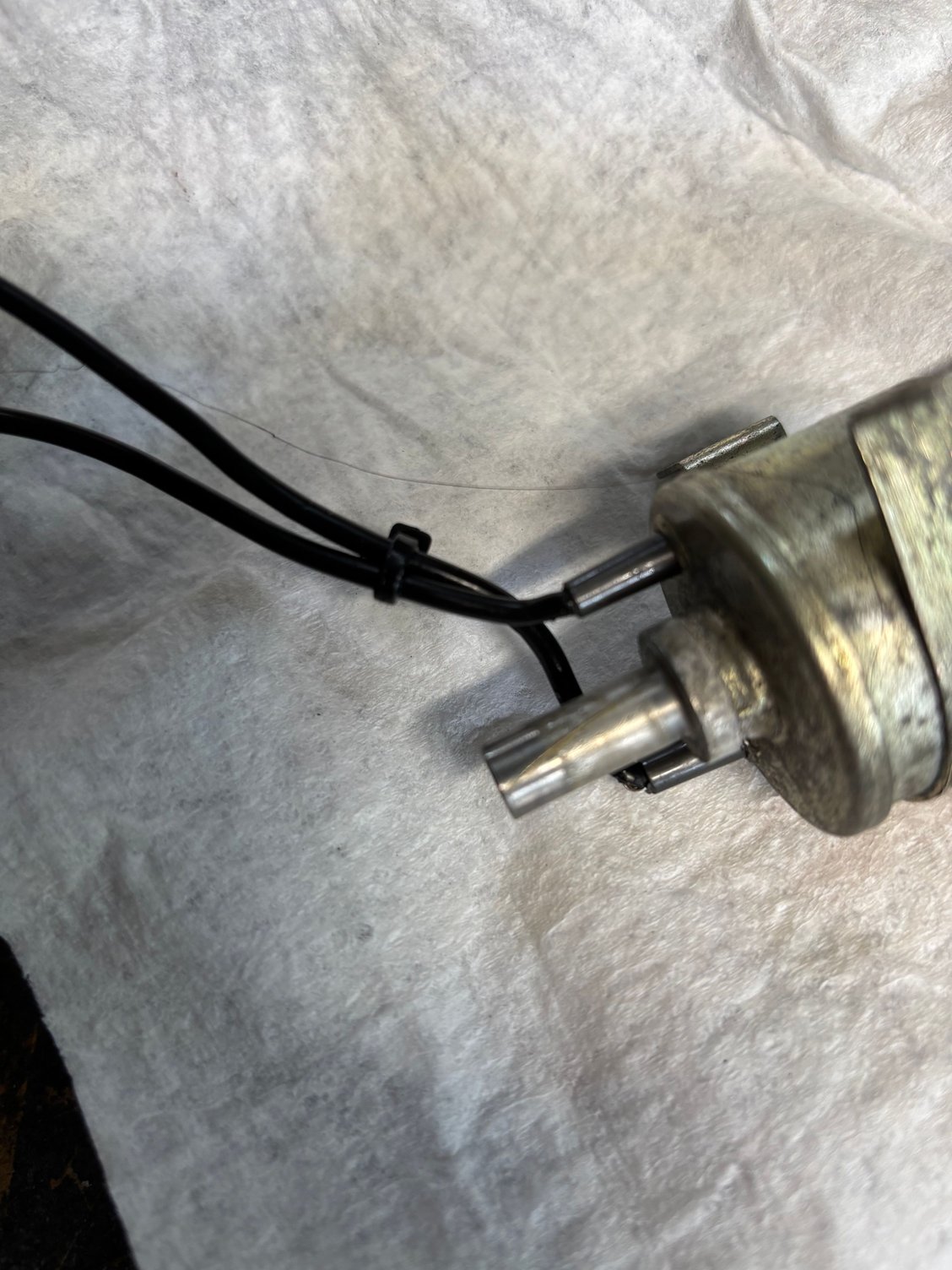

I think I discovered part of my problem.
my car, again a ‘74 XJ12 originally had carburetors and so the fuel pressure was 7lbs(?). And the original hard lines in the trunk had some flares on ends but not the tee for the return line back to the solenoids and the switch solenoids were straight tubing as well. Pics below.
My new fuel system has 40-43 PSI and that maybe was too much for those connections.
BUT! I still had leaks on some barbed joints that absolutely should’ve sealed and so original point remains. Gasoline smell is pernicious.
