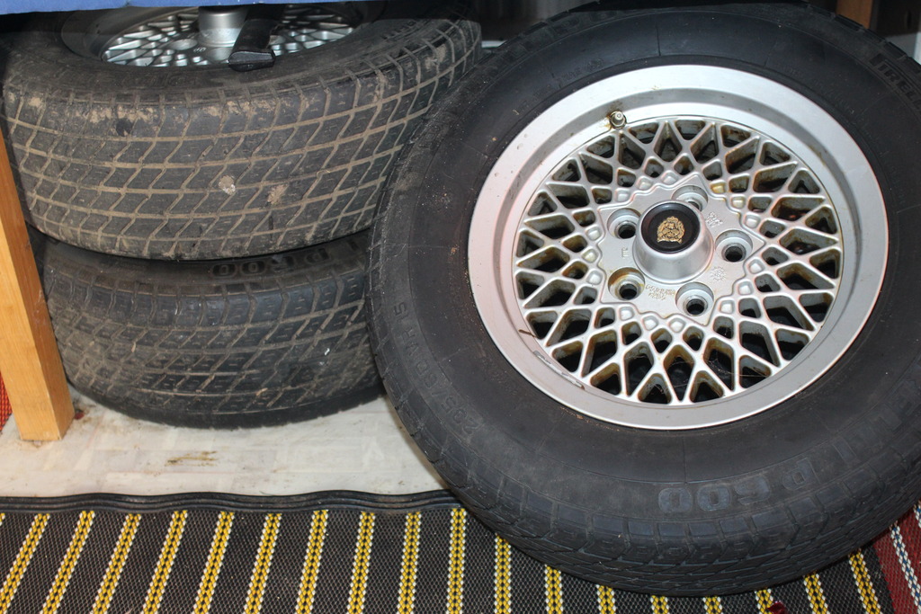

I wouldn't use Re-Moulds either but I bought what I thought were 4 Brand New Tyres for my Merc and one of them turned out to be a Re-Mould (from an Auction Site)
But how did I know?
Well at first I didn't know but after a few weeks, while I was re-blacking the Tyres with 'Shoe Polish' Don't knock it till you've tried it Lol!
I noticed a bit of an edge bead round the Tyre, at which point I did more research and found that it was stamped with an 'e' which is apparently the approved mark for a Re-Mould.
Obviously I wasn't happy and felt that I'd been 'Stitched Up' but too much time had passed to send it back and for the sake of £35 it wasn't worth the hassle.
As for my XJS, well that's a different story! as I'm not prepared to Play Russian Roulette with a high performance Car.
So Two Years ago, 4 Brand New Lattice Alloys which I managed to pick up at a Bargain Price.
And 4 Brand New Pirelli Tyres to go on them £150 each! inc. New Valves, which incidentally, most garages/shops will fit free just for asking.
The ones I took off still have plenty of Tread, which I keep under the Kitchen Table 'Like you do'
but having bought the Brand New Rims, I felt they deserved Brand New Tyres which I got from a proper Tyre outlet.
See Photo of the Wheels and Tyres I took off:
But how did I know?
