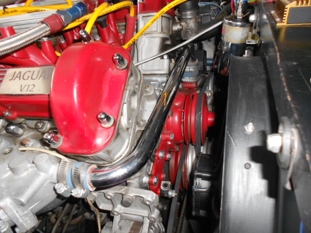

i have used the Crane XR700 box for 20yrs on my jag V12, it still works fine for my pre-he engine.
i tried the 3000 box and had misfires at WOT, so went back to the 700.
talked to the actual guy that designed the 3000, he said the technology in the 3000 was not proper for a 12 cylinder engine(he went on explaining but duh).
anywho couple pix of mine. 20yrs and counting, to be honest there are much improved systems out today that may be better,donno.
