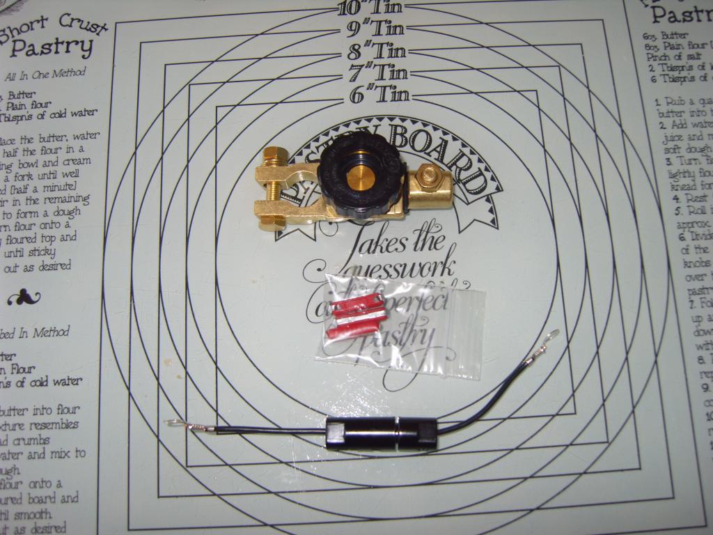

As I have just purchased an Amazing piece of kit, that has solved all my problems in one go!
One of which was possibly caused by a leakage to earth, as after a few days of standing my battery would run down but not anymore!
I found this gadget on ebay for under £8 including delivery and just has to be one of the best things that I have ever bought. Its really that good!
It is called the Dis-car-nect and although the instructions are a little bit 'iffy' it doesn't take that long to work it out.
The thing that really threw me was when it arrived, it already had a bolt through the round Terminal, which gave me the impression that you have to clamp the battery lead to that. Which isn't the case!
Having taken this bolt out, you then Clamp the Gadget to the Battery Negative Pole, just as you would a normal battery Terminal.
Then Clamp your cars battery negative lead to the round pole that 'had' this bolt going through it.
If you want to include the fuse able link, then use the bolt that you took out of the round Terminal, as the Terminal on the fuse able link maybe a bit on the small side for a standard battery bolt.
But this is a minor detail you can easily work out.
So with or without the fuse able link depending on your choice, the next thing you do is to screw the thread of the Black knob in the hole.
Then look to the left where the 'boot'/'trunk' light is and when the Black knob is fully screwed down the boot/trunk light will come on.
Which is an indicator that your Battery is connected and you are ready to start your Car!
If you leave your Car in a Car Park or don't intend to use it for a while, just unscrew the Black knob about half a turn and then watch your boot/trunk light go out.
Which then means your Battery has been disconnected and as such shouldn't run down.
You can also take the Black knob off and put it in your pocket or hide it somewhere in the Car, thus turning it into an immobilizer.
And though of course it won't deter a very determined thief, they won't be expecting to encounter that and as such gives them one more hoop to jump through!
The purpose of the fuse able link, is to maintain your car alarm and all sorts of stuff like that.
But anyone attempting to Start Your Car with the Black knob unscrewed will then 'Blow the fuse' and so will not be able to start your car with just that link in place.

As you can see I decided not to attach the fuse able link, as I have had problems with my Car Alarm going off!
Though really what I should have done and what I am going to do, is to connect the fuse able link and then just take the fuse out.
(they also include some spare fuses!)
If you do have a 'suspected' leakage to earth like I do, then you would have to take the fuse out of the fuse able link or else you might still run your battery down!
While you are looking at it, I may as well add that this is a 'Brilliant Battery' IMO for an XJS but you will have to make a new hold down clamp to go over the top, as it is a lot taller than the not so very good one that I threw away (XJS V12)
Please let me know what you think and did I do the Photo OK?http://http://
