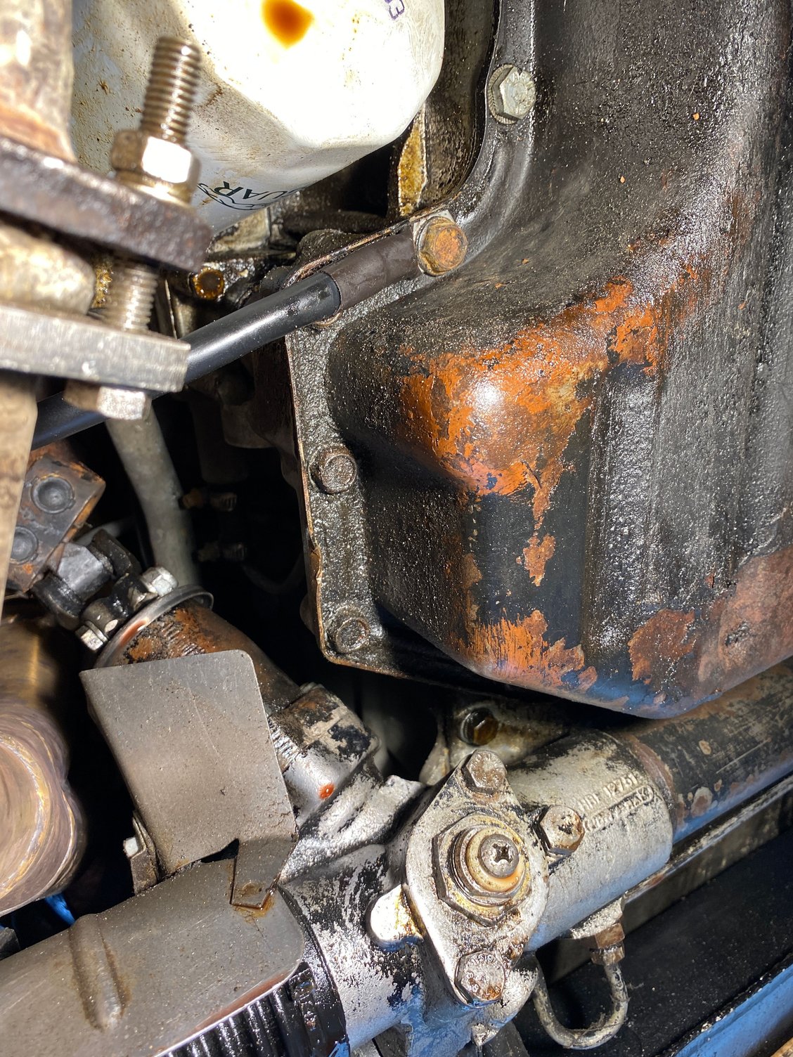

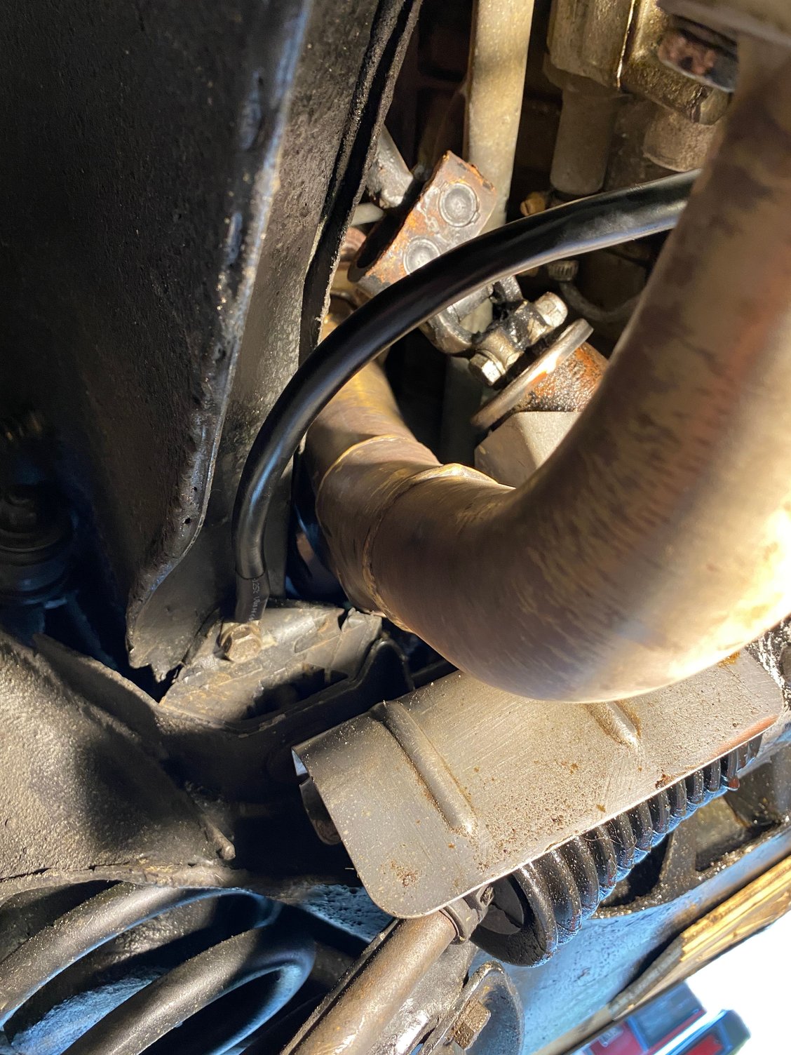

Old Apr 30, 2021 | 04:36 AM
leo_denmark's Avatar
Joined: May 2016
Posts: 783
Likes: 265
From: Middelfart
Originally Posted by leo_denmark
Sounds like a good way to do it, and redundancy is always good. Thanks for a fast reply !
Like this . LH side shown, RH still pending...
