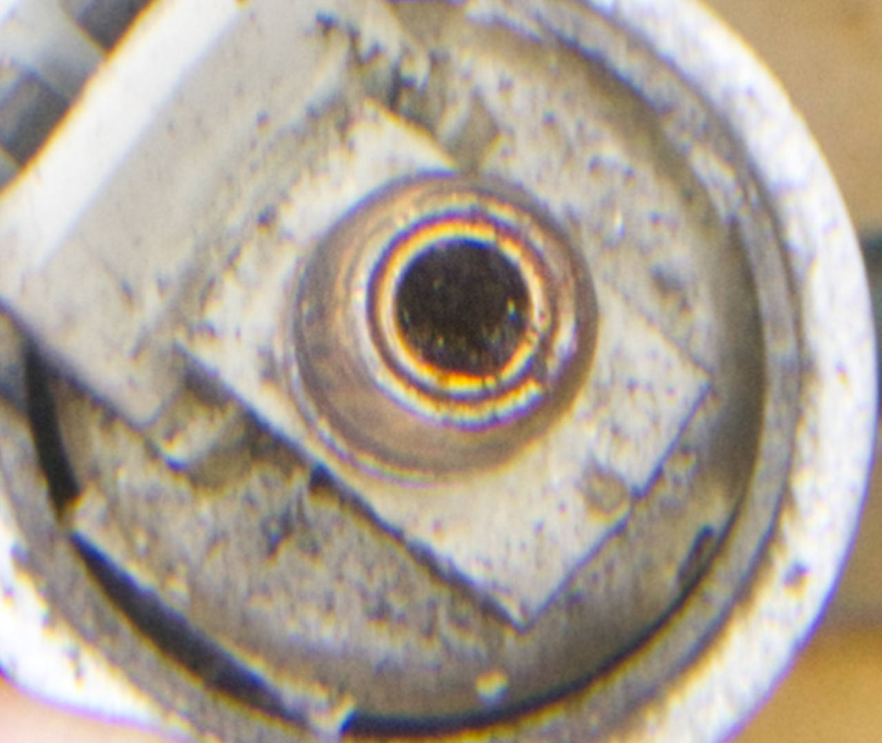

I started refurbing the fuel rail yesterday, tonight I got the injectors off the rail and some of them have a lot of crud in them, clearly corrosion from who knows where, I've run fuel through the lines on the car and banged them a bit but nothings coming out so is this a normal thing - don't think I've ever seen this much crud in an injector filter before, guess I'll be changing my fuel filter a few times, I'm also going to put one up close and personal near the engine as a secondary filter.
You can barely see the filter in the injector for crud - and this engine ran !!!
Take a look at the rail where it was inside the fuel line all of the fuel rail hose locations are like this.

New filter baskets! You can have a guy do it or try yourself with a jewelry/small ultra sonic cleaner. I gained as much as 10% flow when my injectors were rebuilt.

I already have the filter baskets - nice shiny new ones, I have new pintle caps too (got a full injector service kit from Mr Injector) is it OK to immerse the entire injector in an ultrasonic tank ?
The rail is a tad larger than the ultrasonic cleaners I'm finding on Amazon

I bit the bullet and ordered an Autool CT150, for the price I can use it on the other two 'elderly' injected cars I have, just another tool in the arsenal. I was getting quotes between 12 and £16 per injector plus VAT plus shipping so this way I spend the same and have the tool to do it next time, it won't be perfect but there seems to be some debate on line just how good some of the commercial services are.
I did some poking around and my system isn't in great shape even though the engine ran, the fuel rail is full of crud, used some drain unblocker in it and what came out wasn't pretty, again looks like rust so I'll be getting the pipe bender out and replacing all the steel fuel lines with Kunifer.
There were traces of varnish in the injector I started on, no crud since that was in the upper injector filter thankfully, MEK took care of the varnish I could see, a session in an ultrasonic tank can do the rest.
Based on the stuff I've read about these engines running too lean and burning stuff up if you put the boot in I'm taking no chances - and this motor will be getting an Italian tune every now and then.
My only major concern is how long I can keep these injectors out of fuel before they stick. It has taken two nights to clean up the fuel rail and I'm still not done with it, unfortunately arthritis in the hands is presenting a distracting challenge so progress isn't stellar.
