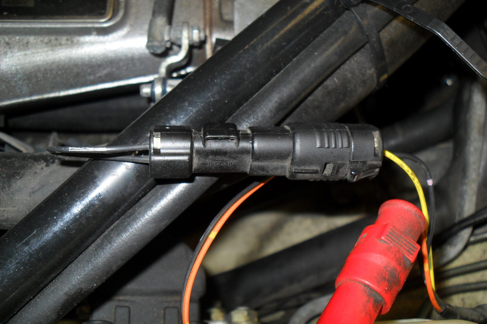

Here is the ignition jumper, it's on the LH side of the car my plug was missing so I just used a bit of wire as I will be replacing the ECU with an aftermarket soon.

that plug is for the mapping of the marelli ecu , if the loop is fitted then the engine map is for 95 ron fuel or higher ,
if the loop is removed, the ecu is mapped to use 92 ron fuel ,
it essentially tells the ecu what fuel is available to you where you fill up
so if your using 92 ron fuel , remove the loop , which is probably why it wasnt plugged in to start with , and your engine should run better and cooler

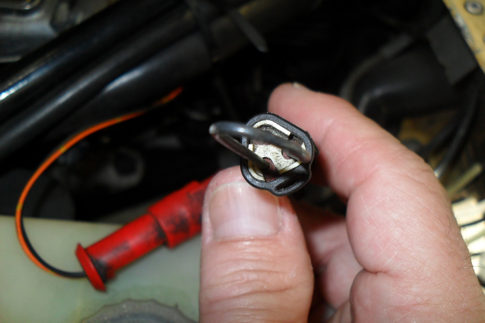

my 92 has a black jumper wire but it does not look like it can be removed-some have talked about a yellow jumper wire-is the black wire in place on mine the jumper wire or is there another wire to be jumped? I see 3 slots in the top of the connector..

here are my pics

BB is correct, the later Marelli V12's were high compression (12-12.5:1) depending on market. I think mine is 12.5, and is on the verge of pinging most of the time. If you run lower than 95RON I would remove the link. We have 98 here so I leave mine all of the time. I have never run it on anything but 98.

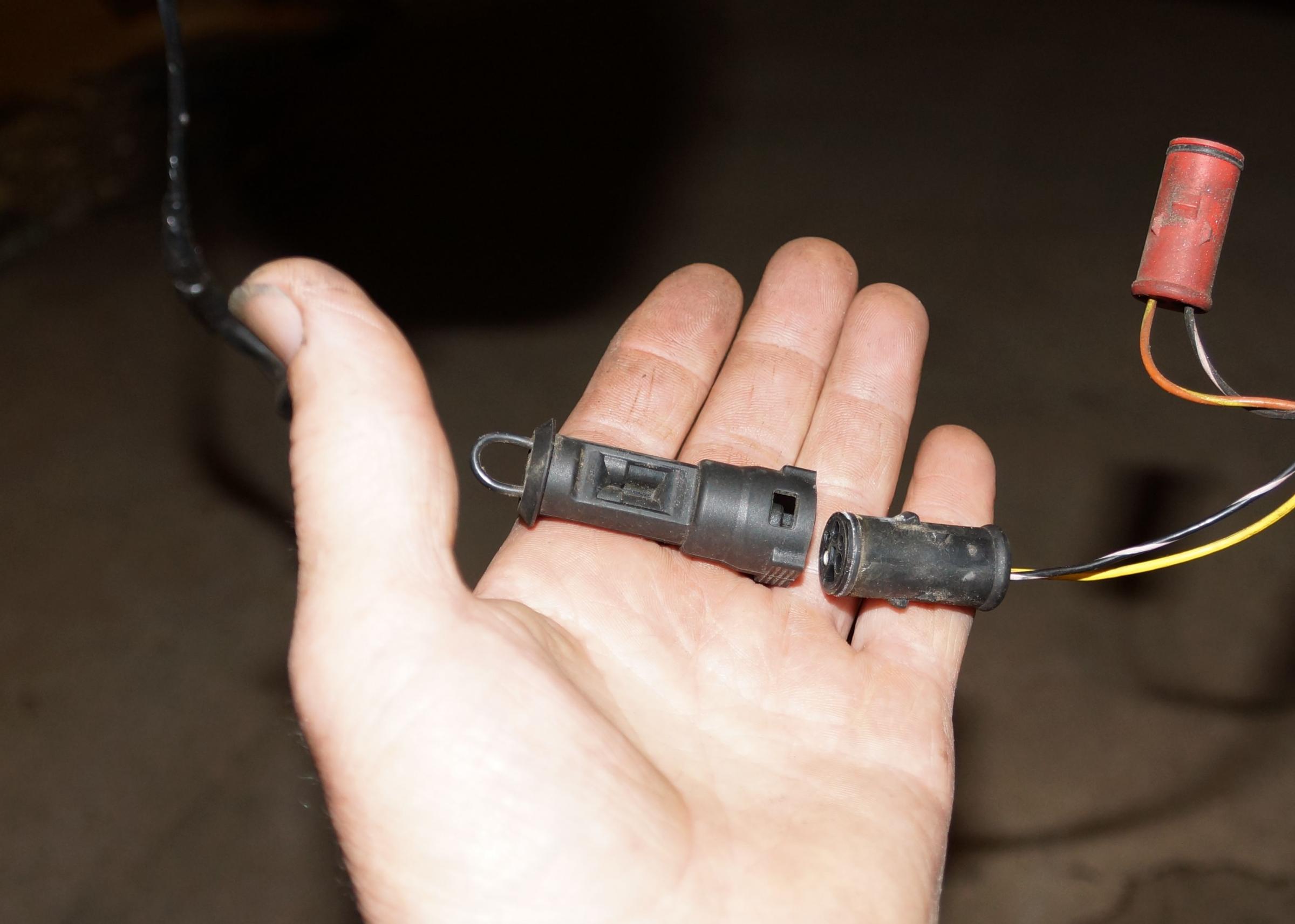

Unjumping involves unplugging. The loop at the top is not a jumper wire as far as I can tell.
