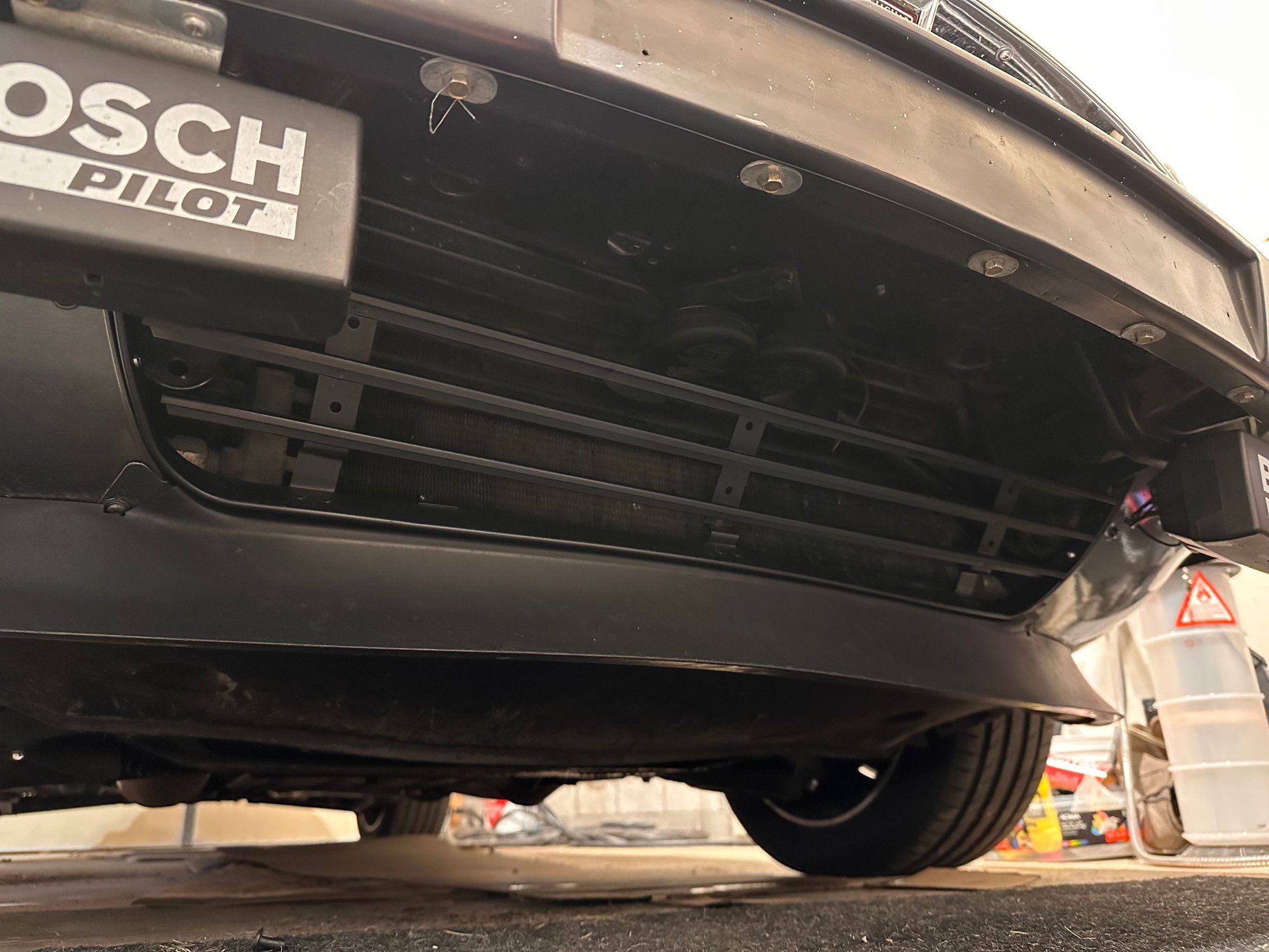

Installing a lower grill on my 1986, it hasnt been there as long as I have had the car.
definitely not a precision fit by any means.
the fasteners are giving me a challenge.
On my 1986 car, there is only 1 hole through the lower valence, right in the middle.
on the grill i got from ebay there is a center peg and 2 threaded studs on each side.
I drilled my lower valence to accept the 2 additional threaded studs but I now realize there is no way to access these studs once the grill is in place.
Were these threaded studs simply sitting there with no nut on the other end??
any ideas?

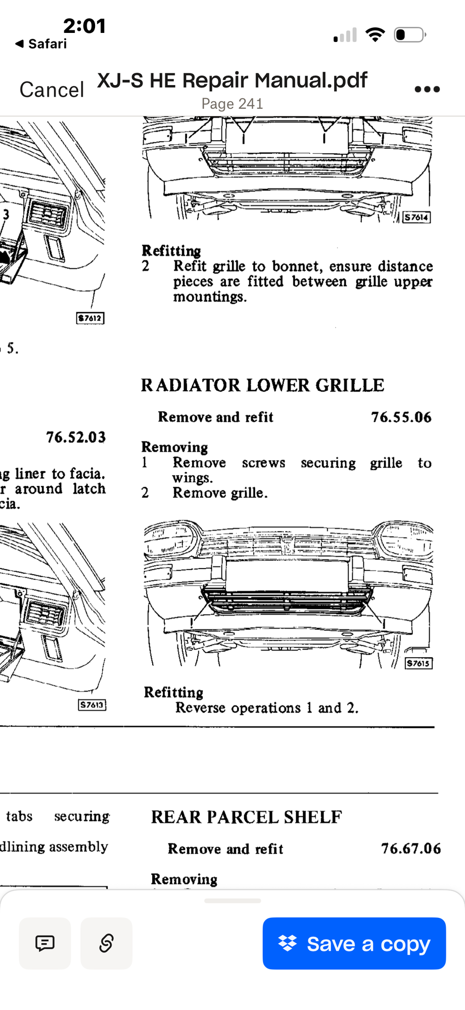

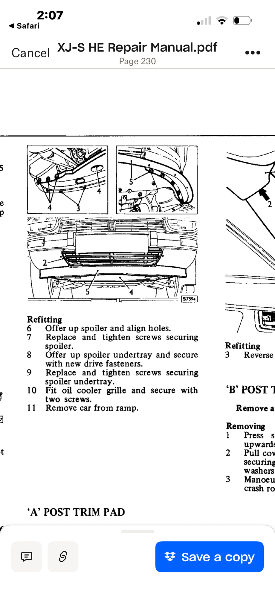

found details in service manual but it makes no mention of lower mounting points.

Got it on. Seems as though these things fit differently on every car. Had to make new holes on the sides as the self tapping screws werent even close to the oroginal holes.

Nice chin spoiler, is that factory and mine is missing, or was it added?
The only way the two studs can acquire nuts is if the radiator and AC condenser, or possibly bumper is removed. My grill just had threaded studs, no nuts, I didn't worry about it.

Looking at that parts diagram, I see why my PN 15 and 16 have zip ties on the bottom connecting them to the lower valance. Obviously they used to connect to the under tray that is no longer there.
