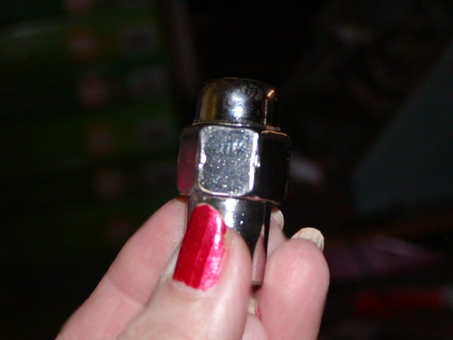

You might not want to use spark plug sockets on your lug nuts on a regular basis, especially not the Cheapies.
Spark plug sockets are quite shallow as sockets go, only needing to grab a relatively thin 6-point "bolt.". The photo below shows what happened to my lugs when the previous owner used a spark plug socket in an attempt to remove the nuts. Notice the scars on the corners about 1/4 inch from the top or the star.
You *Really* need a full depth 6 point regular 13/16 inch or 21mm socket for chrome lug nuts to prevent this happening.
