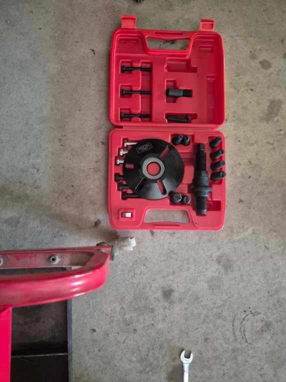

Whilst I was at it, I got myself a decent damper puller/installer. Just for our member's advice I rate this Toledo tool (I like Toledo stuff), the damper came off with small pop, job done. I had a practice on an old Series 2 V12 engine I have in the workshop before tackling the XJ-S, having an engine available on a stand has helped me out several times with 'seeing' what I couldn't whilst the engine was in the engine bay.
