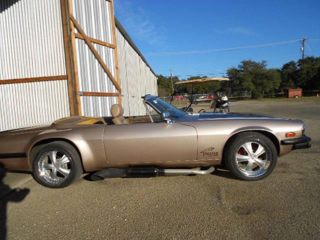

Originally Posted by JagZilla
The Black Pearl may not sound quite like the Targa XJS, but, Marko still has it sounding darn fine. From what I've seen of the Targa XJS, all 12 cylinders exit through a large collector in front of the rear wheel, on the driver's side of the car (right side).
I imagine much the same sound can be achieved on a dual exhaust setup by using a crossover pipe. That is assuming you also have reasonably large exhaust, that you have a free flowing intake system (an exhaust system can only expel as much air as the engine can suck in), and, that you have lightened your rotating mass as much as possible to allow for faster revs & faster deceleration, as the Targa XJS obviously has. Much of that crisp sound you hear is because the engine is able to rev so quickly & freely.
something like my Exhaust ALL 12 cylinders out of right side ,done 22years ago, still sounds awesome, because your ears hear all the sound from one place!!
