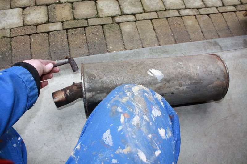

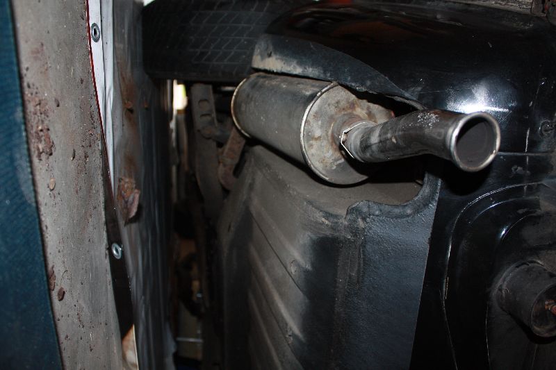

The two OEM stainless steel tips were fairly easy to remove, just releasing the little bolt and after a bit of wigling, they went right off... I was a bit worried because I've read that they could be very hard to remove. Then removing the right silencer was easy to. I had to use the dremel to cut through the bolt of the piece that hold the silencer and the tube together because the bolt was so rusted, I couldn't unscrew it. After that with a bit of force I could just pull off the silencer. But then for removing the left silencer, I also had to use the dremel to cut the bolt of but the silencer would not move... I had to bang it with a rubber hammer for about 1h30... Now I'm a patient guy but after about an hour I had to take a walk and a few deep breaths because otherwise the hammer would have ended up somewhere else but then I started to see some progress and half an hour later it came off!

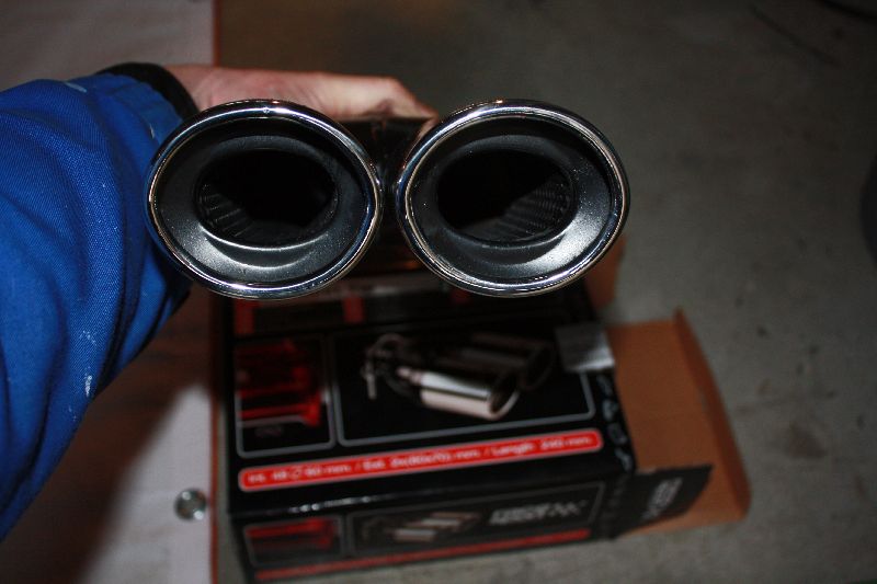

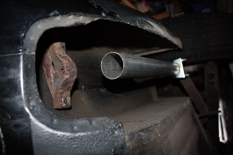

I just attached the 2 48mm tubes to the car and wanted to put the exhaust tips in place, when I saw they were to big and didn't fit through the opening in the back of the car a pity because I really liked the look of them. I can go and change them next week for another pair.

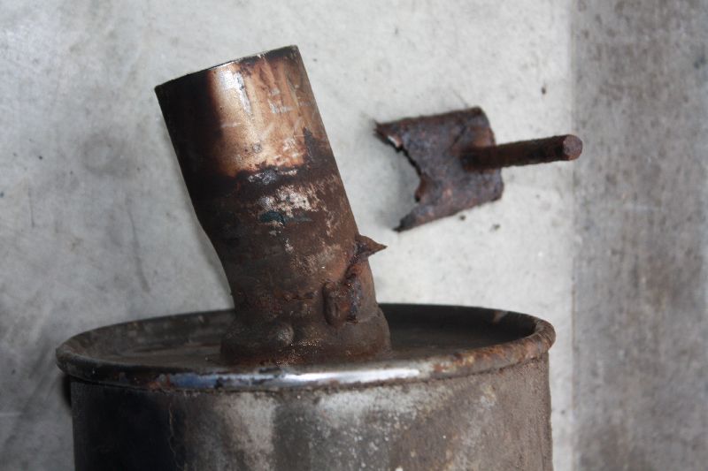

I also saw that at the end of the silencer, where the bracket rusted through, there is a 30° bent in the tube, so I will also have to bent the 25" extensions I bought before I will fit the exhaust tips.
I could not do the sound recording yet, because I couldn't take the car out the garage. I started the engine inside the garage and it is loud, I mean LOUD like Greg says. I will leave it like that for now and install the exhaust tips. From the moment I can take the car out I will make a movie to let you hear the lion roaring, it is no longer a cat but a really loud lion...

one more pic of the rusted through bracket!
I will fix both silencers so I can always go back to original if I want to...
