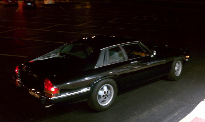

WIth much help from the forums here I am happy to say I can now drive the jag enough to get a feel for her and she feels pretty good!
Now my issue is a noisy fuel pump and a sputtering engine when the throttle is needed at higher speeds.
I changed the fuel filter last night and it seemed to quiet things a bit but it wasn't long and the pump started getting loud again.
I need to know how too clean the sump?? If I disconnect the lines going to it fuel spills out. Is this because there is to much fuel in the main tank still?
Also should I expect the tank to be rusty inside? If so why is this a problem with these cars?
To recap this is an 85 with 40k miles on it.

No comments on the pics? I think she is looking good...
