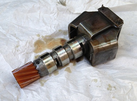

Found a chapter in "Experience in a book" that describe in detail how to check/replace governor nylon gear going through the access hatch in the transmission tunnel!

The governor seems to be ok. Over to the next on the list what will be the vacuum modulator.
Waiting for parts...
