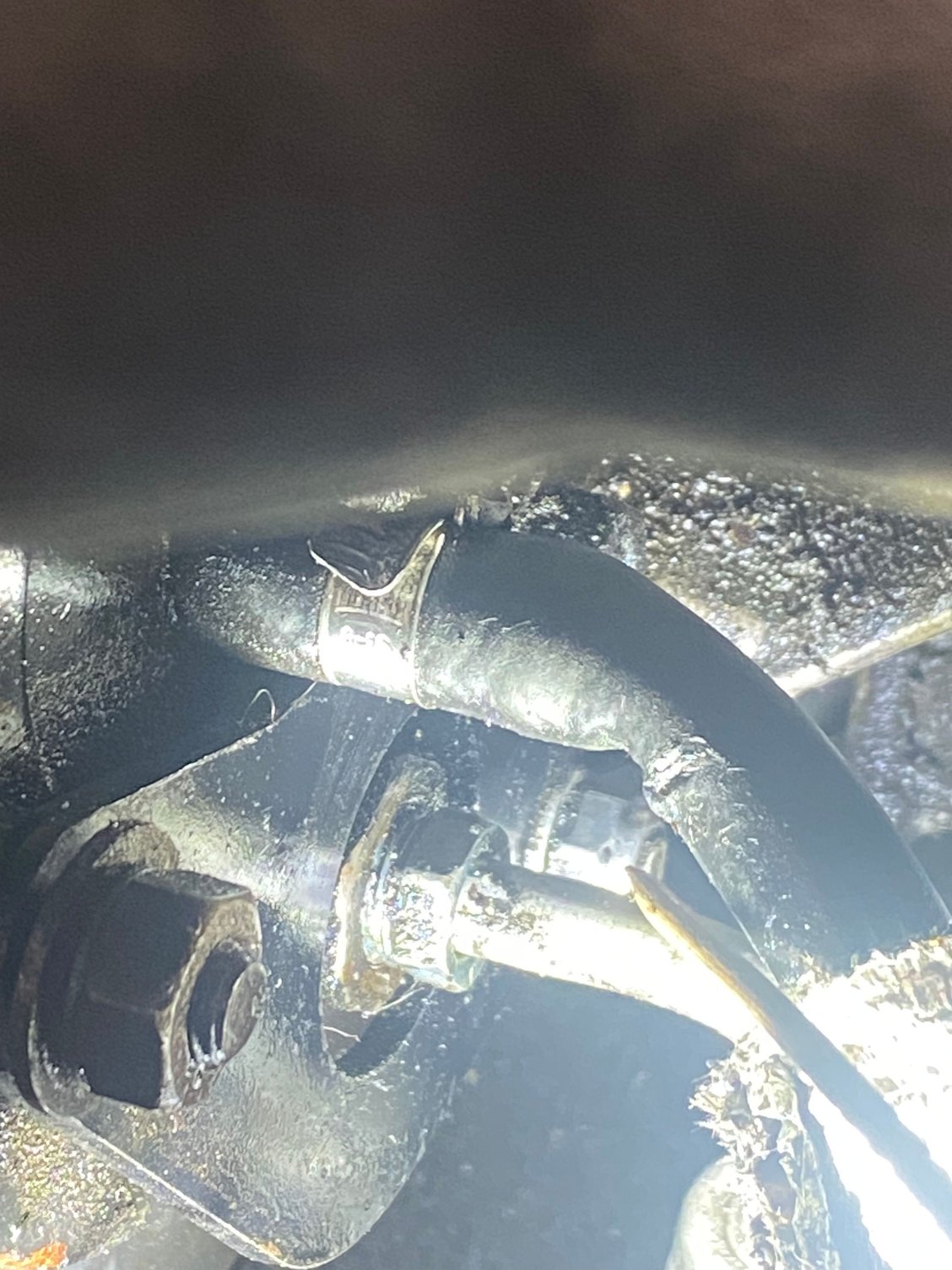

The tensioner I understand. But I cannot figure out what else I need to loosen. There is a bolt/nut that goes across the two mounting brackets I can see from looking down, but its not a pivot. Perhaps the only way I can get to the pivot is from under the car? I do see a fastener below the lower most hose on the pump - Is that it? It looks like a nylock

Looks like one of the GM style pumps, that whole bracket should pivot - you can't turn the correct bolt from the front it is kind oif keyed, I think that nut is the one but you need to peek at the front there is an ally bracket mounted to the block, the PS Pump pivots at the bottom of that.,

Thank you so much! That indeed is the pivot I was looking for and I can now move along!
9/16 swivel socket and long extension and loosed easily.
