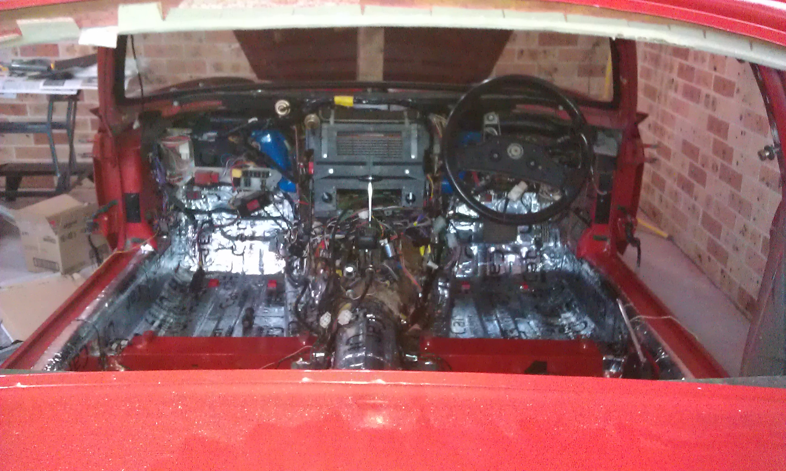

warrjon's Avatar
Posts: 4,638
Likes: 2,583
From: Vic Australia
I have no bonnet lining and haven't had for years.
I replaced all the insulation in my car with modern sound deadner,
Attached Thumbnails Project jessica-imag0168.jpg   Project jessica-imag0166.jpg
