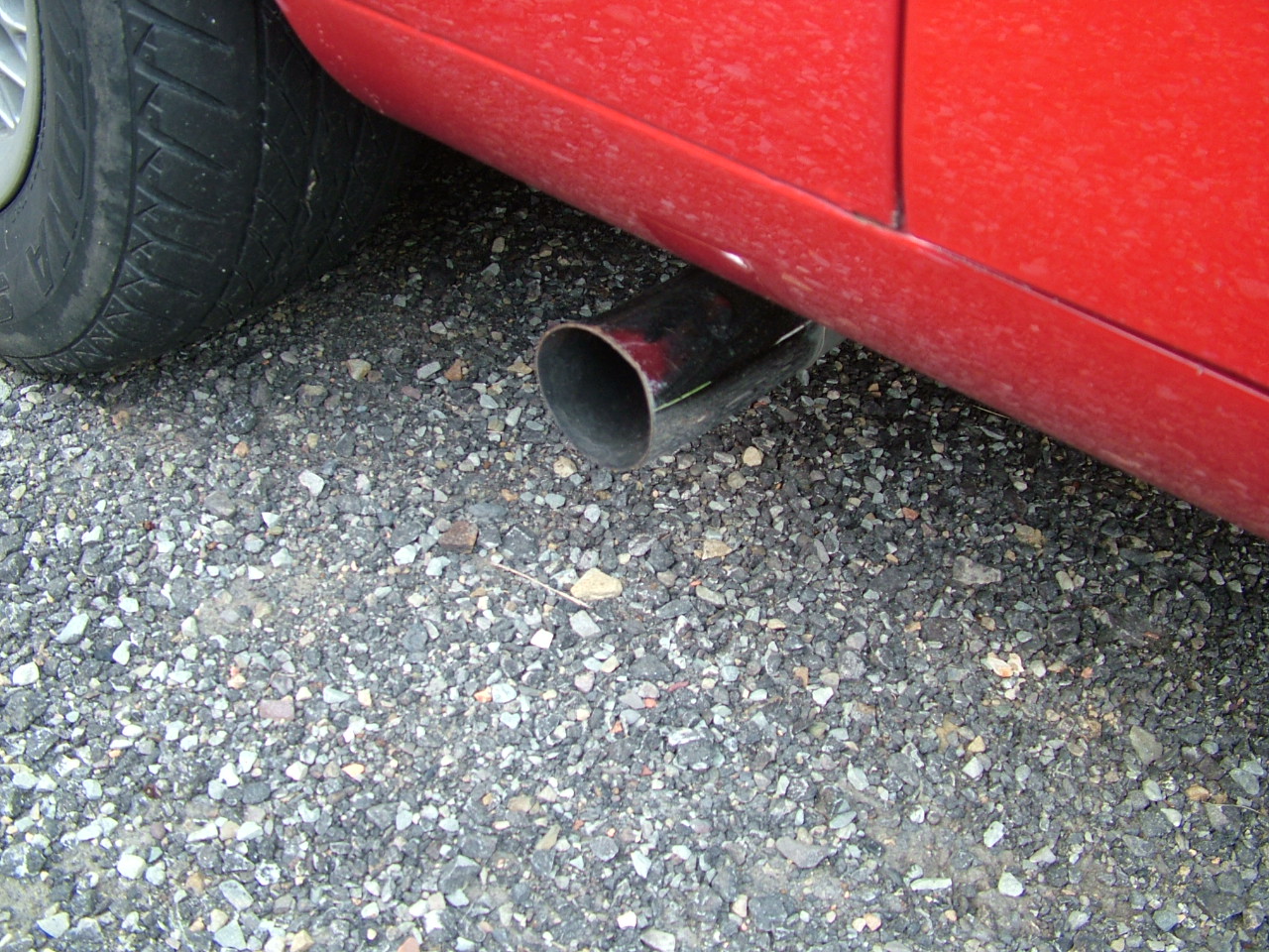

I really can't comment about the 6, but opening up the exhaust on a V-12 is the way to go! I wanted POWER!, so I removed the entire exhaust from the front cats back. Then 3" exhaust began where the front cat was. It goes through very small "mufflers" then exits in front of the rear wheels. Had it this way for 4 years now with NO problems. Talk about a Power Increase! When this Jag hits second gear, it's sideways! Oh and yes it's a bit LOUD!
