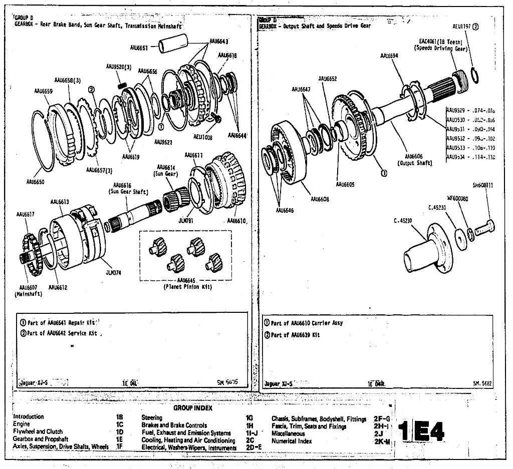

No slip joint at the front end of the driveshaft. It's a round flange with four bolts....just like you have at the differential end.
The mating flange on the output shaft of the transmission is held in place with a central bolt as illustrated here, lower right
As for the transmission mount, well, enough years have gone by that I can't remember any gruesome details....so I can't offer any specific advice. But I can commiserate. Jaguar had a real love affair with needlessly complex transmission mounts!

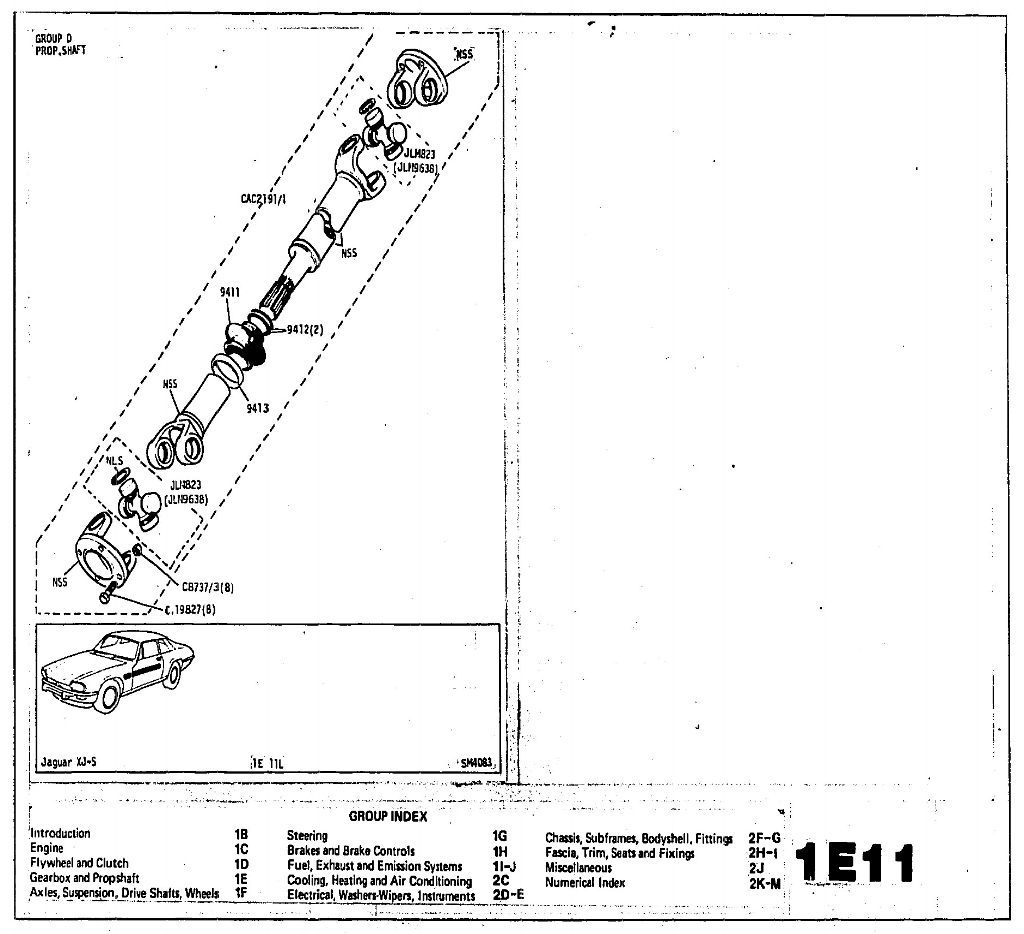

Well, OK then.
I guess the entire driveshaft removes with the trans after the four rear driveshaft to differential flange bolts are removed? I do see a slip joint in the middle of the driveshaft.
I got the four rusted rear flange bolts removed after having to drill and split one side of each nut with a chisel. Not enough room to get a box end around the nuts and the open end just rounded the nut corners. Didn't want to use heat due to the pinion seal.
