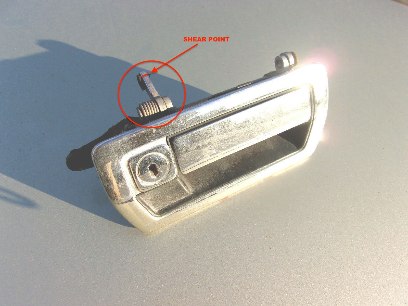

So a pot metal arm that is crucial to making my door handle work, snapped. I'd give a part number, but there isn't one, so I'll attach a photo.
Does anyone know if a repair is plausible? I've looked up "muggyweld" and "tech-bond". Tech-bond seems to be the one that might work, but I'd thought I would check in here to see if anyone knows about repairs to a part that will see plenty of torque. Most repairs talk about "filler" repairs.

I had almost the exact same break but on the arm of a Porsche door handle and NOTHING worked or gave promise of working long term, cept a "new" handle. My opinion (sadly) is to try to start tracking down a good used handle. Jus say'n

All you can do is grind off the rivet holding the spring/arm combo, then have a machine place make a new arm out of steel, and then use a bolt to replace the rivet. But there are loads of handles on UK ebay.

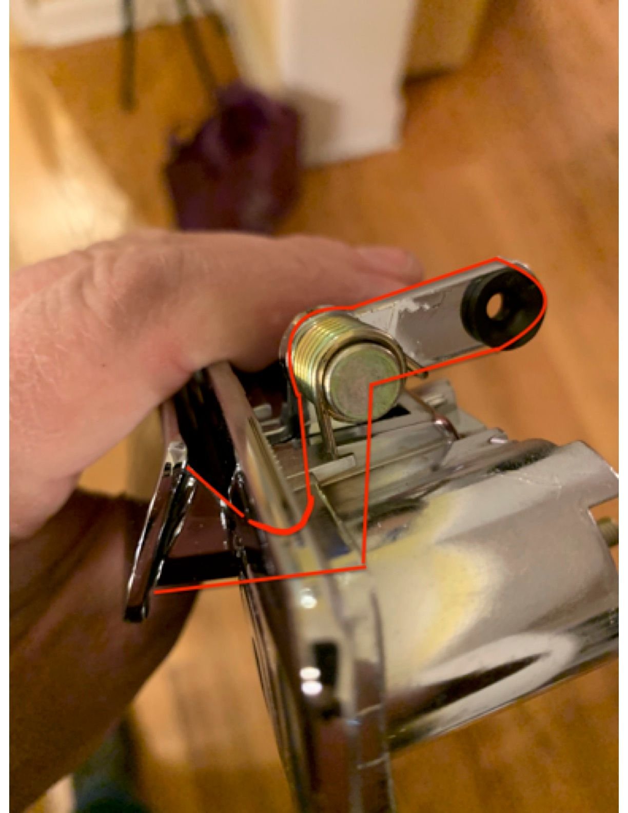

I'll have better pics once I get it off the car. Replacement is on the way.

That piece is not that complicated that it cant be made out of brass stock from a hoppy shop. Copy on to stock and then file to replica.

It's literally part of the handle and then extends through the frame to the links as one solid piece.
It's complicated. It will require a graft, not a replicate.
