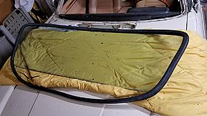

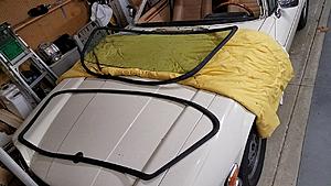

Well...I got motivated and decided to get to work on it. Cutting the old seal and taking the windshield out is a non-event, took about 30 minutes. Granted, I had taken the trim off a few weeks ago, but that didn't take long either.
Next step was to "dry fit" the new seal to see if it would fit. As soon as I took it out of the box I had an uneasy feeling. The original seal was clearly formed to fit around the rectangular windshield (see photos, it's sitting towards the front of the car). The "new" seal is...well...round. My first thought is that somehow I got the wrong part, but the part number (BDC7178) is what any reference I can find says is the correct part.
So I thought I'd see how it fit. From looking at the photos it's easy to see that it's way too long.
The thought occurred to me that possibly this is the right part, and that one is supposed to cut it at the appropriate spot and, of course, seal the cut? Every photo I can find on the internet that matches this part # shows an unformed (round) seal.

Hi John,
This is very common I ened up ordering 3 different screen seals and all of them were too long. What I did was fit the seal to the car and cut it to the correct length, then glue it back together with superglue.
I have said this a million times when you install it use Polyurethane window sealant not mastic. If you use mastic you will be re-sealing it again in a few years. I used PU sealant on my rear window and it has been leak free for 7 years, the front was put in with mastic and is leaking, It's on my list of things todo to pull the front again and re-0install with PU.
