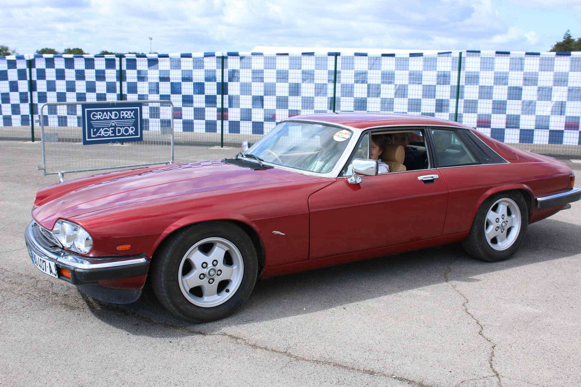

My car with Jaguar celebration 8J x 16 x 33(ET) rims fitted with 225/55 x 16 tyres:
This is my car with 8J x 18 x 33(ET) rims from an XK8

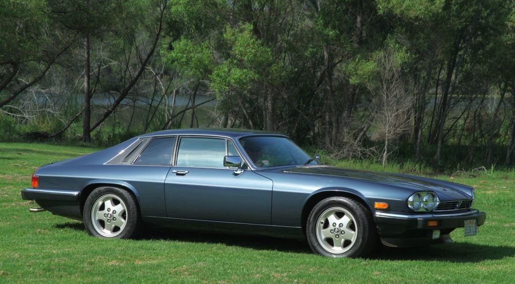

I went for 16" wheels on my 1987 XJ-S to get more tire options.
I concluded that any of the XJS facelift wheels will fit.
Here's a photo of mine
I have 225 x 60 VR 16 tires, which have a rolling radius within 1% of the original 215 x 70 VR 15 tires. No spacers were needed.
HTH, Dave
