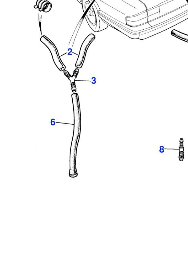

The one thing that did happen was as follows: on the final three days I had quite a strong fuel smell in the boot (trunk). Now because of the international petroleum situation, I always topped up the car to the very top every time I stopped. When I got home I emptied the boot and looked for the cause. There is an overspill drain in the fuel filler well that drains down and out through a spigot inside the rear LHS wing (fender) in the cavity outboard of the exhaust tunnel. The drain flexible hose is pushed over the spigot which drains out of a hole flush with the body. As shown in this diagram:
https://parts.jaguarlandroverclassic.../brand/jaguar/
The hose had expanded and was no longer a tight fit on the spigot, so some of the fuel that drained from any spillage in the filler well could accumulate inside the cavity, instead of draining out. New hose fitted and tunnel carpet drying out. Worth checking on any XJS.

Your overspill drain issue may be the issue I have had of late as well. I will need to be pulling the tank for checking my 1/2 tank issue so what you identified will be something I'll have to check as well.
