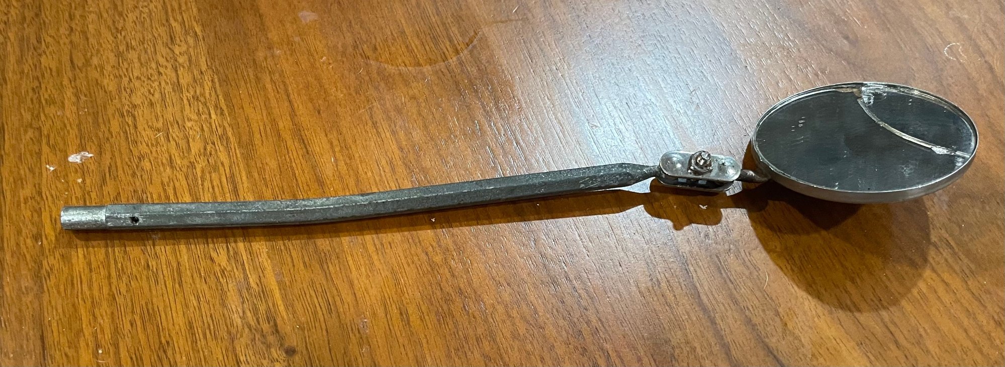

Made a huge mistake while turning the engine by hand to set the distributor position. Had a helper use the end of a inspection mirror to mark the travel of the top of the cylinder while I turned the engine by hand under the car. Passed TDC and marked the pulley, about a 1/4 way back up to get the final marking for TDC and my helper informed me the inspection mirror was jammed......
Any ideas on how to get it out and how f'd I am? I'm guessing if by some miracle it comes out that the cylinder is scored and the engine is a goner. Not sure what to do now after all the time and money poured in here, feeling sick!

Assuming the real engine and not the 1/2 size thing, BEER, lots of BEER. Wont remove the offender, but you will feel better, eventually.
Again, assuming the rod is steel???, and has gone down the plug hole????
Send your helper for more beer, and get a small magnet on a stick, looks like a ballpoint pen, with a STRONG magnet at the tip, and extends about 12" or so. CAREFULLY, go searching, and even more carefully retrieve the rod.
I suggest rotating the engine so the piston goes DOWN SLIGHTLY, thus allow the rod to be un-jammed, if it is in fact jammed.
Damage, NAH, not a chance.
I dont know why you have appeared to rotate that engine backwards, IF I have read the scribe correctly??. That is a recipe for snapping the $600 timing chain plastic boomerang, and about 12 hours (if the Jag Gods are with you) to fit said boomerang.

Thanks for the reply Grant. I don’t think I described it correctly. The inspection mirror is sticking out of the plug hole and is the rod I am referring to. Not the engine rod. I can grab it. While rotating the engine clockwise, the mirror got jammed against the piston/cylinder wall and the spark plug hole. I’ve tried tugging on it but it is very solid.
I believe that my helper was holding the rod/mirror crooked, thus when the piston was rising it jammed the mirror against the plug hole.

Soooo, on clockwise rotation to find TDC, the helper had an oops moment, and the rising piston jammed the thing, got it.
ONLY way forward I can honestly mention, AND against all that I know of these engines:
SLOWLY, and read that word a hundred times, rotate that engine backwards NO MORE than 3mm at the front pulley.
IF, again IF, you are lucky and careful, that will be enough to free up the piston grip on the mirror stem, and should not do damage to the Boomerang.
It will only require the smallest lowering of the piston the let that rod loose, so think, take your time, and I see no issues.
Brute force, and silly sudden rotation of the engine will hurt many things.
Try with 1mm rotation, you may be blessed.

I'll give rotating the engine back a tad to free it. Supposing it works and no 'crunch' is heard, a compression test should let me know if any damage has occurred?

It’s out! And without rotating the engine backwards.
Might use a dowel next time.
