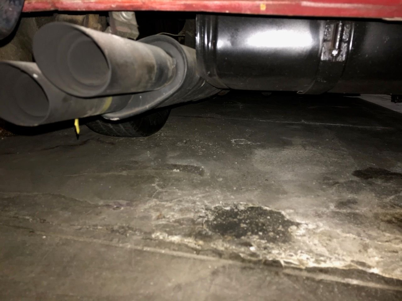

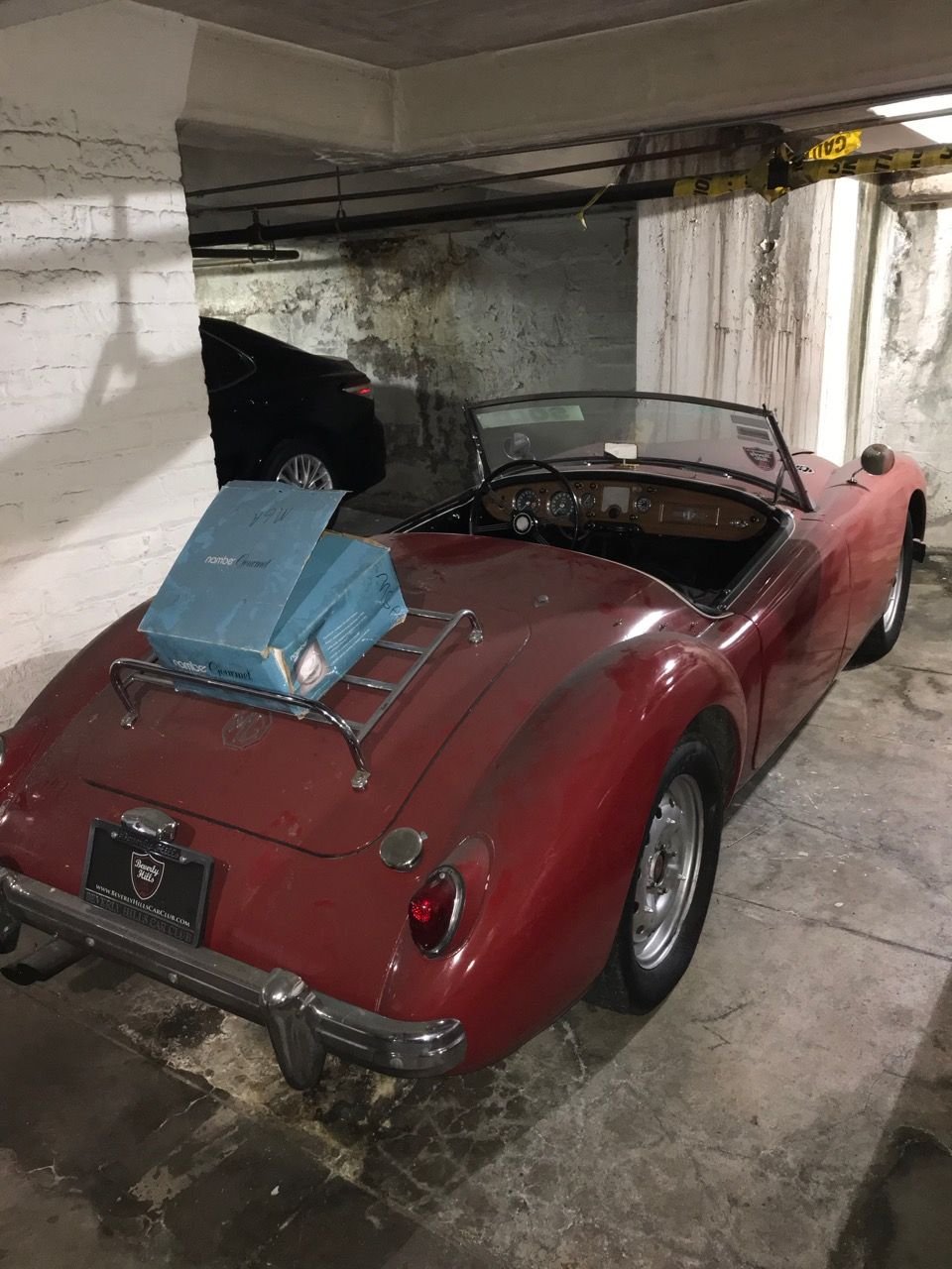

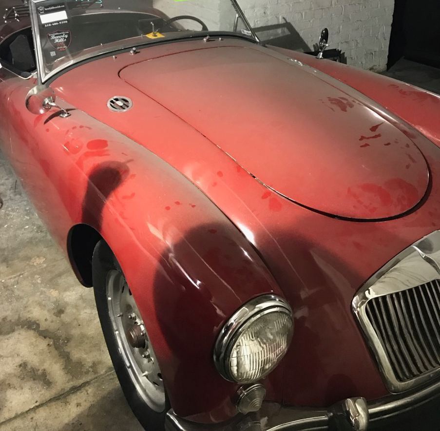

Apologies for this not being about a Jaguar. But I wanted to run this by people of this wonderful community, to ask for an advice on potential purchase of another British classic car.
At this point, it is nowhere close to be certain. But I might have a good chance of getting 1959 MG-A convertible. The car appears to be in a decently good shape cosmetically for a 60 year car. There are a few dings here and there, but overall it seems like the car has been taken care of. I did not see any rust. I know there will be maintenance issues (and likely repairs) to deal with, but this is to be expected with with any 60-year old cars. (After dealing with V12, there appears to be so much room under the hood with a 4 banger!)
It is red, it is convertible, it is British. Of course, everything will depend on the price (which is TBD). But overall, what do you think about MG-A? Anything specific to be aware of with these cars/this brand? What would be a fair price for a specimen in this condition?

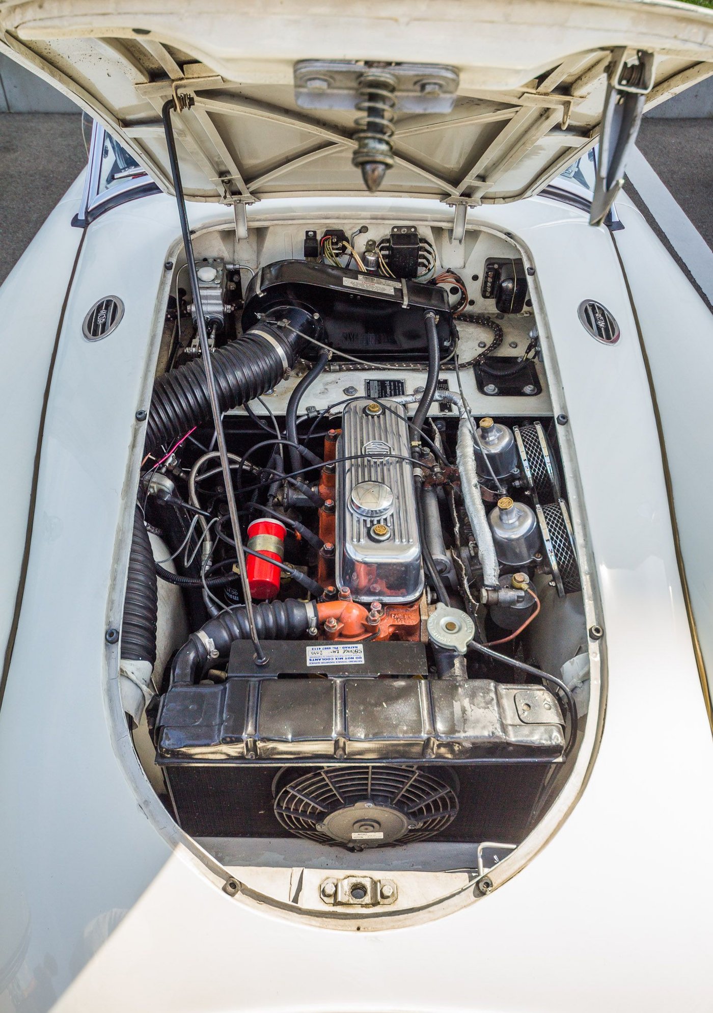

Can't offer you much good advice, but I know a guy nearby who has one, and I've gone touring with him--his car sounds amazing in tunnels. Not brutal or anything, but a good, strong, engine-y sound. It made me very tempted indeed. Go for it. They're very good-looking cars.

GO for it! The MGA is an absolute classic, loads of support and parts in the UK, mechanical parts are cheap, engines easy and reliable. As long as the bodywork is solid, which you said it was, if not they can be a real problem to fix, and panels are scarce, and very exensive.

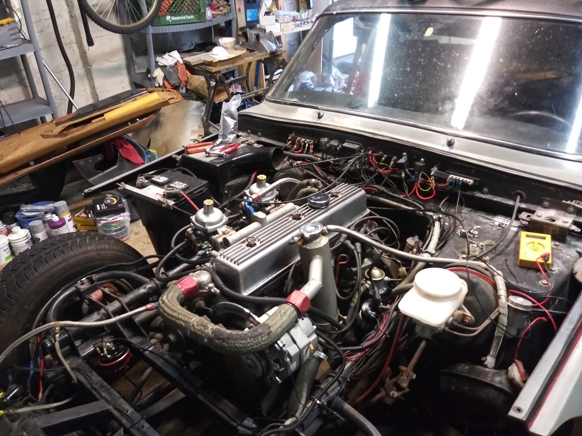

On my latest TVR, I had, years ago, traced the ignition and battery power wires and replaced them with modern wire. They tend to heat up, and at this age, the insulation will started cracking.
Just recently, after finding too many cracked wires under the bonnet, I decided to just upgrade the entire underhood electrical system. Im not worried about being a purist. I want reliability, and to minimize the possibility of fire. So I decided that a singular loom was not for me. i mounted B+ and ignition bussbars on the firewall, and made separate looms for alternator, wipers, starter solenoid, radiator fans, lights, horns, and sensors. All the circuits were powered by waterproof relays and 10ga. The lights, blower, horns, electric fans and starter solenoid each were fitted waterproof relays. I also protected each circuit with auto-reset Bussman breakers. All the powered wired were covered with fiberglass sheathing in case they chafed on metal.
Over my time with the older British cars, I have found the electrics to be the biggest contributor to breakdowns. And I like driving my toys.

I prefer the earlier cars, ie 1954 but that is a great looking MG.
