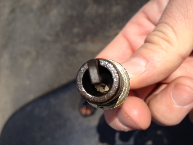

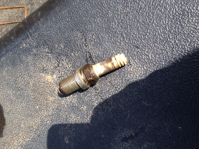

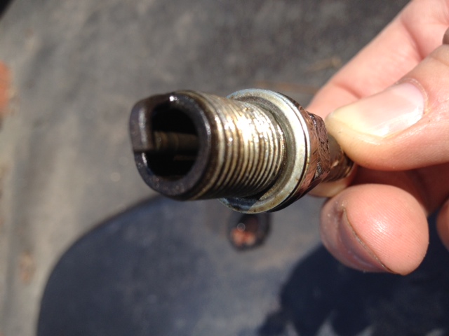

Well now I know what happened.
The spark plug blew. The one in #5 is destroyed. Never had that happen to me before.
That explains everything. Oil was easily bypassing the chamber and leaching into other cylinders. Any harm in draining the oil into the cylinders by loosening each of the plugs? Theres only broken bits of plug in Cylinder #5.

Did you pull the plug out? How does it look?

Are you saying there are bits of the broken spark plug *actually inside* the cylinder?
DD
Hopefully it was just a faulty plug and the ceramic bits were tiny enough to pass through the engine. Careful inspection would seem to be the order of the day!!

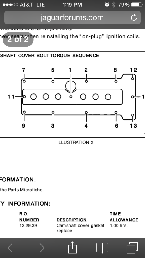

I completely understand about the cam cover.
Following a series of failed attempts to end the leaks with first my original cam cover and new gaskets, and then with a used cam cover with yet another new gasket, I finally found someone selling New Old Stock cam covers and some OEM gaskets. Imagine my dismay when my brand new cam cover followed on the path of its two predecessors!!!
All it took was a manual half turn on all the screw using the Jaguar specified sequence::
After that not only does my new cam cover make the engine bay look nice and new, but also leaks no oil!!
