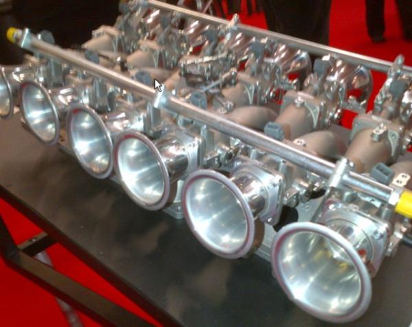

Old Jan 15, 2014 | 07:34 AM
  #308
xjr5006's Avatar
Posts: 183
Likes: 272
From: UK
my choice for something that runs on the road would be something like the AJ6 engineering system but in an aluminium casting. The crossover system looks wonderful but I wonder how well it works, its too low IMHO and the compromise of where and how the injectors and their fuel pipes are located with the necessity of fitting it all with clearance under the hood is problematical.
Injectors in a similar location to standard would allow a better curve, longer runners and higher throttle bodies with bellmouths easily clearing the cam covers and the hood, just my 2p worth. So I think the crossover system shown is a beautiful looking fail.

i mentioned that the AJ6 inlet manifold system is about the best compromise for an XJS under hood.
i dont think anyone is gonna come up with anything better, except a forced induction setup, and i do know that the simplest would be 2 remote mount turbos and a good standalone ECM, and there is enough room under a lowered XJS to do it!
and i dont do any off road driving, not my style!! lol.
Attached Thumbnails so has anyone actually made 500bhp from a v12 pre.he-r1-07368-013a.jpg

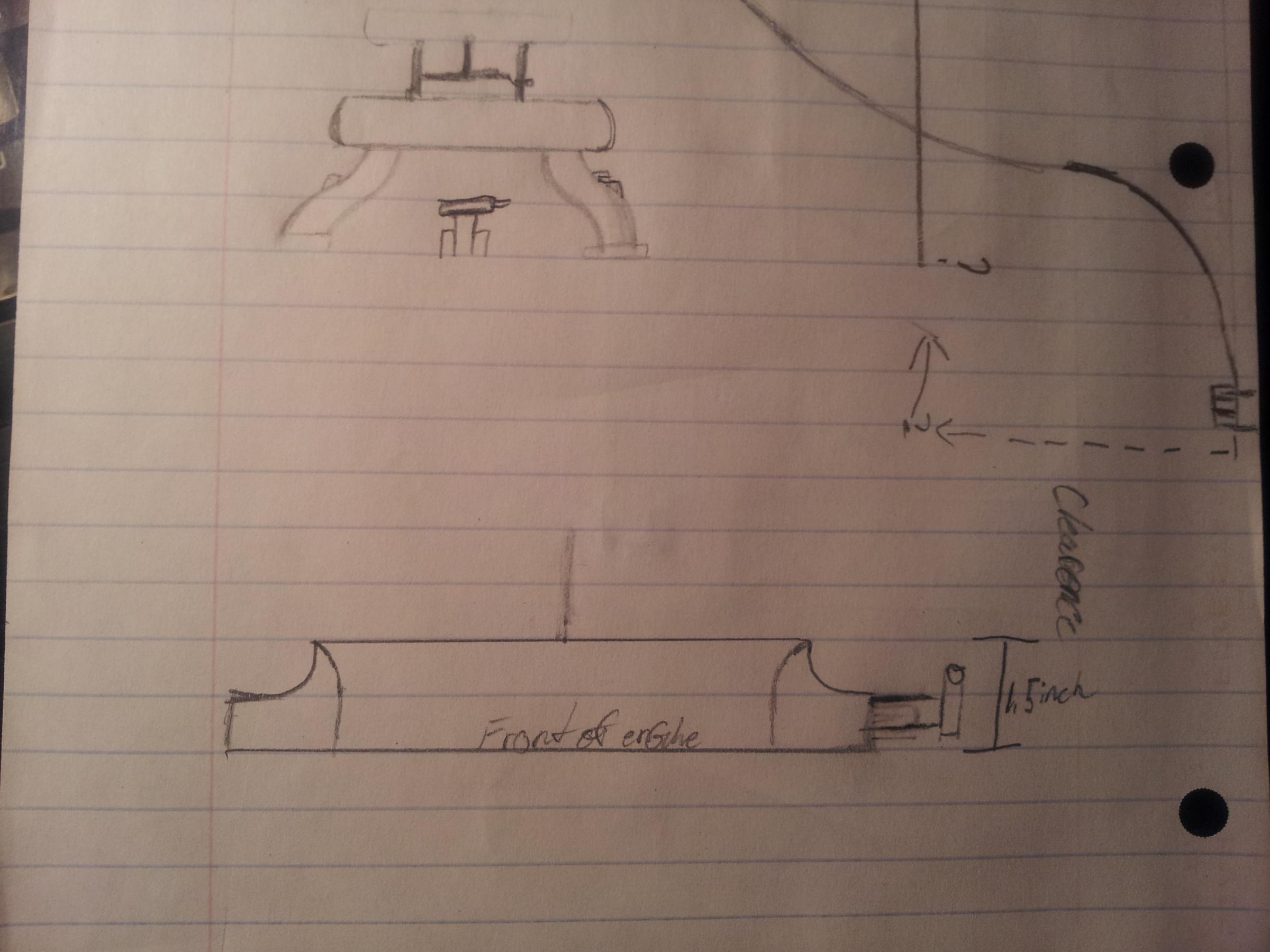

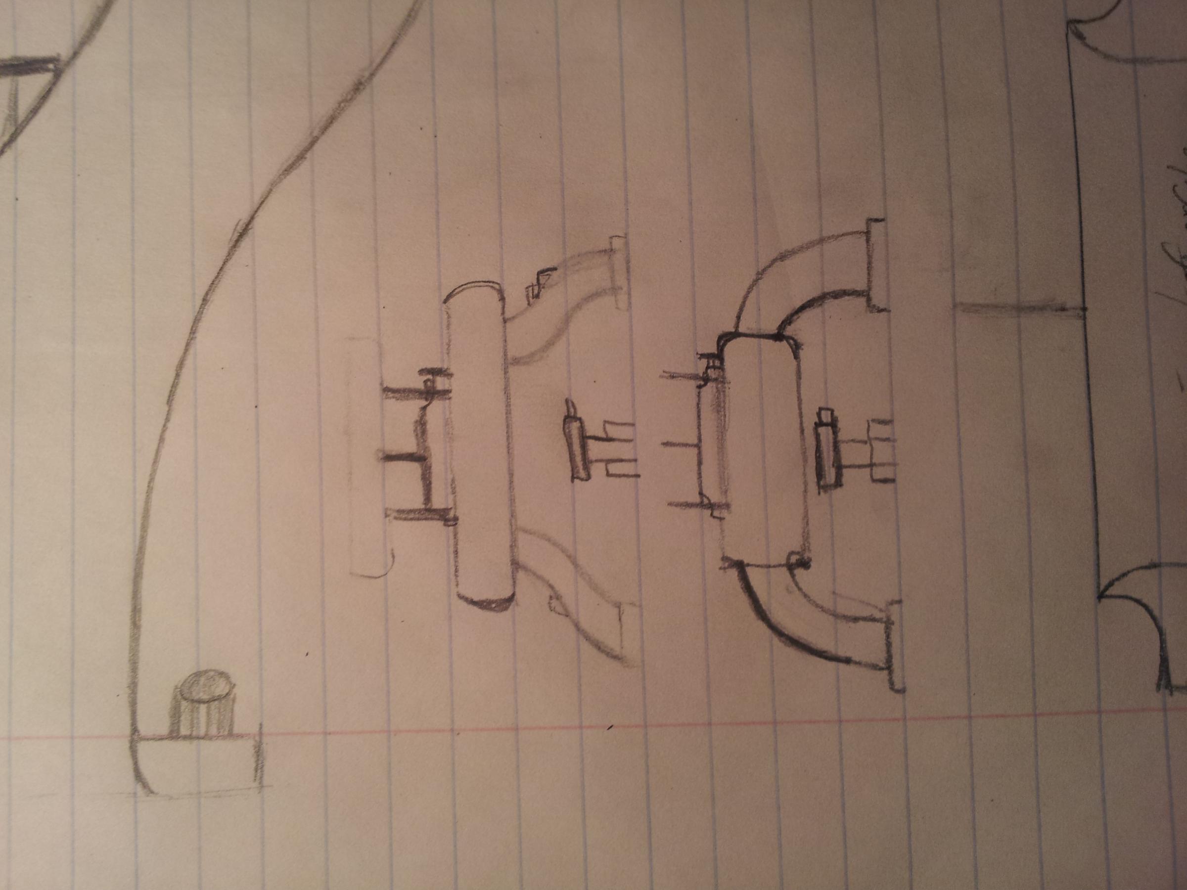

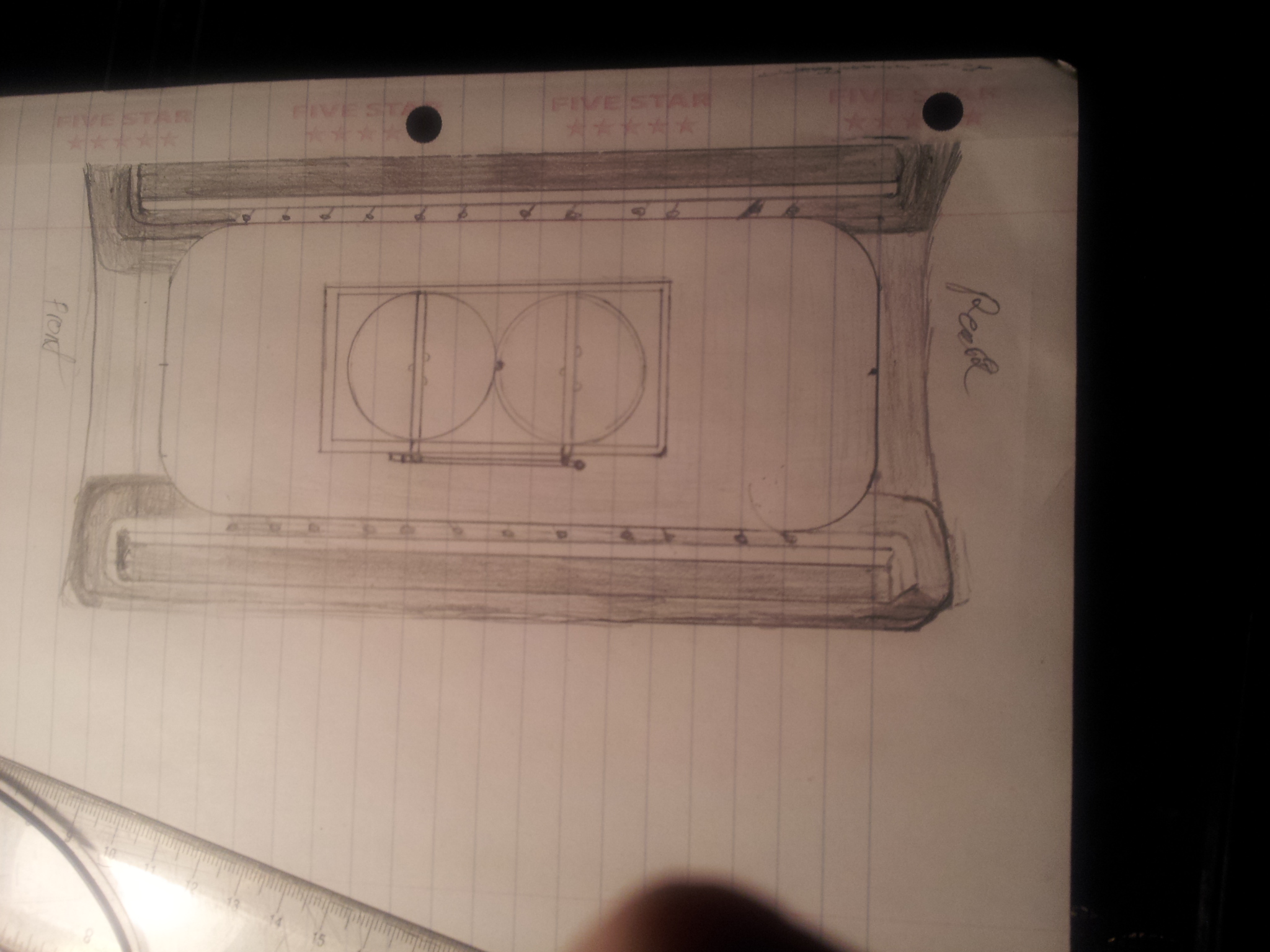

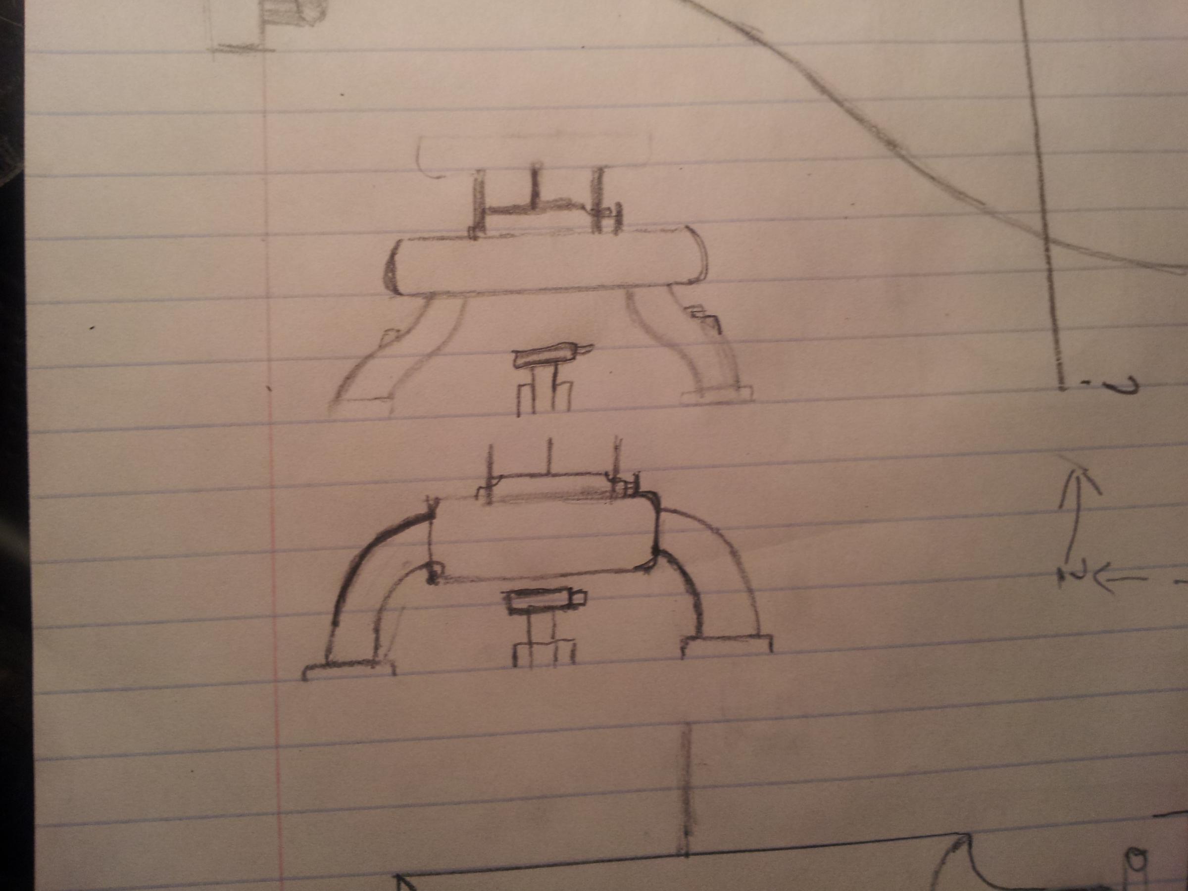

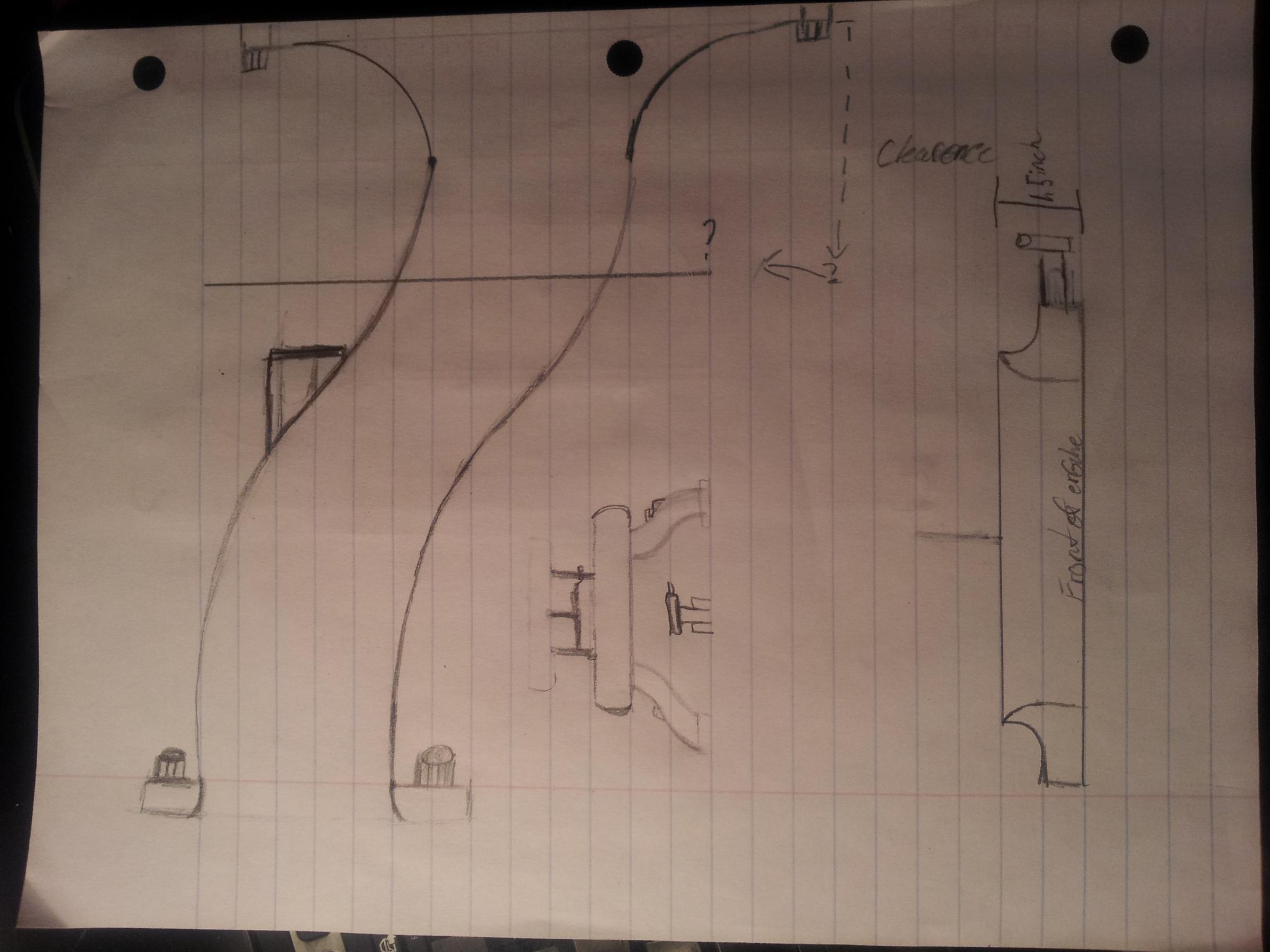

Old Feb 10, 2014 | 01:47 AM
  #313
88-xjsv12's Avatar
Joined: Apr 2013
Posts: 250
Likes: 15
From: north east AMERICA
Been away for awhile I couldnt get my original drawings up so i made a quick sketch of the simple ones . Sorry if they're not sized right I'm no artist
Attached Thumbnails so has anyone actually made 500bhp from a v12 pre.he-20140210_022945.jpg   so has anyone actually made 500bhp from a v12 pre.he-20140210_022957.jpg   so has anyone actually made 500bhp from a v12 pre.he-20140210_023012.jpg   so has anyone actually made 500bhp from a v12 pre.he-20140210_023018.jpg   so has anyone actually made 500bhp from a v12 pre.he-20140210_023650.jpg
so has anyone actually made 500bhp from a v12 pre.he-20140210_023654.jpg   so has anyone actually made 500bhp from a v12 pre.he-20140210_023026.jpg   so has anyone actually made 500bhp from a v12 pre.he-20140210_023700.jpg   so has anyone actually made 500bhp from a v12 pre.he-img_20140210_011657.jpg

I would put oversized throttle bodys on it or three stock ones inline if your on a budget. I figure two 91 mm throttle bodys? Not positive of the stock size but I believe an increase of 25% in size would be key.

I wonder if we are totally missing the point here; the std set up is the best production compromise for a road car. Easy starting smooth low tickover, instant pickup and more than adequate power delivery with as good economy as could be achieved at the time.Also remember the ever tightening emissions issues.
It is a total package.
Yes you can improve the (older) standard set up with modern injection/ electronics.
You want more power then be prepared to make make sacrifices in other areas. More power requires more fuel and more air, it needs to be able to get in and get out, of course it will cost more to do this than a 4, 6 or V8 because you have more of everything in a v12. you are wasting your time if you think that bigger throttles or larger inlets will do much without the matching larger head ports and valves, maybe with a change of cams and a different map.
You need a total package again, if its a bit more you need a bit more in all areas to maximise things. If you require a considerable increase then be prepared to make major changes in all areas, fairly obvious but often there is little difference in cost between going 1/2 way to going the whole hog, If you have to buy new pistons and liners then the cost has little to do with the size; it has to do with what is available. In Europe its 96 mm bore off the self. Cheapest crank may well be an offset ground unit starting at either 70 or 78mm. Rods will therefore be Chevy based most likely at 6" and everything follows on from there.
Might be different in the USA or Australia. What I am certain of is that just the changing of an inlet set up will be a waste of time and money, bringing disappointing results. You need a package.
