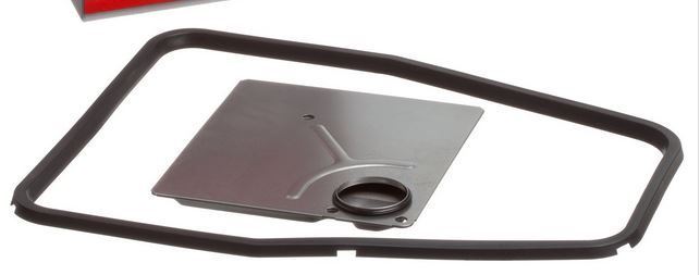

I just received my filter/gasket kit from Rockauto for my 4.0 '95 XJS...it didn't fit! The pan gasket fits perfectly, but the filter has a 2 1/2" 'pick up' pipe that doesn't fit inside my pan. The orginal has a side port but I can't find that model anywhere. I have removed the pick up pipe but am concerned the distance between the pipe flange (about 2mm below the filter surface) and the pan will not allow sufficient flow. Has anyone else come across this? Is there sufficient gap between the filter and the pan for sufficient flow? any thoughts appreciated.

You need this one, so for a shallow transmission pan. Partnr: JLM 664

I ordered the Beck/Arnley (0440229) filter and gasket. The correct gasket but the filter is for the deep pan. I chopped off the 2 1/2 inch pick up pipe, then used a magnet and brake cleaner to remove any metal filings. I couldn't remove the pipe collar without making a huge mess, so it protrudes about 2mm below the pan. I'm hoping there's sufficient clearance to the bottom of the pan to allow unrestricted flow.

I wonder if the 0440216 would work? The application is a 1988 XJ6. That has the 4HP22 transmission instead of the 4HP24, but as far as I know the only major difference is the electronic controls of the 4HP24.
This one shows a really short pickup tube. Is that what you need? It's ATP B80
https://www.rockauto.com/en/moreinfo...t=8600&jsn=563
Other option is a Wix 58962. You can get that locally at Autovalue for about $42.
