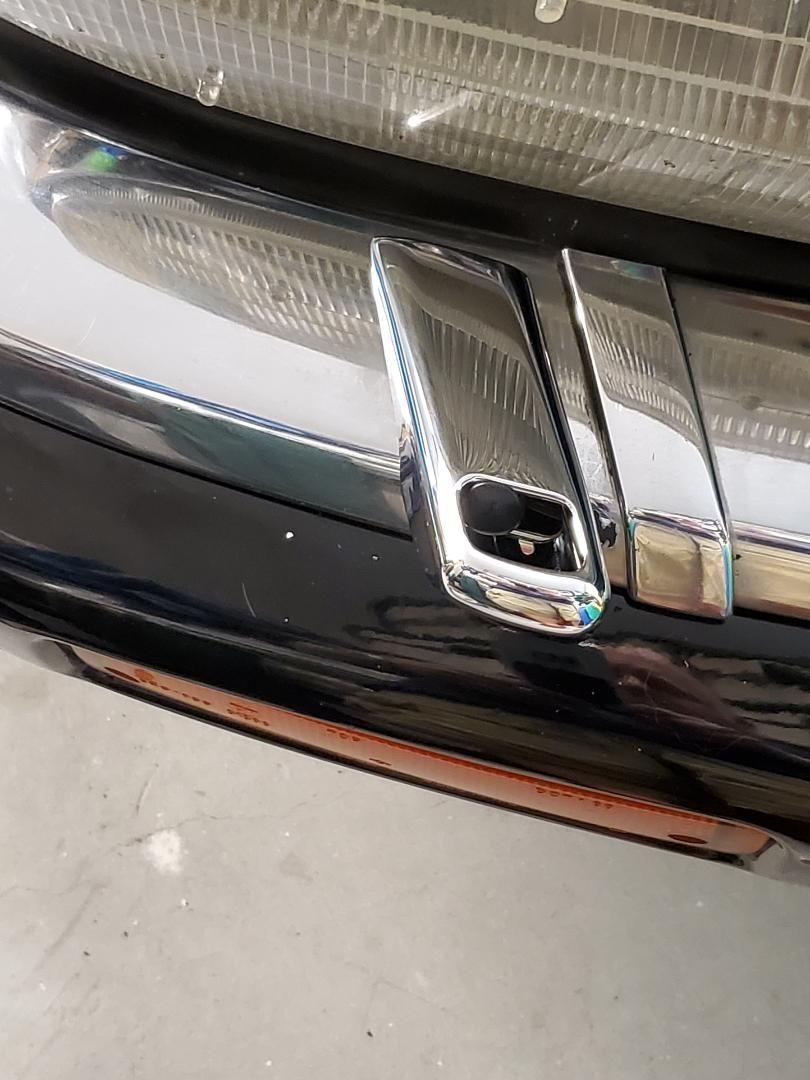

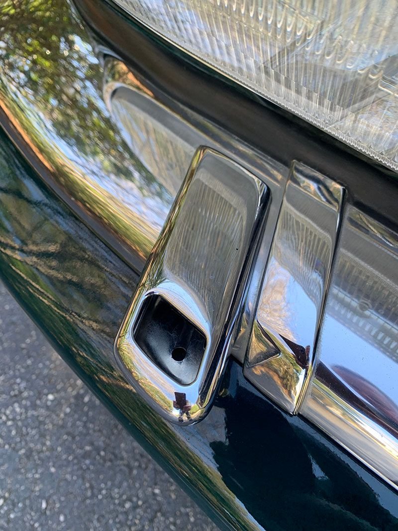

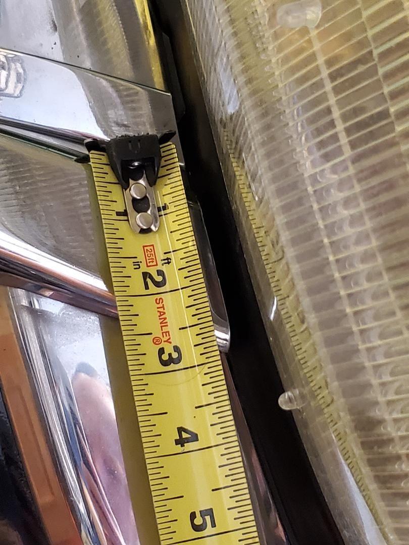

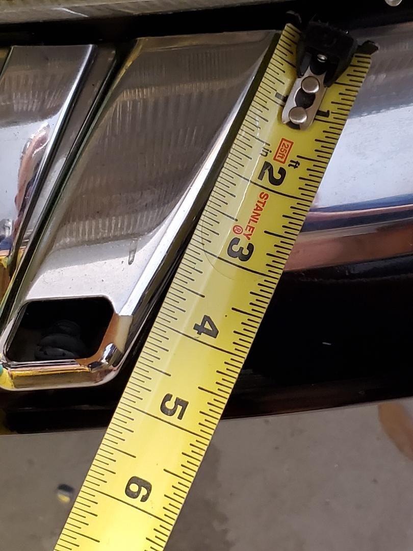

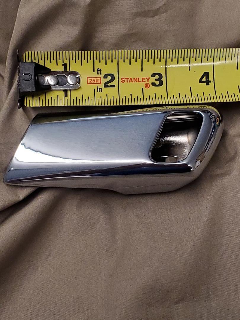

My 96 XJS 4.0L still has the original driver side (Left) washer jet cover. This is a chromed PLASTIC piece. It is slightly less than 5" long and about 2 1/2" wide at the end closest to the car. It is exactly the depth of the chrome piece on the bumper (again, this is PLASTIC).
I had ben searching for the passenger side piece, and was directed to a supplier. (I am purposely not mentioning the name of the company. They are very reputable and this is a quality part) I contacted them and ordered what I believed to be the correct part (DAC 7928) back in September. On the advice of another owner, I decided to order the piece for the driver side (DAC 7927) because the parts (although supposedly OEM parts) were not an exact match to the original. I was also told there might be a long wait time for the parts, but they were available. I ordered both Left and Right covers. Last week, after many months of waiting, The supplier informed me that the Driver side (Left, DAC 7927) was no longer available as Jaguar was no longer manufacturing the part (Not all that strange as I had previously been informed by several people that both parts had been discontinued long ago).

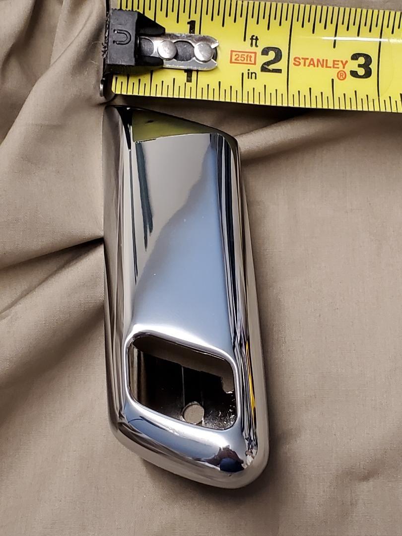

I received the replacement for the Passenger (right) side (DAC 7928) yesterday. It is a chromed METAL part. I thought, "Great, this is better and will last longer than the plastic). however, it is about a full inch shorter than the plastic piece, meaning it does not extend all the way back to the chrome trim, and it is narrower, meaning the washer jet does not fit inside.
I am not really concerned about the jets functioning/ I keep it garaged and don't drive unless the weather is decent, so this is purely cosmetic. I have been searching for the part for over two years. It is odd, because when I started searching, I was able to located the Driver's side easily (the part I already had), but not the passenger side. Now I am told the Passenger side is available, but not the Driver side. I only saw one other post where someone mentioned the fact that the cover is plastic, not metal. (Is my "original" plastic part not so original after all?) I can't figure out how to remove it. There are three holes om the bottom, one large center hole and two smaller holes, one on either side. I did see someone mention there being three "alignment holes." I don't want to break it trying to pry it off. On the new part, there is only one hole rather than three. I have found what appear to be used Driver side parts, now upwards of $100. I am not sure whether they match the new part I ordered or what I believe to be the original part on the car. There is no mounting bracket on the passenger side, and I cannot tell what type of bracket is on the Driver side without removing (and probably damaging) the plastic part.
All that being said, I am hoping for some advice:
1. Was the original piece metal or plastic? The longer plastic part looks like a better fit.
2. Should I just remove the plastic piece, bite the bullet, and purchase a metal piece that matches the new part?
3. How are these attached / removed from the bumper? I was advised to just epoxy them, but I believe there is / was a mechanical fastener or clip.
4. Were the older XJS models equipped with the headlamp washers, and am I mixing and matching model years?
Everything else on the vehicle is original (except the radio), although by no means pristine. Do I go for original and keep searching or do I compromise and either cover up the holes or use the parts that are close, but not exact?
Photos attached of both covers with the passenger side sitting, but not affixed to the bumper
Original on Driver side - is the same depth as chrome. This is a plastic part
Original is about 5" deep
Original is about 2 1/2 wide at the base
Replacement is not the same depth as chrome. This is a metal part
Replacement Is only slightly more than 4" deep
Replacement is only about 2" wide at the base
Thoughts?

The metal parts are for earlier cars, up to VIN 188104. The later facelift cars (roughly 1993 and onward) are originally plastic and are part number LHC7055AA for the left and LHC7054AA for the right. The washer jets underneath are different also between the early and late.
The plastic ones are screwed from underneath the chrome strip on the bumper.
