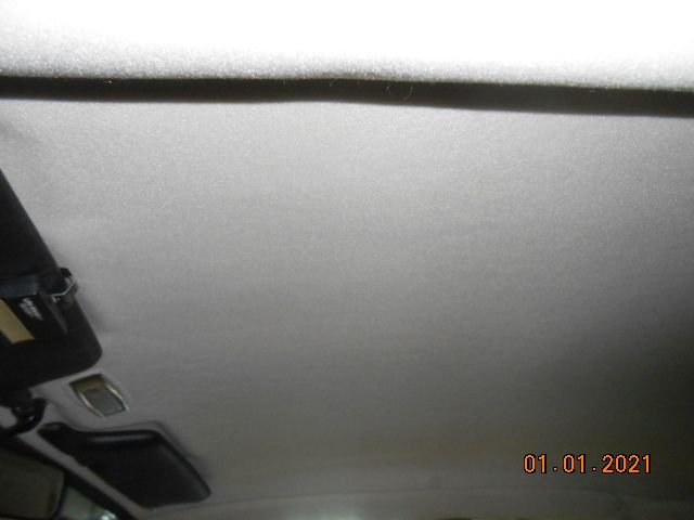

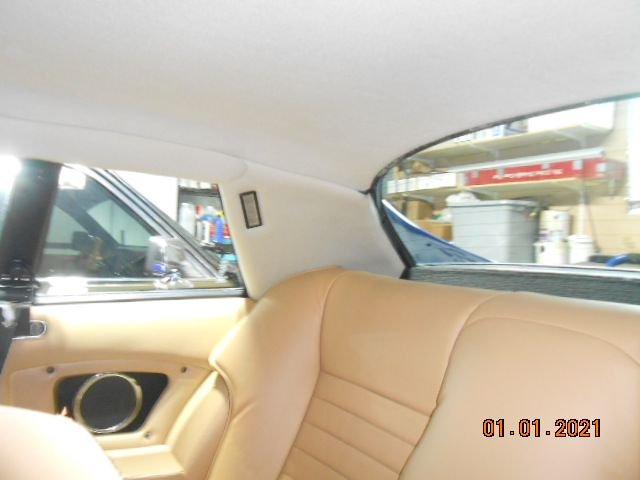

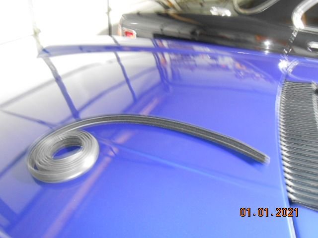

As promised; Pics
headliner installed
headliner installed
Glass run channel from Woollies in the UK SKU #319
