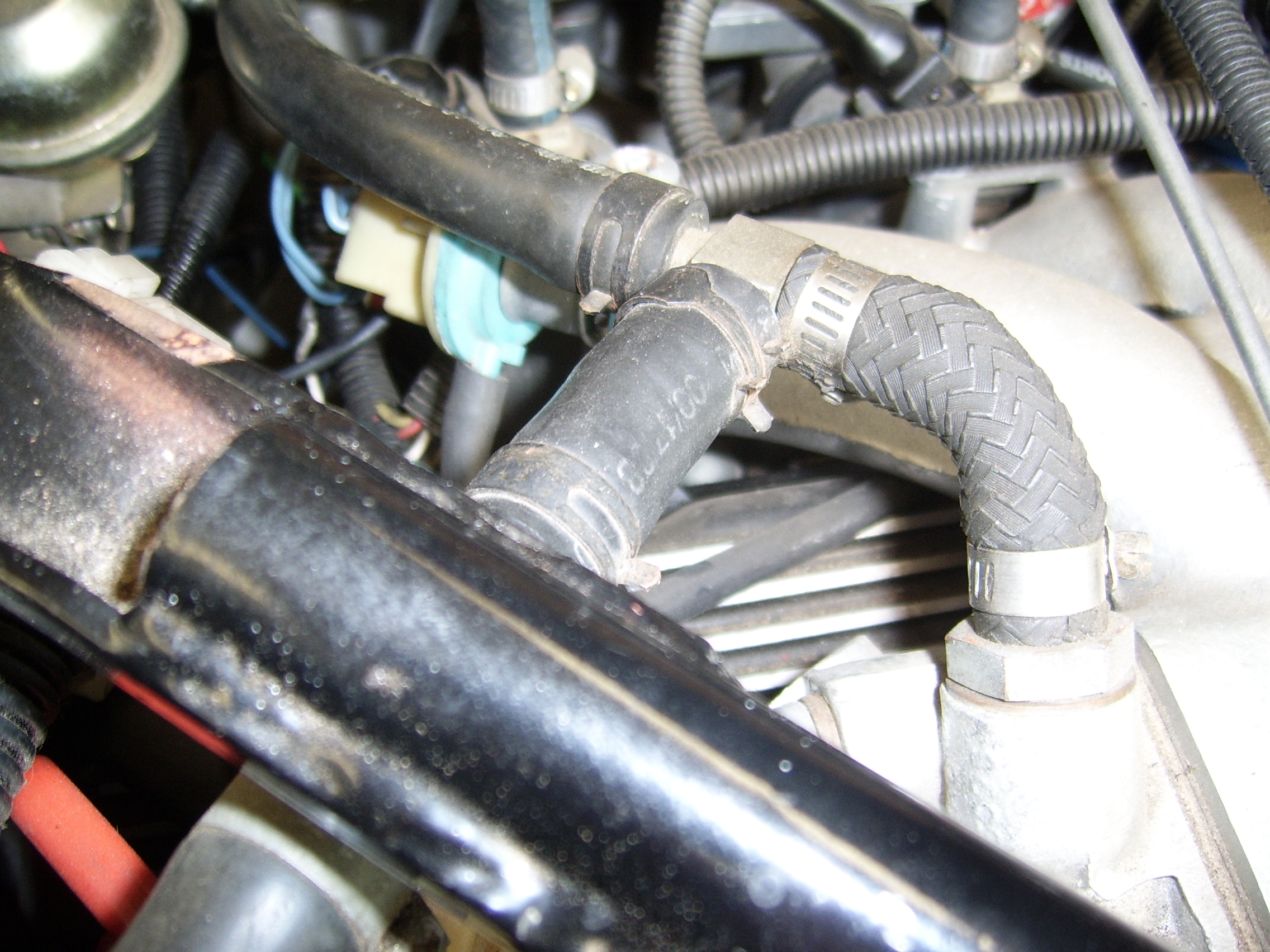

Just to confirm I was not going more carzy that normal, I found a snap of that Blue/White valve on my car.

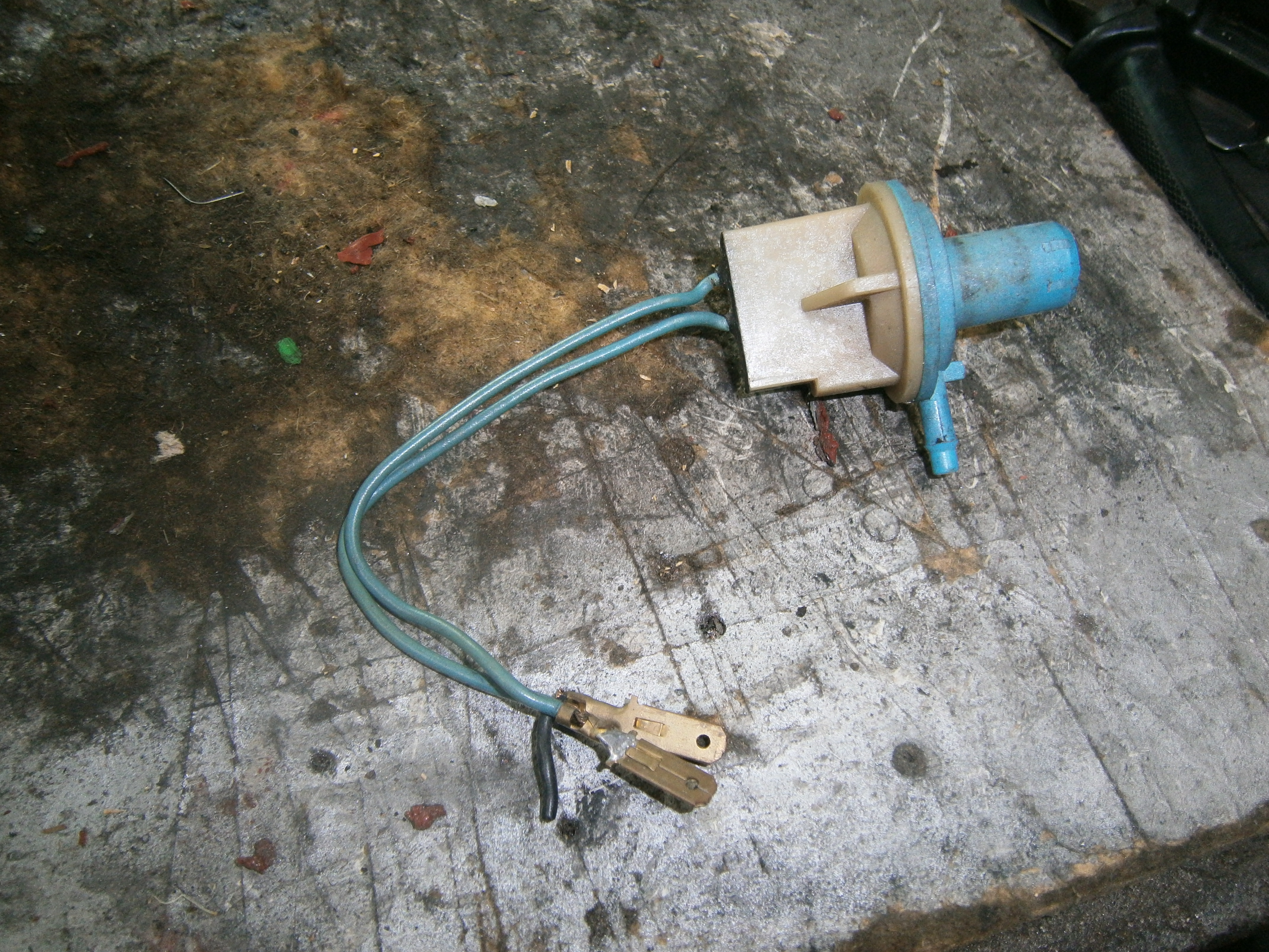

Originally Posted by darrhel
Greetings
tested the vac on the throttle switch the other day and its switching at 20mm hg....is this the correct setting...?
found something similar on the net, looks like it may do the job, mine has not given up the ghost yet...!....other listings for this come up as a Harley Davidson part...?
https://www.amazon.com/Standard-Prod...988850&sr=1-23
all good
Darren
That 20mm sounds around the mark.
Here is the snap I found of this Blue/White valve, BUT, I cannot find the part number.
