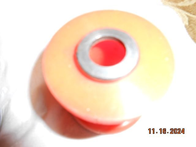

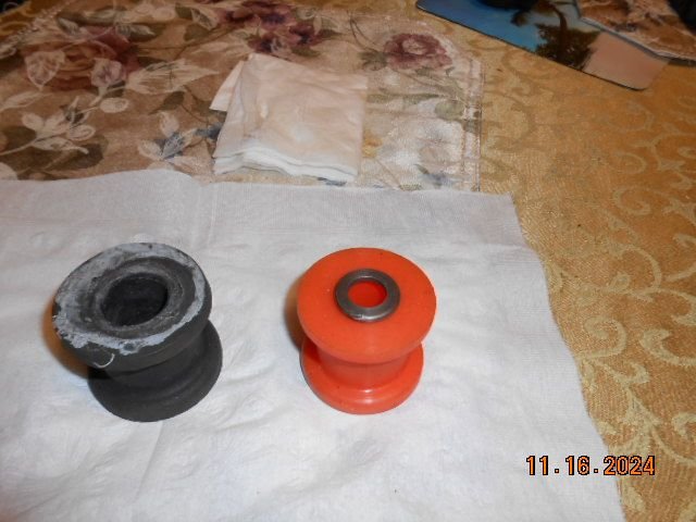

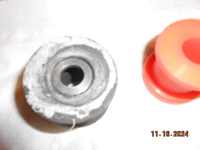

Not giving up, I went through some spares I had put in my shed 2-3 years ago and I found the special washer #28.
Happily I went back into my garage and found the following.
The special washer fits and slides in the hole of the old bushing.
The hole of the new poly bushing is smaller so I have to force the special washer inside. I fits so tight that it will not move unless I apply a lot of force to it.
What is the best fix? Does the washer have to slide up and down in the bushing?
Here are some pics.
old bushing vs new poly bushing
special donut washer #28 slides into the old bushing
special donut washer #28 sits on the top of the new poly bushing
special donut washer #28 sits on the top of the new poly bushing.
I can force it in.

Old Nov 18, 2024 | 04:17 AM
Posts: 28,772
Likes: 11,260
Goodo,
That special washer is designed as a friction force fit inside the cotton reel, thus STOPPING the rear of the trans from bouncing around. Like a suspension shock absorber.
They are tight by design.
Push it in with the space sleeve, and let it be.
I only use Poly cotton reels, so have zero idea of fit in the rubber units.
Old Nov 18, 2024 | 05:19 AM
sanchez's Avatar
Joined: Jun 2015
Posts: 1,514
Likes: 687
Grant: Thank you. I will install as you recommend. I guess over time the special washer will do what it was intended to do.
