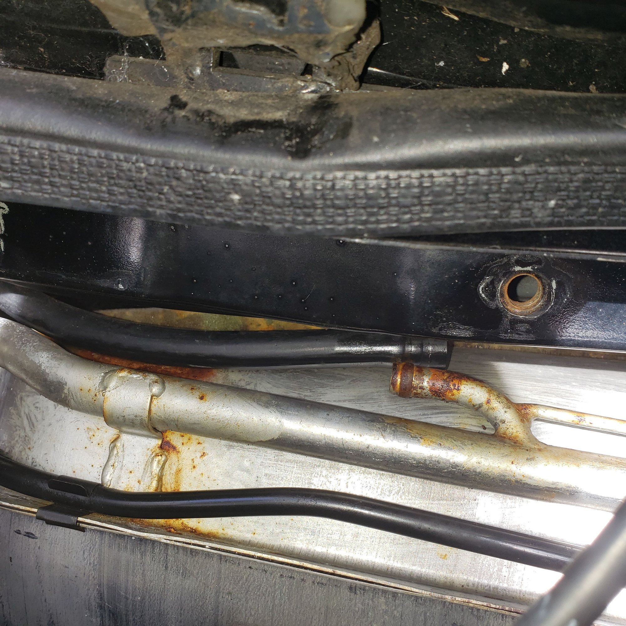

1st drive i fill the car up and im getting high from gas fumes. Fuel gauge was not reading correctly and i decide to replace the sending unit and discover the PO evidently had a problem with the tank making pounding noises because of a failed Rochester valve at the charcoal canister and he decided to pull the neck overfill hose off the top of the tank. Again ( I've been broke but I think I would replace the Rochester valve or at least pull the hose at the charcoal cannister instead of filling the boot up with fresh gas fumes where the battery and brake lights live)

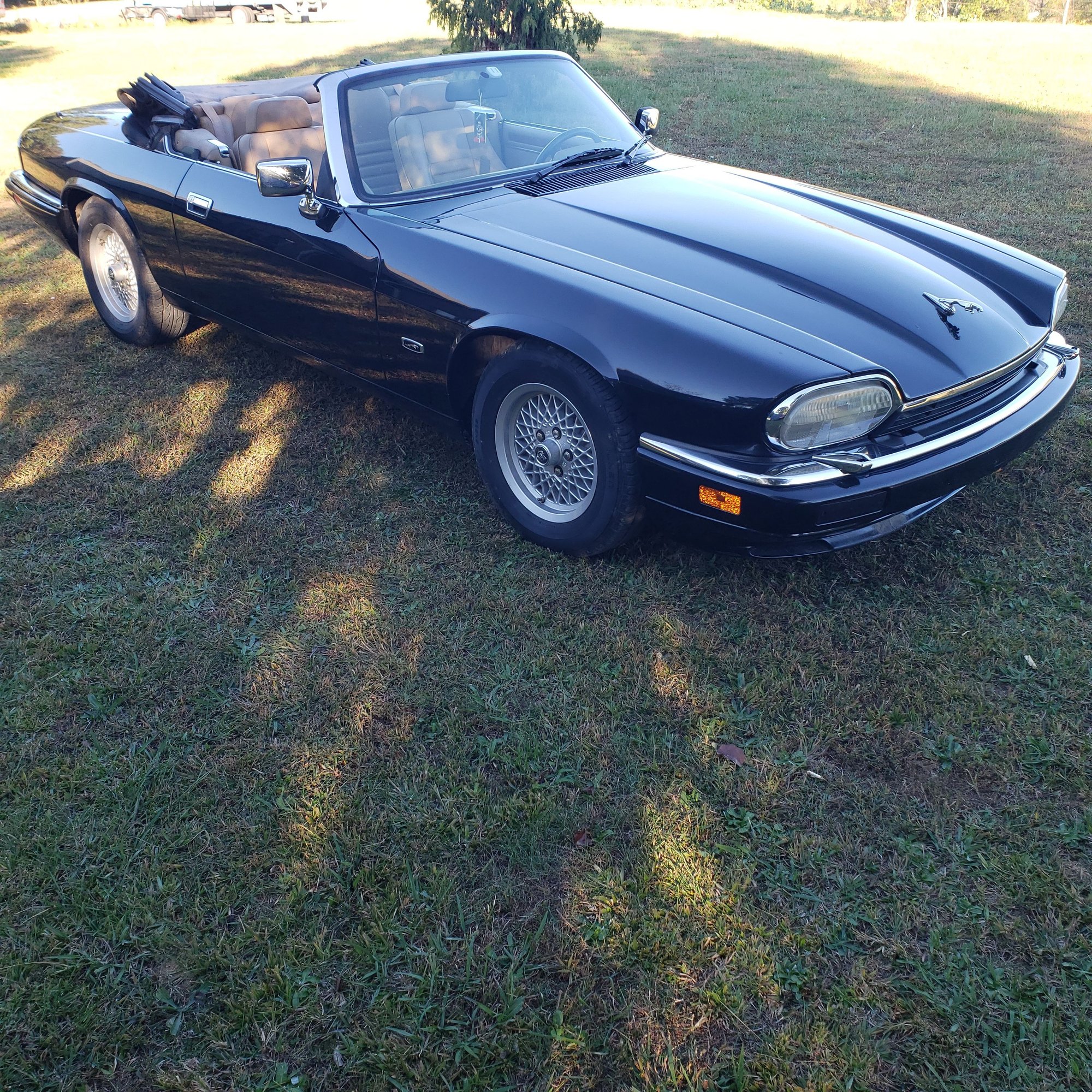

Good luck un-effing what the PO did. Just wanted to say on the outside, from that picture you posted, it's in wonderful shape! Very jealous.
