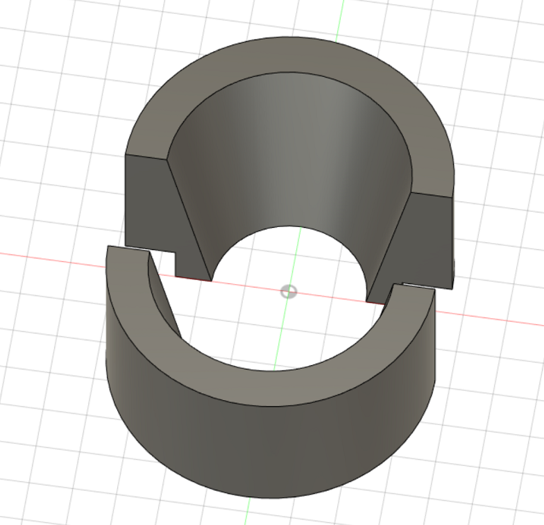

You forgot to mention suitable fat sockets and a large rubber mallet. I also printed an 'installation cone' - it did not survive but it helped get the job done - did it from underneath the mount - made a royal mess of the paint job on the mount
