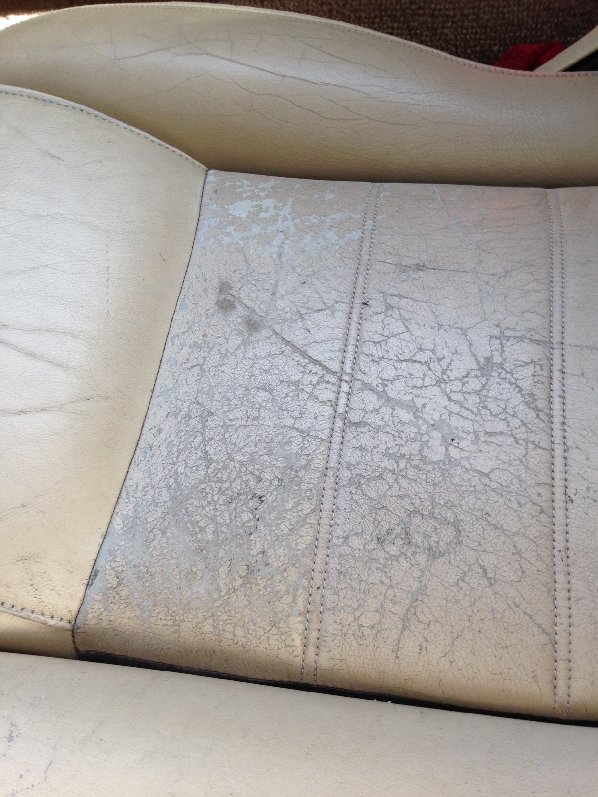

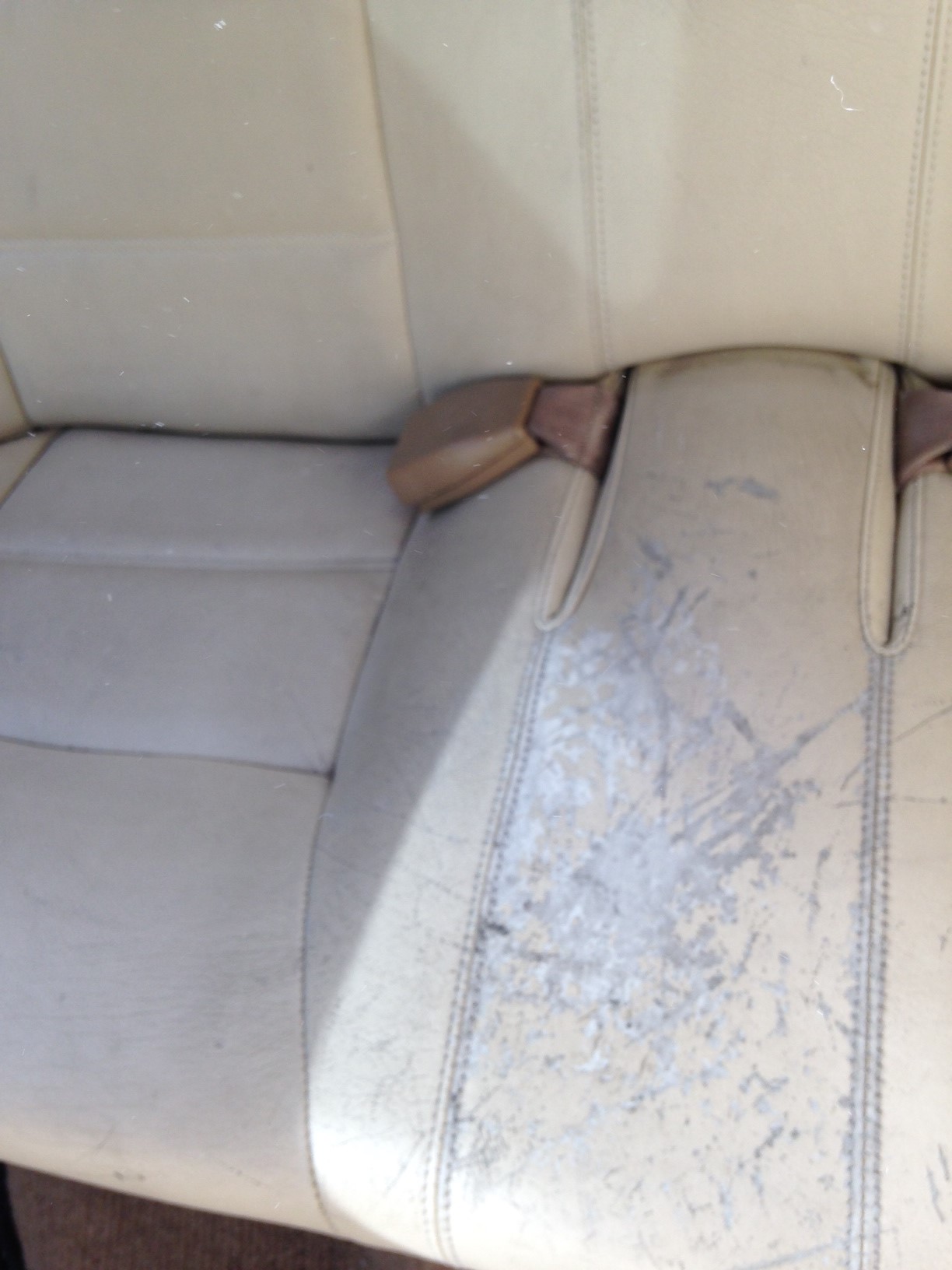

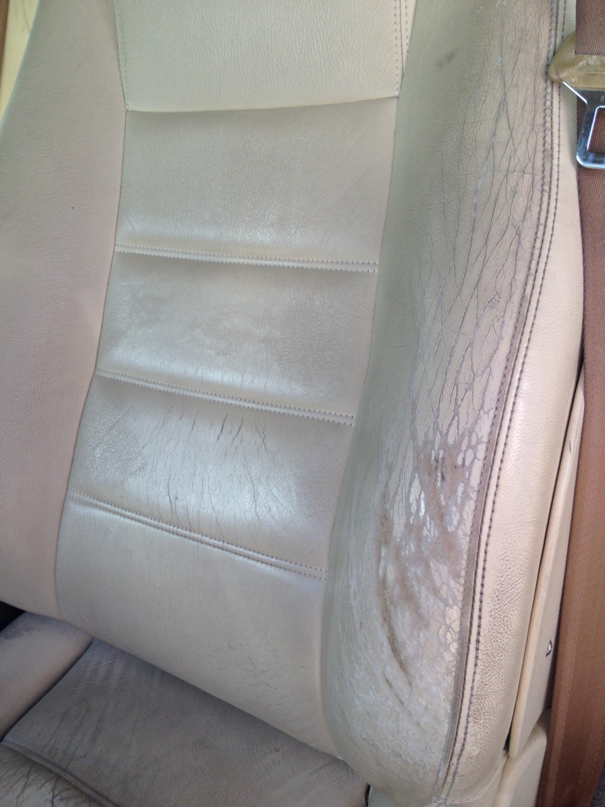

I have a question for anyone who knows more about automotive upholstery than me, which is to say for anyone who knows anything about automotive upholstery:
Are my seats worth saving? Can I restore the leather using Leatherique or some other product? Can I re-dye the worn areas?
I've attached pictures of my driver's seat and passenger seat, which I guess are just damaged from normal wear and neglect. The back seat is where the previous owner's dog apparently liked to scratch.

You can save them. Good cleaning with leather care and also can be redyed. See a local trim shop and see what they advise. Might be able to sell you some decent coloring.

Your seats can be saved. Good cleaning, soaking with the Letherique Rejuv oil and a re-dye - either Leatherique dye or dye sold by World Upholstery in California. I've used products from both outfits and give them both a "Thumbs Up".

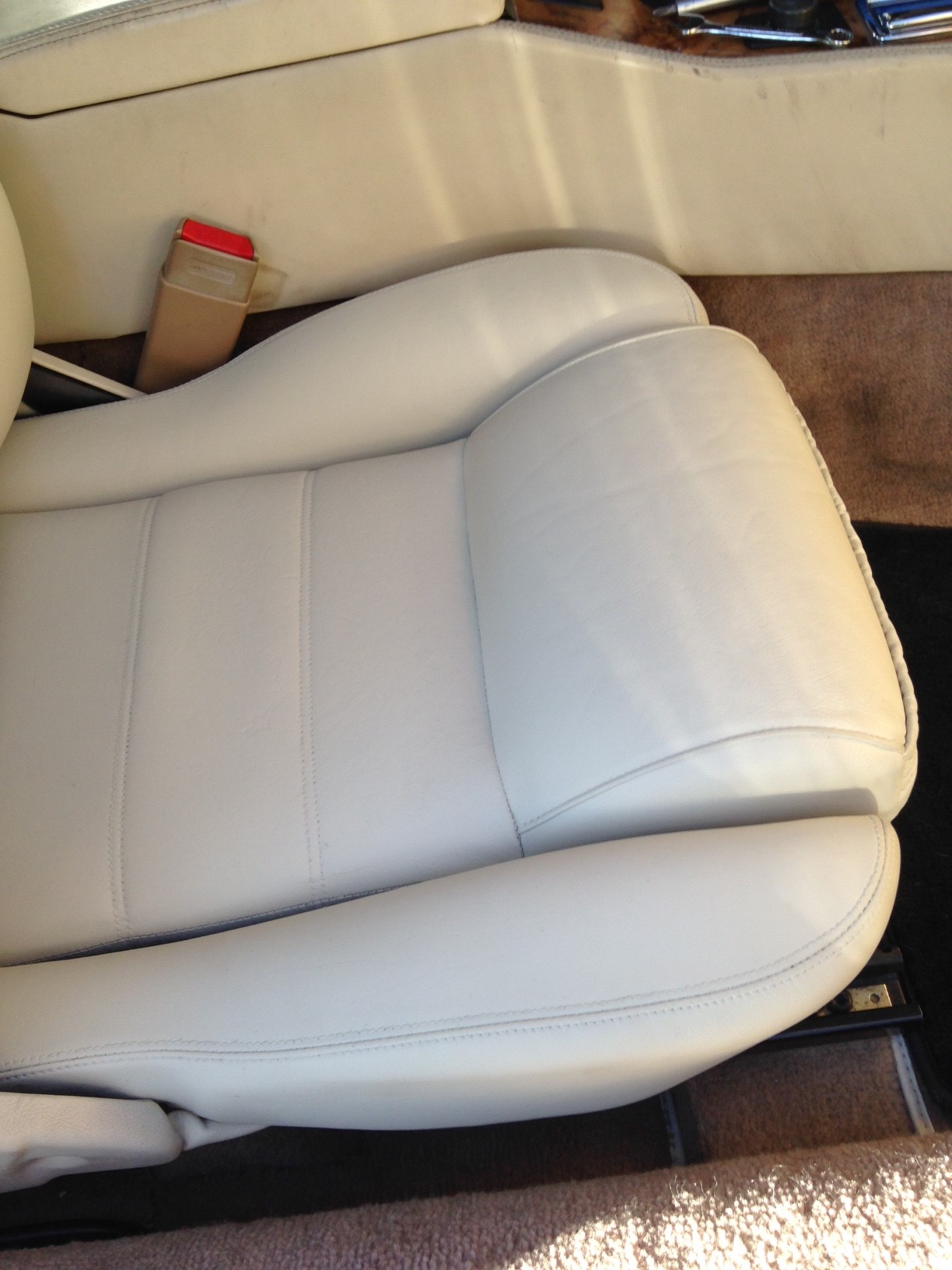

Thank you, Paul and Tyran!

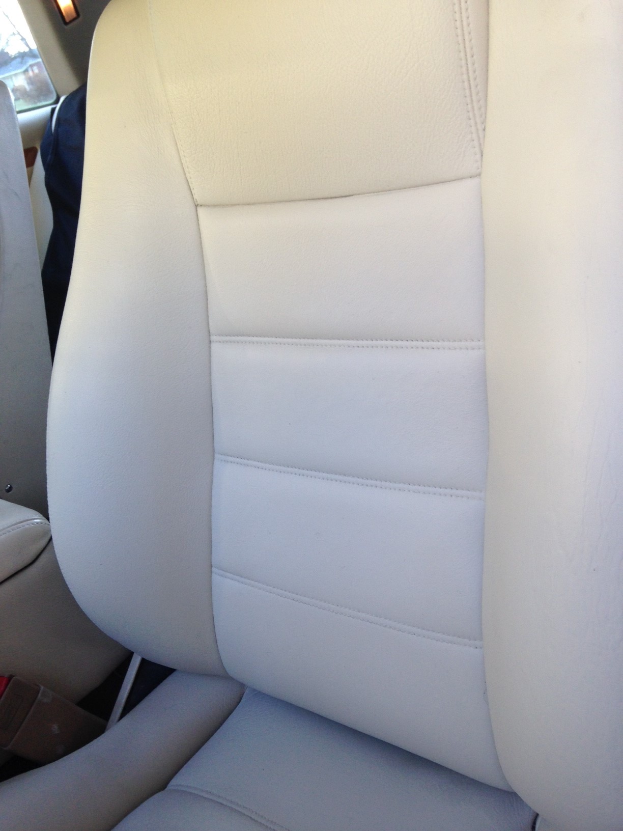

I got the Car Restoration Interior Bundle How To Restore A Leather Car Interior from Furniture Clinic. I bought the large size, which was supposed to be enough to cover an entire interior, but I needed to get another ~$100 worth of supplies before I was done. Even then, I ran out of finish and airbrush propellant.

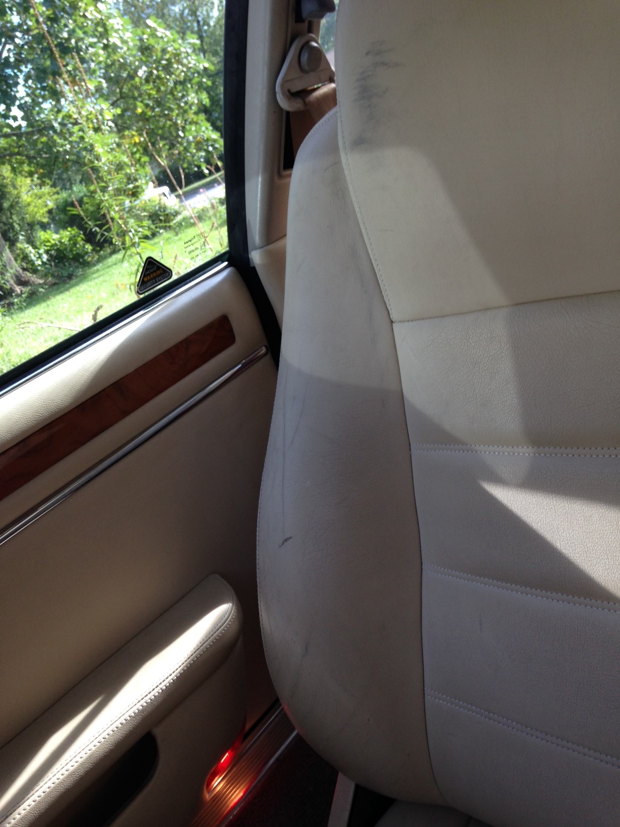

It was a lot of work. I'd estimate 15 hours total for the back seat and 10-12 hours for each of the front seats. The results look spectacular. The seats look brand new. If you look closely, you can see where the cracks and missing dye used to be, and there's still a small tear in a seam on the driver's seat. There's a smudge of grease on the driver's seat in the second picture, which was from re-installing the seat.
Overall, I'm very pleased.

Awesome result!! Worth the hours spent,and cheap as compared to other options. Thanks for taking the time to follow up with the pics, I'd be feeling pretty happy with that result.

The seats do look lighter in color than the rest of the leather. I don't know if that's due to the age of the other leather or if the Furniture Clinic dye is a little too light.
