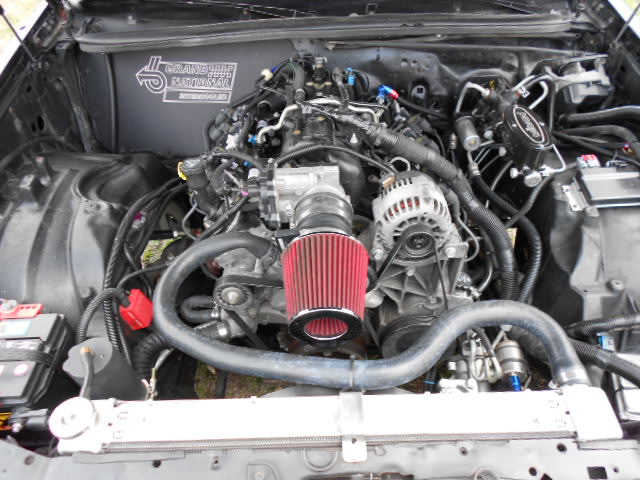

if you have to ask what it costs ,you cant afford it!
nothing gets attention more than saying its a V12 cylinder engine.
and i have a Buick Grand national with an LS3 in it!
Attached Thumbnails V12 group44 heads project-buick-cute-dogs-015.jpg   V12 group44 heads project-buick-cute-dogs-010.jpg

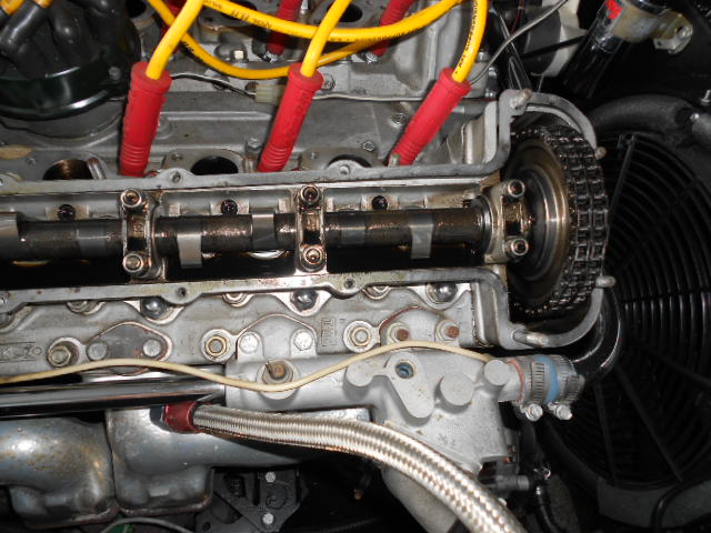

for interests, i bought a set of new 3MM oversize valves for my engine , bought from Lanky in 1994, they were well shaped under the head, and slightly under cut at stem!
single piece forged Stainless steel, probably the best available in 1986/87.
as i remember i had to cut the exhaust smaller about .040 thou. because the inlet and exhaust were close to each other, and stock exhast seat was to small diameter,my seat is at the outer edge of the seat insert, (my heads were 1978 factory, but i can only say i ported and smoothed in areas that seemed proper, and blended the seats and bowls to a smooth flow visual).
cams are Crane regrinds Nitrided, i had them profiled and closest comparision was Porsche 1974 N/A race profile,(ancient tech by todays standards), they run fine 21yrs later , and i used some springs that Lanky sent, shimmed .060.,said be fine for street use!
i removed the cam covers last year,(oil leaks), and cam lobes look like new, along with buckets!
Attached Thumbnails V12 group44 heads project-jag-engine-inside-002.jpg   V12 group44 heads project-jag-engine-inside-005.jpg   V12 group44 heads project-jag-engine-inside-006.jpg
