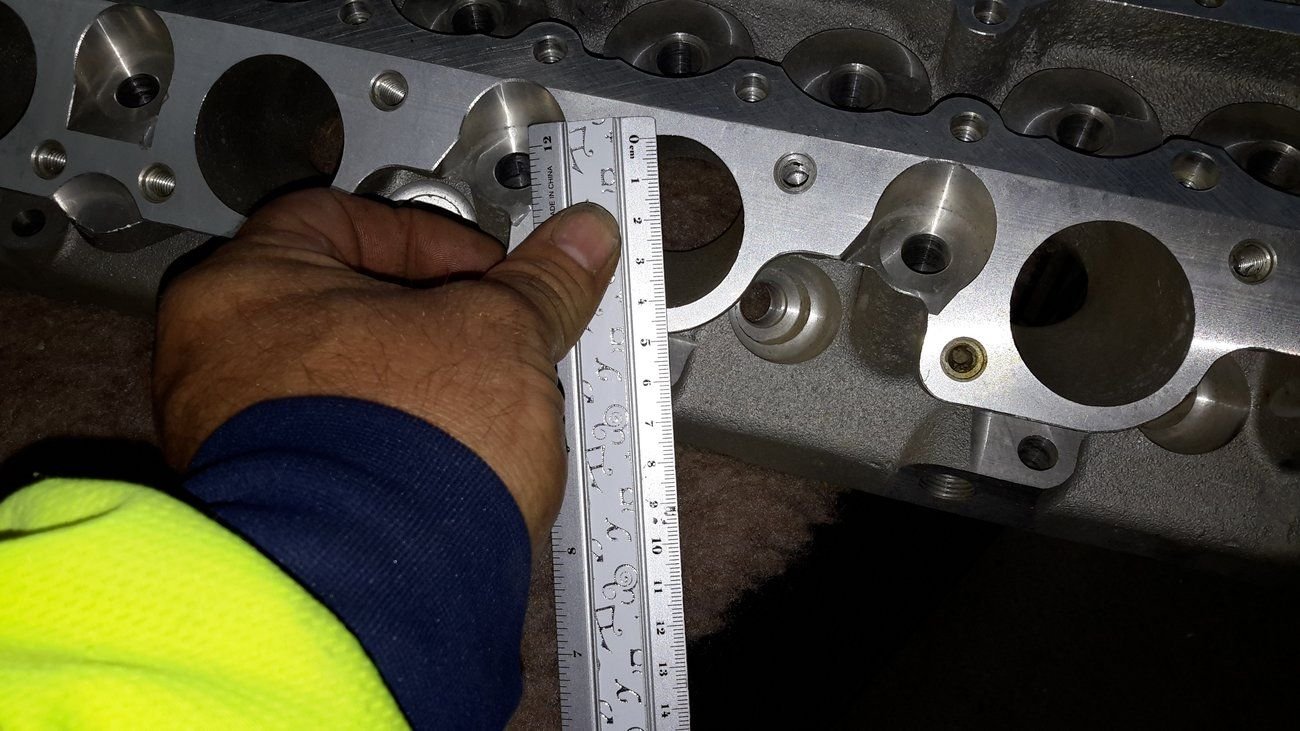

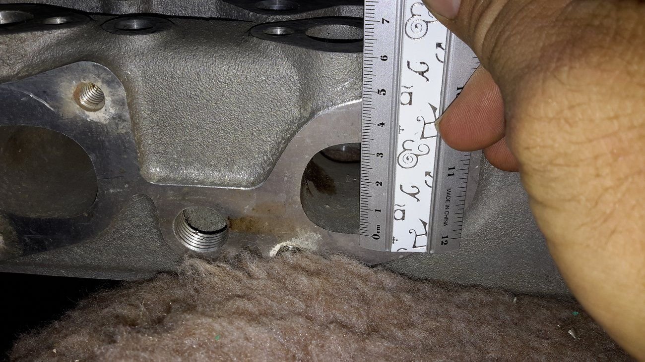

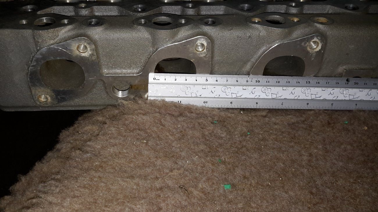

These are original group44 heads unused and not modified in anyway.\
I had them flow tested and they produce 643hp @ 550thou lift
comparison of group44 exhaust
comparison of group44 inlet vs standard pictures from supercharged tr6 just before i bought them from him

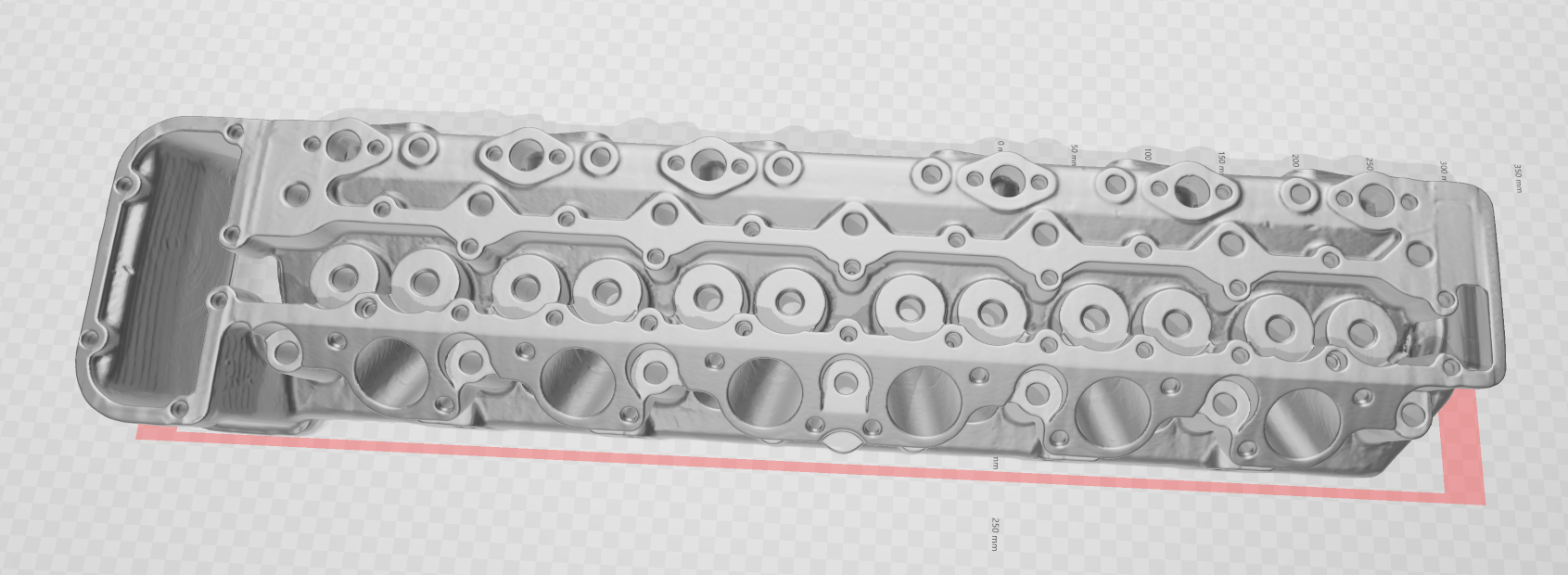

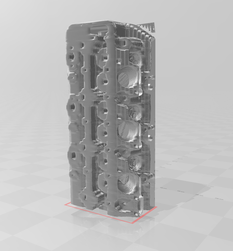

Thank you for your generosity in sharing these Daddycool. Just for a quick show and tell with what can be done with the data:
This was done very using the 3rd data series of 25 images very crudely (not much fiddling with settings) in InVesalius 3 (free) and then cleaned up slightly in Windows 10's built in 3D Builder. (I had no idea what InVersalius was until about 8 hours ago.... last time I made 3D's - just views - out of DICOMMS was for a broken shoulder of mine about 12 years ago with ImageJ, when there wasn't much 3D software, and impressed the hell out of my surgeon with it...) Its so much easier now.
This one sufferers from being made of only 25 slices, and these DICOMM images are only 512x512 pixels anyway. Some newer scanner systems can do 2000ish x 2000ish pixels now. I suspect the longer image series folders will fare better, but turning these into a solid (not surface file) w/o professional software (even with) would be a significant and time consuming reverse engineering challenge. Doing a large format print of it, then cleaning it up for a conventional sand mold might be one way to go, but any would be labor intensive. I can see how this would have been quite an investment to try to get outside professional help doing any reverse engineering. They can be RE'd with fairly consumer SW, and a boatload of time and effort though. I wish it had been more affordable for you (well for anyone/everyone) as I know you would have really liked to have made copies available.

Edit: And 12 hrs later.. the full left head from the 1100 or so slice scan.
https://www.dropbox.com/sh/blht4xg0d...UYw7ISK1a?dl=0

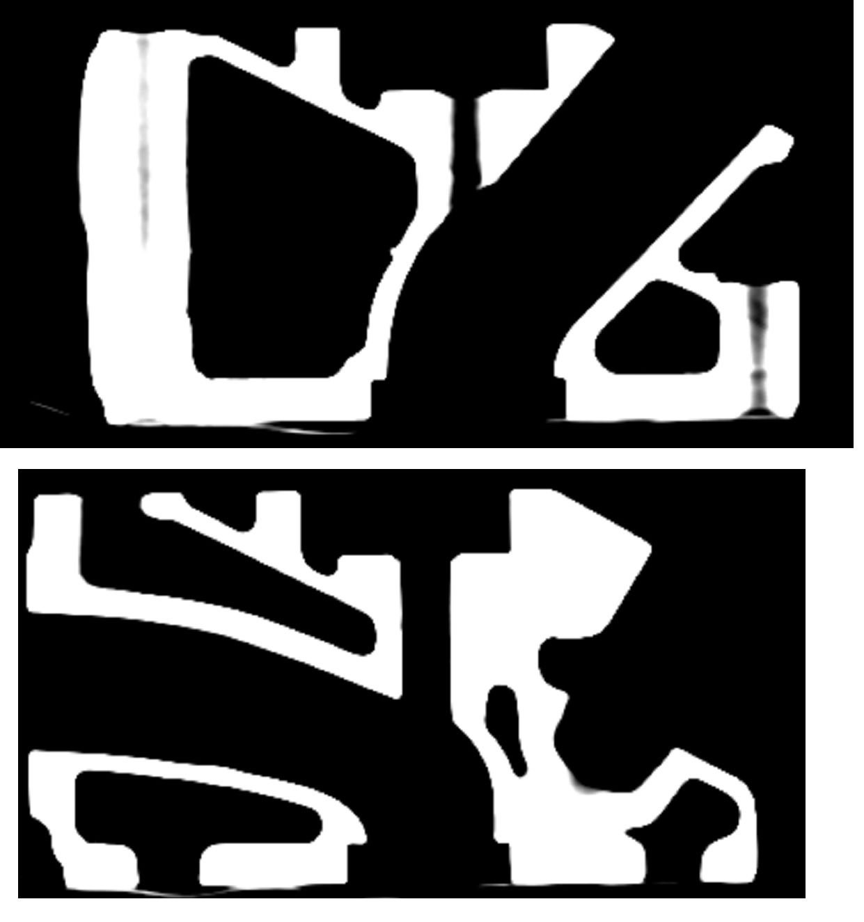

Still occasionally playing with these files but in so doing I though some might be interested in some of the construction. The water-jacket area was clearly made in at least 2 glued together core sections as you can see by the flashing along the split line. And you can see the ribs used to strengthen the deck (11-12mm thick). How this applies to normal flatheads/HE heads IDK.
~Paul K.
