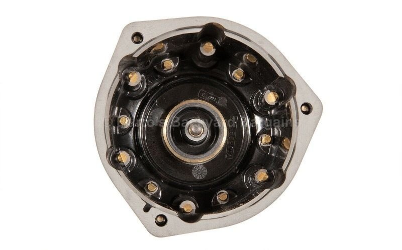

It pays to shop around I guess. Found a Marelli cap being sold by a fellow forum member on Ebay UK, but it sold locally before I could strike a deal. Then found the new old stock one pictured below in Australia. All said and done with shipping and taxes it cost me $251.04 US. You can't complain about that when a cheap aftermarket one is around $100.00.

Doug, you had me worried until I went back and looked at the advertisement for the one I bought. Seems like the real deal as stated.
This is a genuine unused Marelli distributor cap DAC1909 in original box
for a Jaguar XJS 5.3L HE or 6.0L V12 engine from VIN 157116 on
manufactured between 1989 - 96 where fitted.
These distributor caps were also used on the XJ40 6.0L V12 model.
We have had this distributor cap on the shelf for years.
This is not a cheap after market reproduction lightweight one.
Specifications:
Marque: Jaguar
Model: XJS XJ40
Years: 1989 - 1996
Part: Distributor Cap
Manufacturer: Marelli
Part Number: DAC1909
Condition: Excellent unused in original box.
