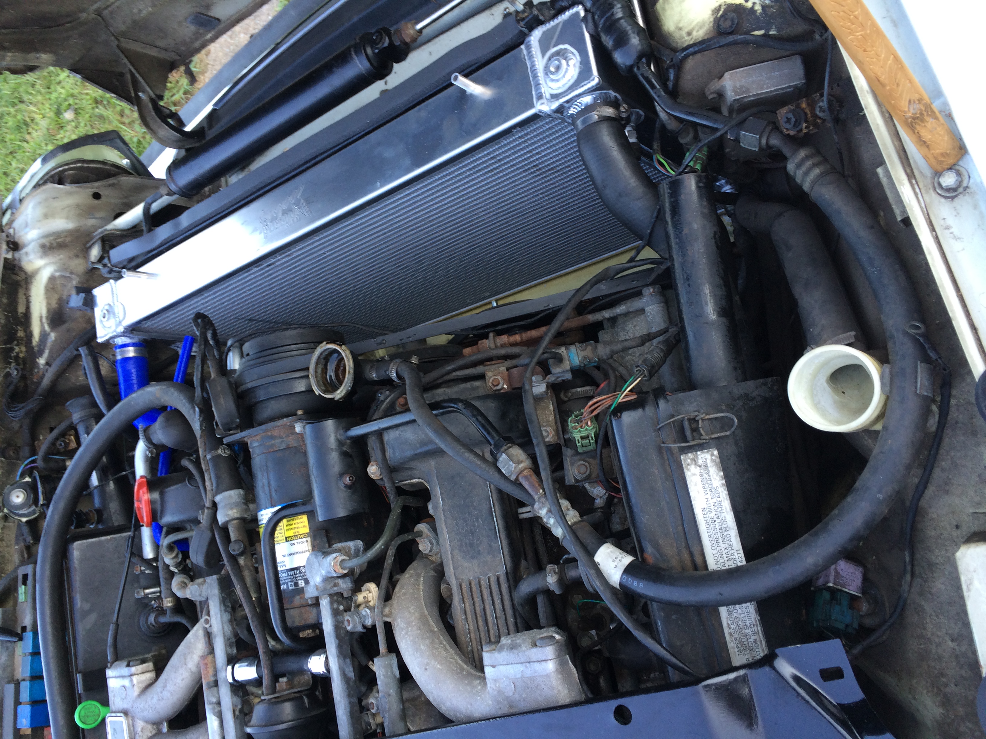

Originally Posted by Stargazer XJS
Just picked her up from the shop with a shiny new aluminium radiator from Wizard Cooling.
Feels great to be back behind the wheel.
Hey, I have done the same...
Mine seems to run nice and cool and warms up faster....
let me know how yours it working out for you
Attached Thumbnails What did you do to or buy for your XJ-S/XJS today?-img_1145.jpg
