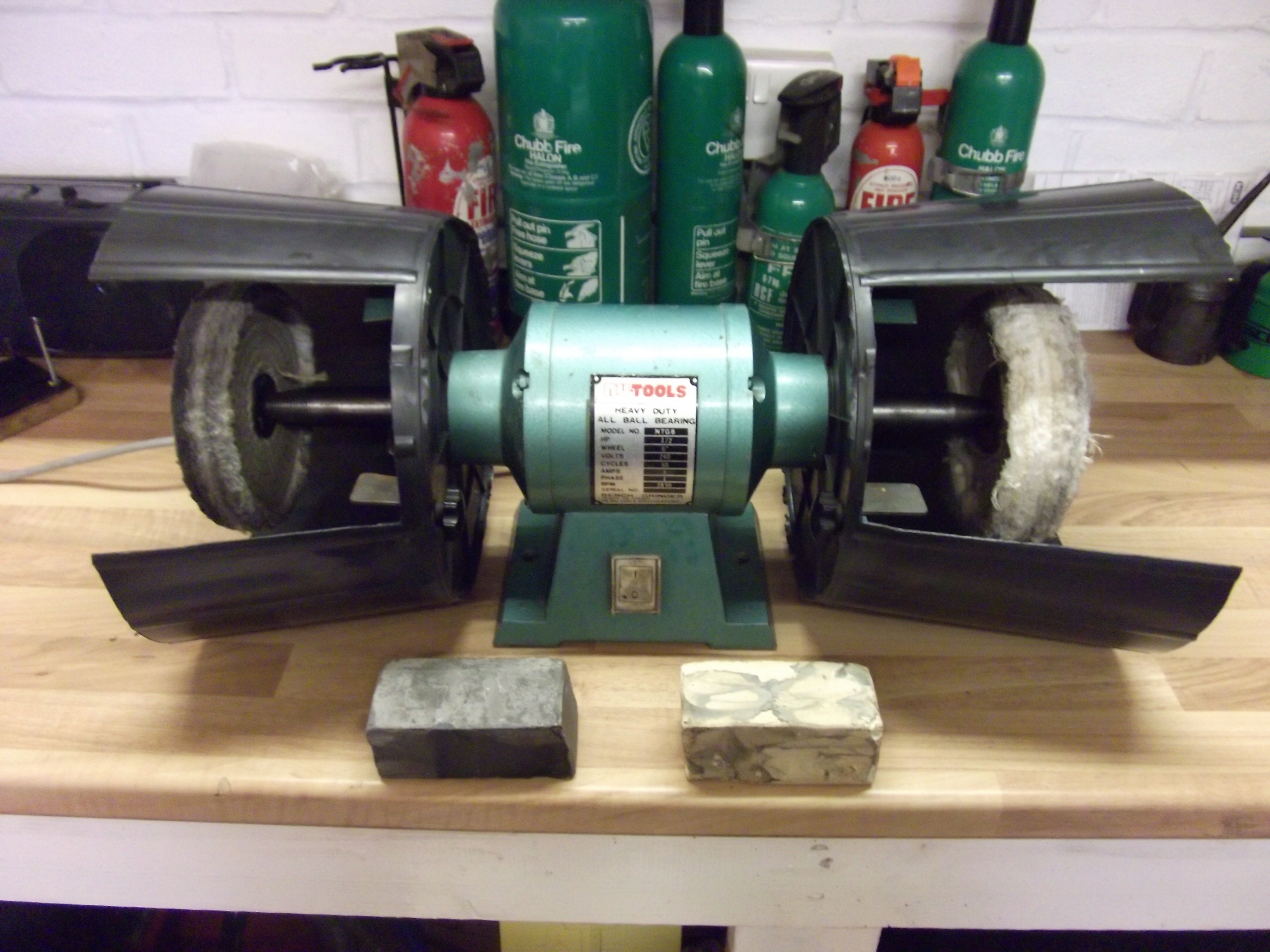

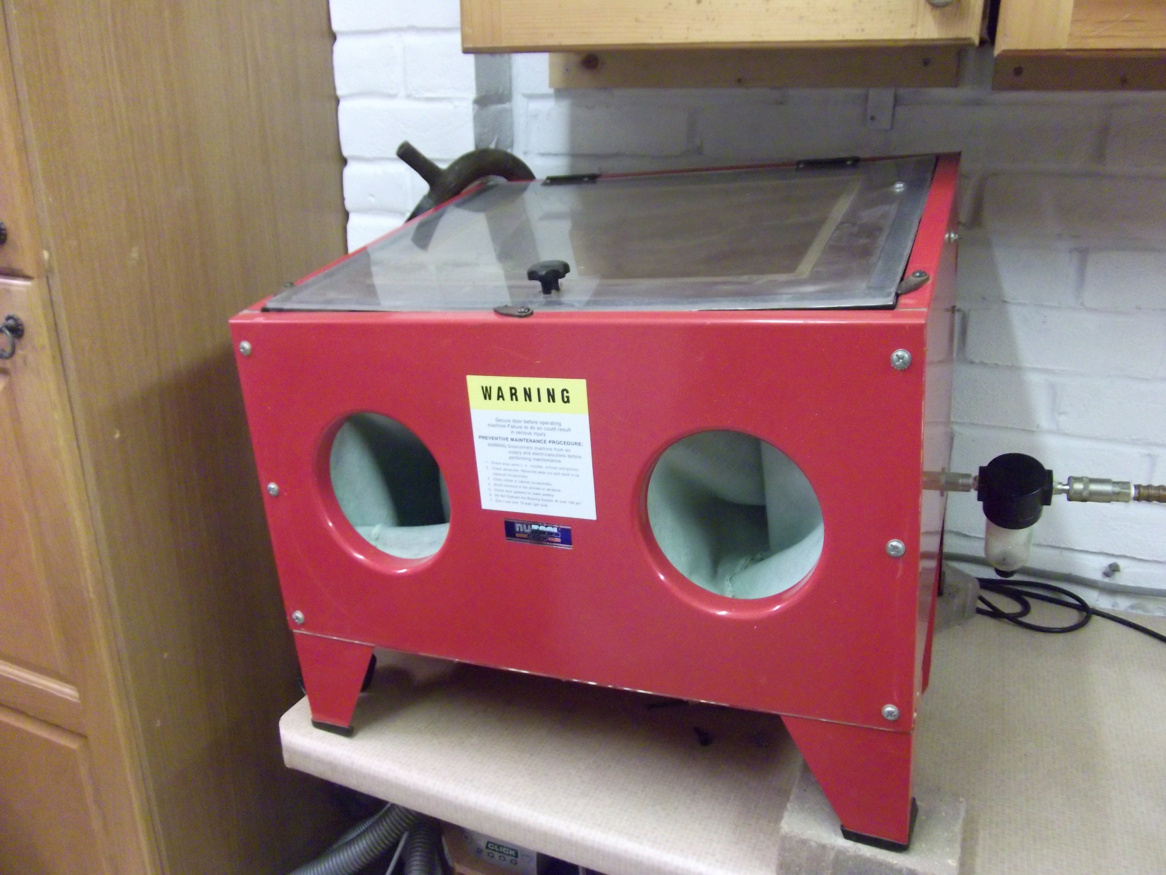

It's not specific to my XJS (although she will benefit from it!) but today I decided to tidy up a few of the items in my garage.
I've been meaning to recommission my bench grinder, bench polisher and sand-blasting cabinet for some time and the rain today gave me an excuse.
So, the bench grinder got a new smooth grinding wheel and a wire brush (I've always found that more useful than using 2 grinding wheels).
The bench polisher is derived from an spare bench grinder that I had. Removal of the outer guards and grinding wheels, then fitment of a couple of taper mandrels with coarse and fine polishing wheels. I then bought 2 buckets for £1 each from B&Q, cut them up and fitted them as splash guards held in place by the screws of the inner guards. Cheap as chips and they do a great job! As you know, the polishing wheels can throw up quite a bit of c**p from the polish bars.
The sand-blasting cabinet was treated to new door seals courtesy of a 2 metre length of closed cell foam and new gauntlets (old ones just disintegrated over the years). I then found an old vacuum and plumbed that in (via a Mini radiator hose!) to the rear air outlet, to help disperse the inevitable dust clouds. A moisture trap on the end of the airline input completed the upgrades.
