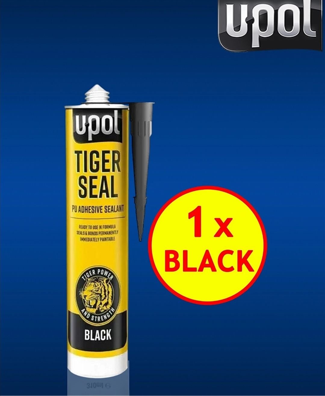

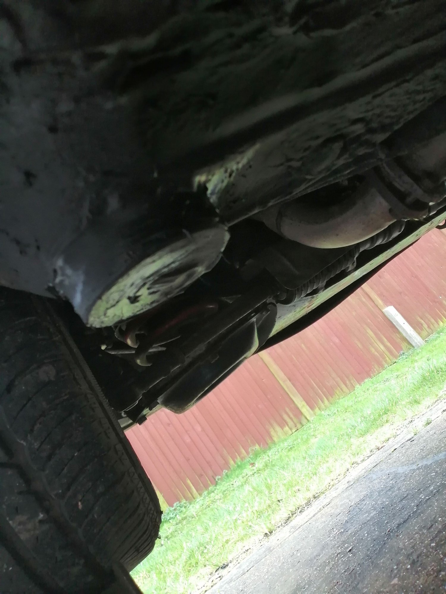

I'm Fed up with tyre shops auto box specialists and mot testers jacking up the car and destorting the jack point protruding bit. So I bonded a Puck to them with tiger seal 😊😊😊

A good idea!
With the late Convertibles using cross-braces that are attached to the jacking points, I couldn't bond anything permanently there, so i bonded some small magnets into the top of the pucks to hold them in place for tyre fitters etc.

Both the last two post a GREAT idea! What sort of glue is Tiger seal?

I don't know, but it works 😊😊
